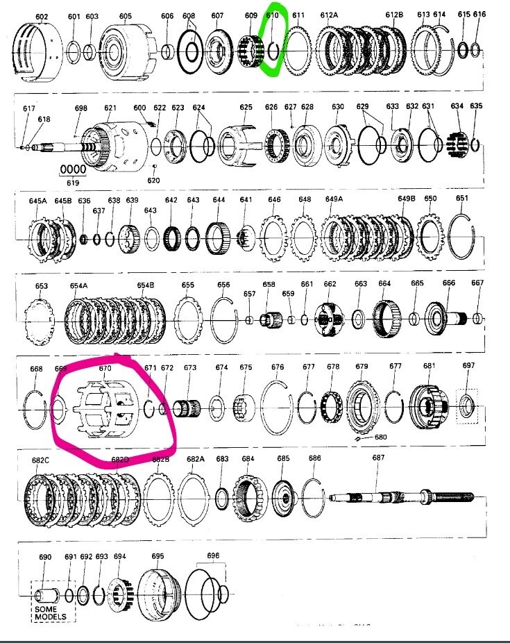

reverse quit with no warning. it kind of catches but it weak. temporary fixes that have worked for y'all, can't afford to replace rebuild at the moment, this my only vehicle. thanks in advance.

There really are no temporary fixes for that problem. That trans really has only 2 items that routinely stop reverse. The first is the sun shell (red) failing, however with that failure you also lose second and fourth gears along with reverse. The other that takes out only reverse is the reverse drum snap ring (green) failing. That can allow the symptom you have where it simply stops working and sometimes acts like it wants to engage. That is because the reverse piston will keep expanding under pressure but then it ruptures the seal, and the pressure drops, and reverse doesn't work. In both cases the only repair is to remove the transmission and take it apart to repair the parts.
Being a 2WD and the mileage you state I would actually say that a remanufactured of that unit would be good. If you have the tools, it could be rebuilt over a weekend, but you still need the parts.
You might be able to grab a used transmission from a place like a pick and pull for a temporary unit while your other one is rebuilt.
