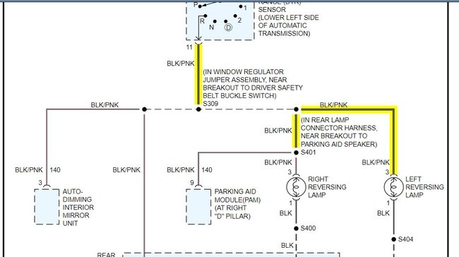

Installed a reverse backup camera need location of reverse gear signal wire

Hey, I have the vehicle listed above that I installed a reverse back up camera. All I need to know is where is the reverse gear signal wire located?

Good morning again,
I attached a wiring diagram of the back up lights for you. The black/pink wire is the wire going to the back up lights with the key on and in reverse.
