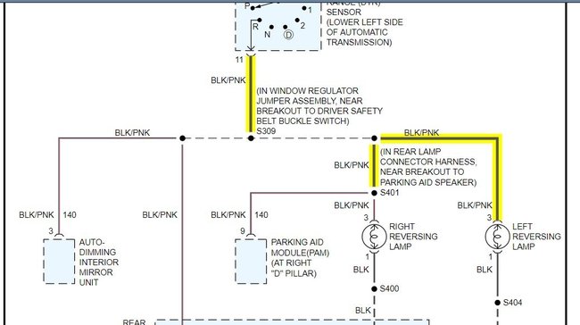

Installed a reverse backup camera need location of reverse gear signal wire
2004 FORD EXPLORER
170,000 MILES
TONY02
  • 86 POSTS
Hey, I have the vehicle listed above that I installed a reverse back up camera. All I need to know is where is the reverse gear signal wire located?
May 29, 2020 at 5:39 AM
Good morning again,

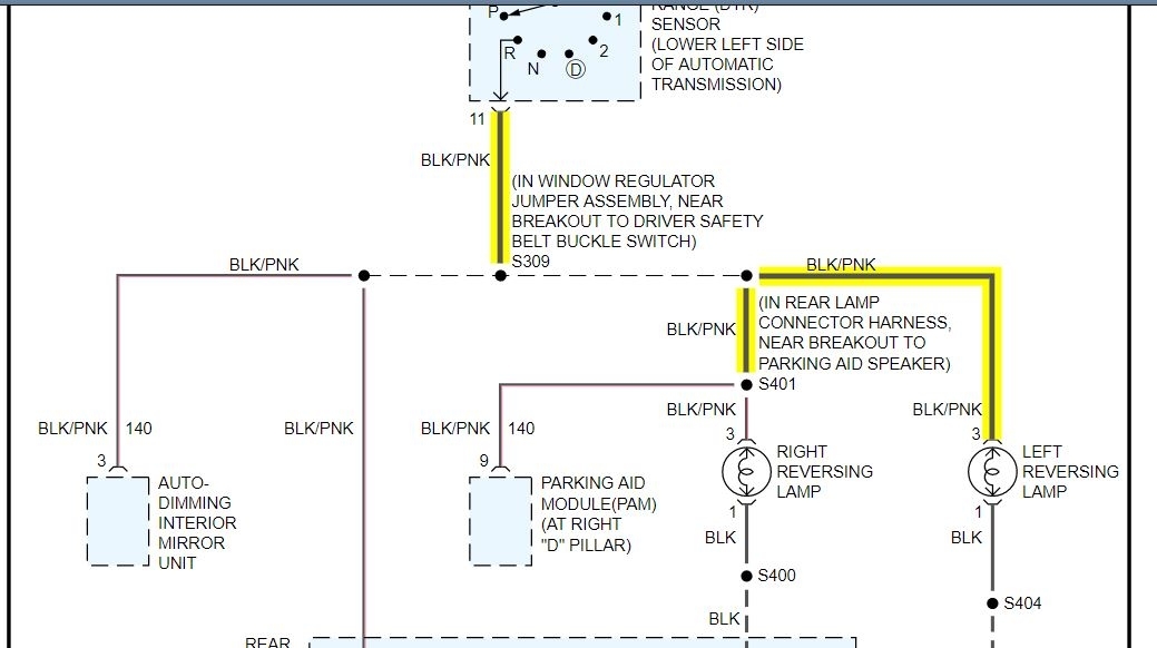

I attached a wiring diagram of the back up lights for you. The black/pink wire is the wire going to the back up lights with the key on and in reverse.
