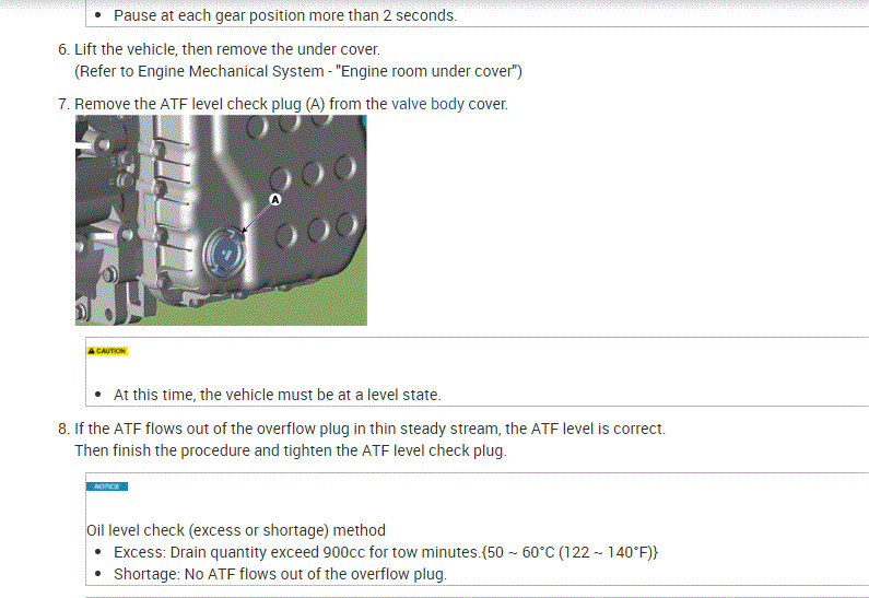

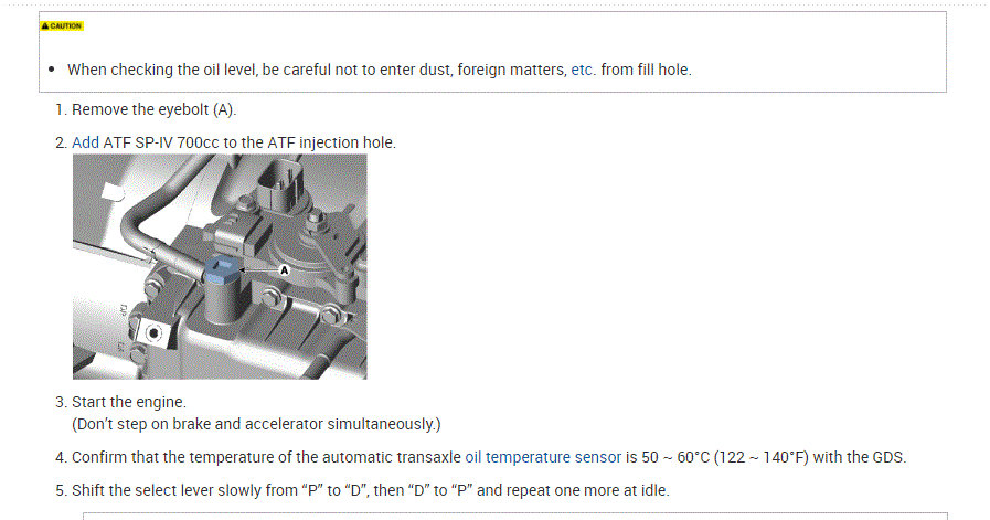

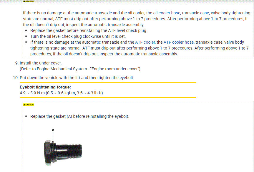

my car won't go into reverse and when I pull off it's slow at first then gains speed. but when going into 2 it's slow then speeds up.
Sep 8, 2020 at 6:49 PM
Experienced Mechanic
52,796 POSTS
Good morning,
Did you check the fluid level? I would start there.
Beyond that, when was the last time you change the fluid? It is a once a year service.
I attached the procedure for checking the fluid and changing the fluid for you.
