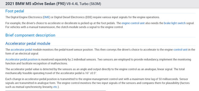

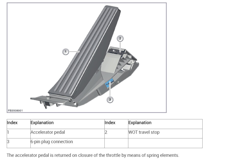

Hi. There is a BMW m5 that i got which revs up without gas input. How can i fix that?
Thanks Josh
Feb 16, 2023 at 4:29 PM
  • 55,423 POSTS
Hello Josh,
The first thing we need to do is scan the car for codes. I would do a CAN scan which is easy and you can get a CAN scanner (Controller Area Network) from Amazon.
https://youtu.be/u-4syLc-ifQ
and

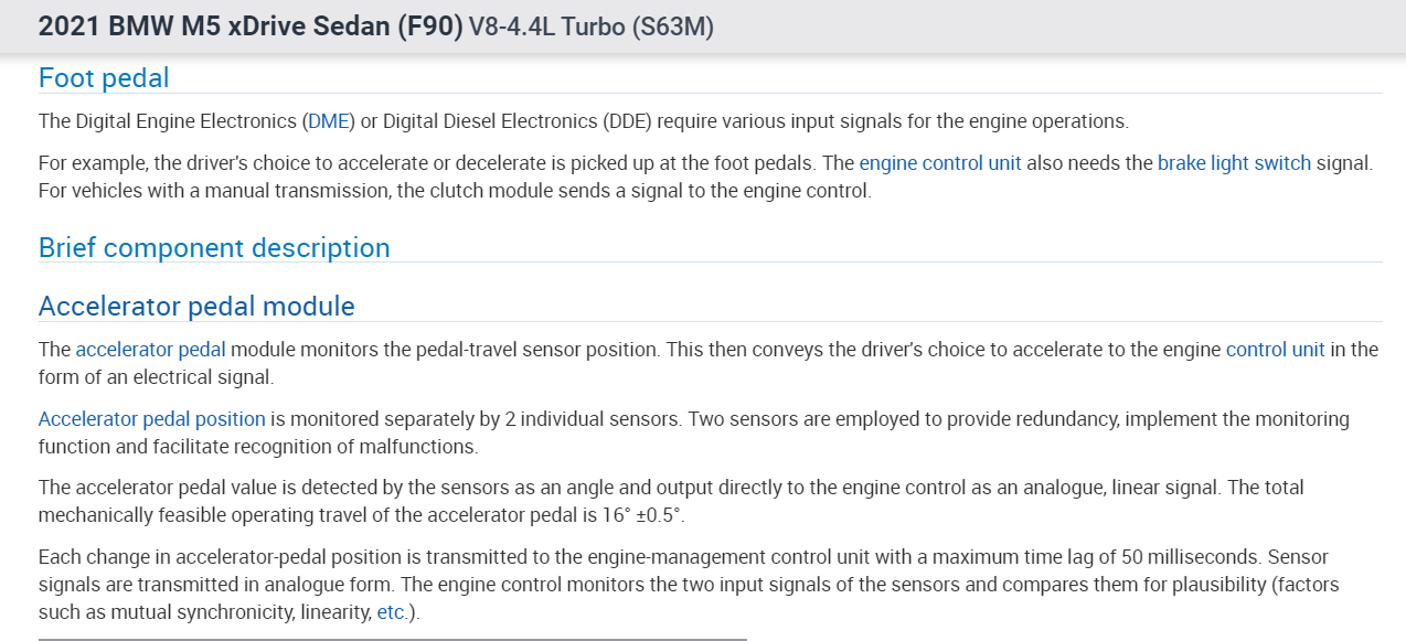

Also, can you please check the floormat to see if it is holding the throttle pedal down slightly? You may have a throttle pedal position sensor that has gone out, but I am hoping a code will come back for it, also has this can had any water damage? Here is the throttle pedal and sensor in the images below, if it gets wet it will malfunction. Please run the codes and get back to me.
