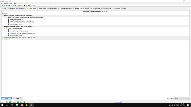

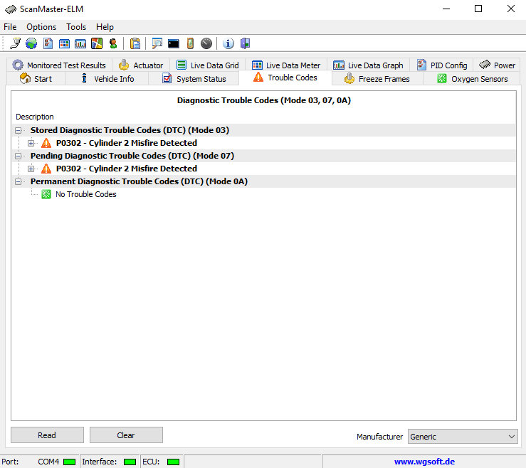

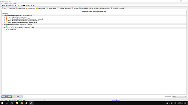

Hello. I have the car listed above with 16v with petrol engine. I bought it in October, and i had a check engine light. Went to service, it gave me P0402, EGR excessive flow and P0302 cylinder two misfire. I changed the spark plugs obviously when i bought the car, ignition coil in December and EGR valve one week ago, both new ones, and two days ago the check engine light was back. I put it on a tester, and same trouble codes. Also i got a rough idle (600 rpm), sometimes it drops even to 400 rpm when the engine is already warm, and saves from cutting off, pushing up to 1000-1200 for a second. There are no other trouble codes, besides once i got P0171 System too lean, but when it got removed it, never reappeared. What could be the problem? (On the right bottom corner you can see the dates, when the trouble codes occurred. One is with the sensor code as well, that is when we tried how the car works without EGR valve on).
Jan 20, 2017 at 6:18 PM
STEVE W.
  • 15,404 POSTS
A partly clogged converter could cause the excess EGR flow and the lean condition as well as the misfire. Run an exhaust back pressure test and look at the O2 sensors to see if this is the case.

P0402 EGR excessive flow, P0302 Cylinder 2 misfire, and sometimes P0171 System too lean. If you meant the other 5digit code (or maybe im wrong and not 5digit) before them, sadly now i cant check it, and with my simple OBD2 cable its not appearing. The big RPM drops seemed to be gone after EGR adaption, but its still not a stable idle, moving between 650-750, and maybe the exhaust sputtering causes the car to tremor.

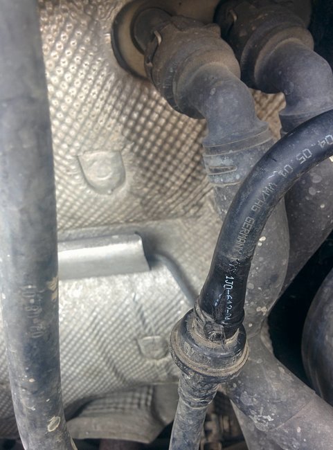

SZáVó ZSOLTI
  • 24 POSTS

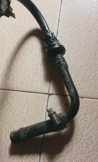

So this is the leak, i tried fixing it, i dont know if it worked or not. Something what i've noticed, when the AC is off, RPM is around 600, exhaust sputtering, rough idle, but when its on, RPM is around 800, no exhaust sputter, relatively ok idle. https://youtu.be/KGE299_Lz6I Here is the video to prove. What can cause this? I've called today 3 different servicemans, none of them had an idea why is this.

SATURNTECH9
  • 30,869 POSTS
If there is a barb on each end of that hose under the hard plastic line you can replace the hard plastic line with a rubber hose.Also again a vacuum leak could be causing all those issues start by fixing that vacuum leak.You might just have to get a new hard plastic line.

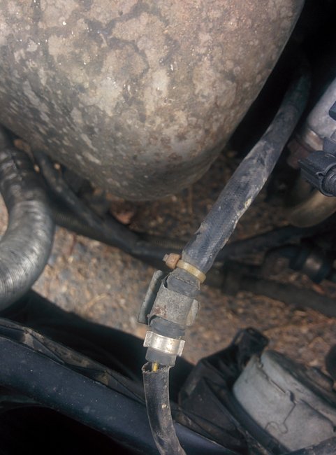

SZáVó ZSOLTI
  • 24 POSTS
Today that hose has been fixed, and this time i've been to another serviceman. I'm adding the image of the old hose, its awkward its fixed in 3 places.. So back to the problem, while the other guy said both of the O2 sensors are allright, this serviceman noticed the first O2 sensor might be faulty, because its value is oscillating around 0.43V and 0.48V meanwhile the second has the good values, moving between 0.1V and 0.9V. I've seen on internet, when the mixture is good, its on 0.45V, and going up/down correcting the mixture. I would ask it, is it really faulty? While he tested it, he got the System too lean (Bank 1) fault code aswell. Can this be the cause of the relatively high idle consumption aswell?

SATURNTECH9
  • 30,869 POSTS
That's electrical tap on the hose is not a good fix for the vacuum leak I didn't look at the picture before my last reply your probably best just replacing that hose you can probably find one on eBay.Also the readings not moving sounds like your talking about the sensor down by the cat.Unplug the top sensor and see how that effects the readings?Because it makes a lot more sense that one not moving much is the bottom one.

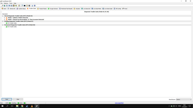

SZáVó ZSOLTI
  • 24 POSTS

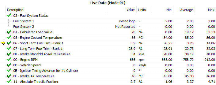

That hose (which i added the image about) was changed with a new one, but i've seen something interesting yesterday, the short and long fuel trims (Image attached). By the way i've already ordered the Bank1 O2 sensor, i got it for only ~28 dollars, for a try to fix the problem its not a big investment (compared to injectors and EGR valve). Its possible i have a bad O2 sensor, AND still atleast one more vacuum leak? Also i've seen on the internet, an absolutely dirty air filter also can cause the rough idle stuff, tomorrow i'm going to check it aswell (as far as i know it hadnt been checked when we bought the car, half year ago).

SATURNTECH9
  • 30,869 POSTS
Or the o2 sensor is just picking up the lean condition and reading lean.

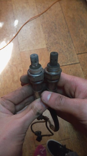

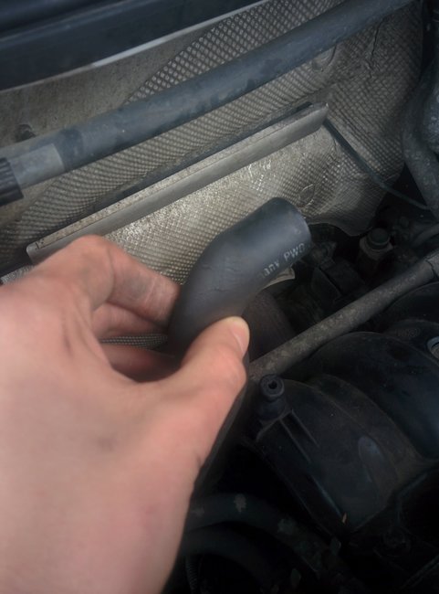

SZáVó ZSOLTI
  • 24 POSTS
The first picture is the cable of the current bank1 o2 sensor, the second the pipe from the plastic label, air filter. I hear a hissing sound, probably from that pipe, that can effect the air-fuel ratio? I will try taping it, to see if it makes the temporary fix.

SATURNTECH9
  • 30,869 POSTS
Again any un metered air/vacuum leak will set a lean code and can effect the way it runs.Taping the hose isn't the way to fix it.

SZáVó ZSOLTI
  • 24 POSTS
I've seen on the internet i can do a smoke test with cigar/vape. I'd ask it, which hose should i blow into? Also i installed the other O2 sensor (on the picture the left one is the old one), i got good values with it in voltage, also the short and long term fuel trims are good, but the exhaust is still sputtering, and the idle is relatively rough, but feels a bit better now. Does it have an adaption time? I've heard something like that it has to adapt to the new sensor.
