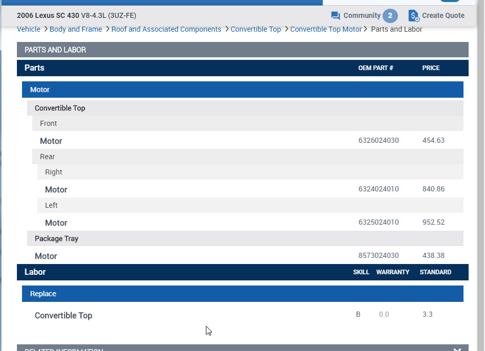

I had my vehicle to the Lexus dealer and the report said the left side (driver) top motor for the top is worn out and it would cost $7,000.00 to repair. It has been nine months and I have had the top up and own numerous times with no issues. The part they say needs replaced sells for $300.00 to $400.00 but I am not sure of the labor cost! What are your thoughts? vehicle has been great with no major issues!
Sep 30, 2020 at 6:58 AM
I would recommend getting a second or even third opinion. I attached the parts cost and labor times. It only pays around 3.3 hours. So if there labor time is around $100.00 per hour that would be less then $400.00 after fees and tax.
Clearly there is a disconnect between the price they gave you and what I am seeing. If you want to post their estimate, I am happy to review it because I am sure we are missing something because I have seen some dealers/shops overcharge but not by this much.
A second or third opinion and letting us see the estimate may help figure this out. Thanks

Thank you for your prompt response, they gave me a copy of the Lexus service report which I am attaching for your info. It is mentioned as a "Caution" item on page 8 of the colored part of the report. I simply told them "no thanks" since it sounded absurd to me. I have owned 4 BMW's previously and I did have some warranty work on a 740 series but it was in the $3,000.00 range and the warranty covered it all since it was a manufacturer defect! I tried to attach a copy of the report but it tells me it is not allowed, looks like I can only add an image or video. Thanks!

Thank you! No, the top actually works fine and it has never not worked. I had just asked the dealer a question about it being more flush on the right side after it opens and closes than on the left. So I asked what adjustment could be made and I think they called the warranty company thinking they would get more warranty work but was told by them the warranty does not cover convertible/hard top operations!
Oct 1, 2020 at 2:09 AM
Oh. I understand. Then clearly I would not pay to repair that. If the warranty company doesn't cover it and it works then I would leave it alone. The only other thing I would suggest is going ahead with another opinion just because that sounds like an adjustment issue not a motor issue.
Is there a chance you can get a video of what it does so that would help us determine other possible causes for when someone else looks at it if you chose to do that?
