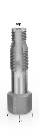

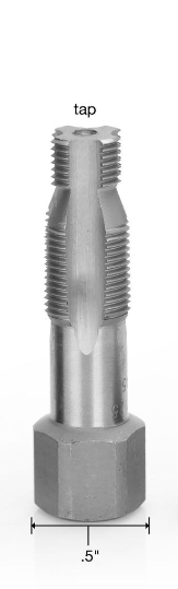

i have a rethreading tool stuck in my spark plug hole. i am a woman and i am willing to try anything, i just ask that you please explain to me carefully what to do. I've tried everything on YouTube, from PCV pipe, to JB weld, to grinding a drive down to try to make it fit the hole, I've tried magnets and it will not budge.. please help.

What's stuck in the hole is the rethreading tool . When the spark plug and coil blew out I let the car sit , then went and got a new plug and new coil. Thing to get the spark plug screwed in for about 20 minutes I realized the hole must be stripped or cross threaded. I went and got the kit. Dropped the piece down there but didn't realize the socket that fit on too of it was too big to go down the hole. As soon as I seen that I instantly got my magnet . It didn't budge and hasn't since. I almost have a 21 mm socket grinded down just enough to go down and possibly screw it back out.. which is my last resort unless you guys have a better idea.

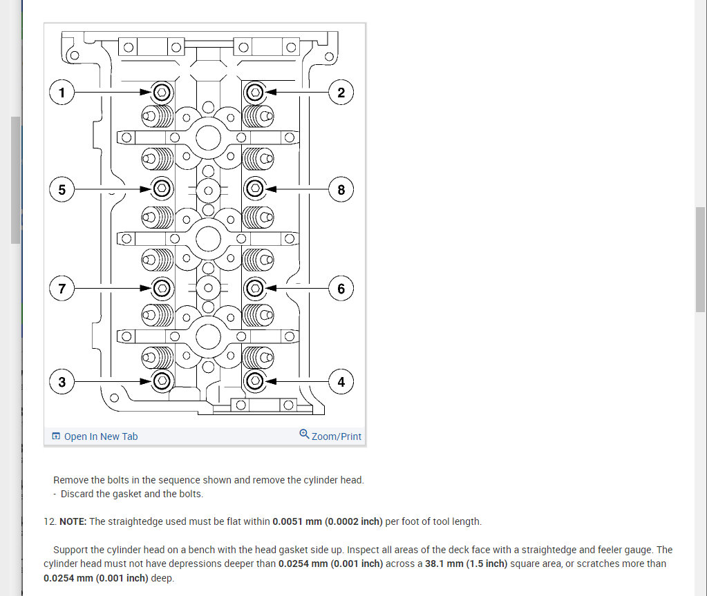

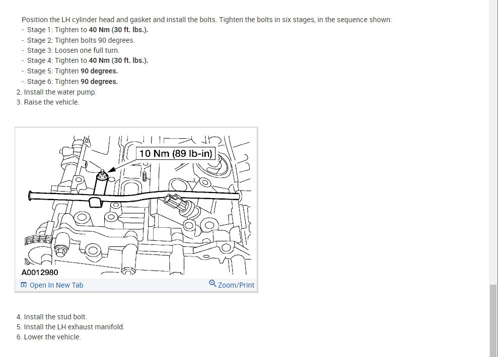

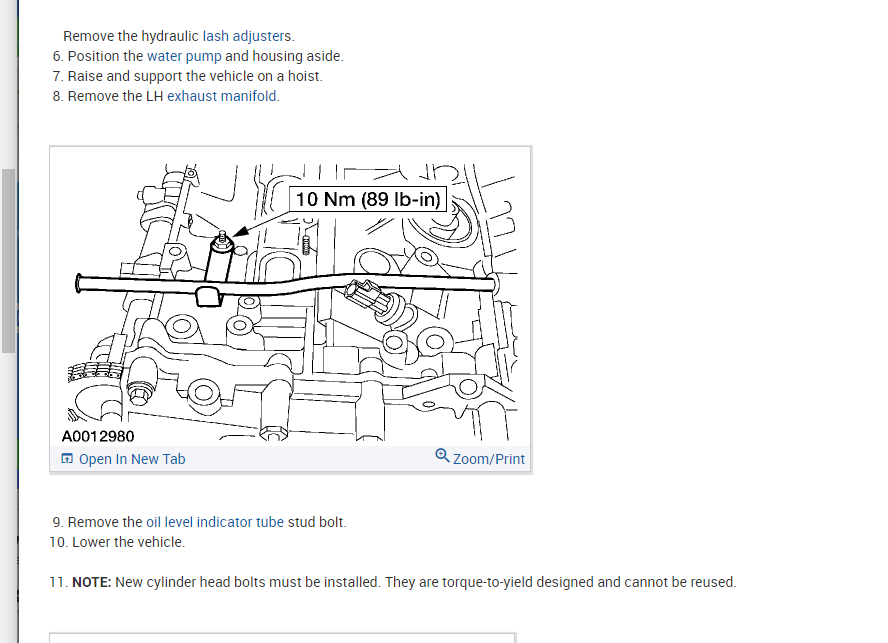

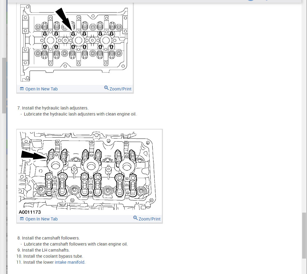

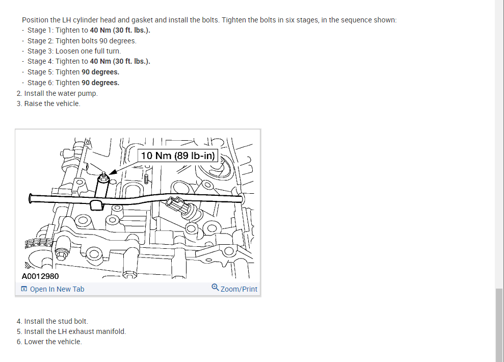

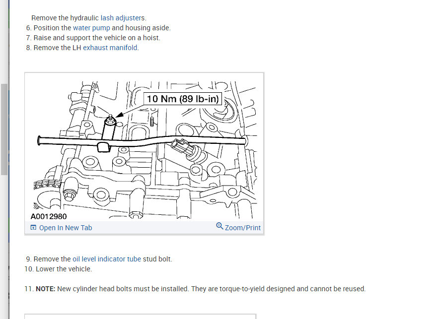

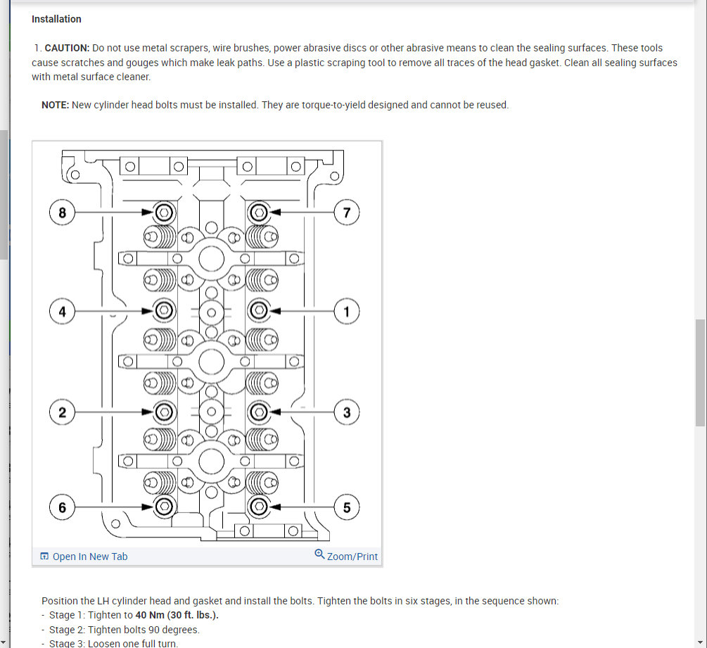

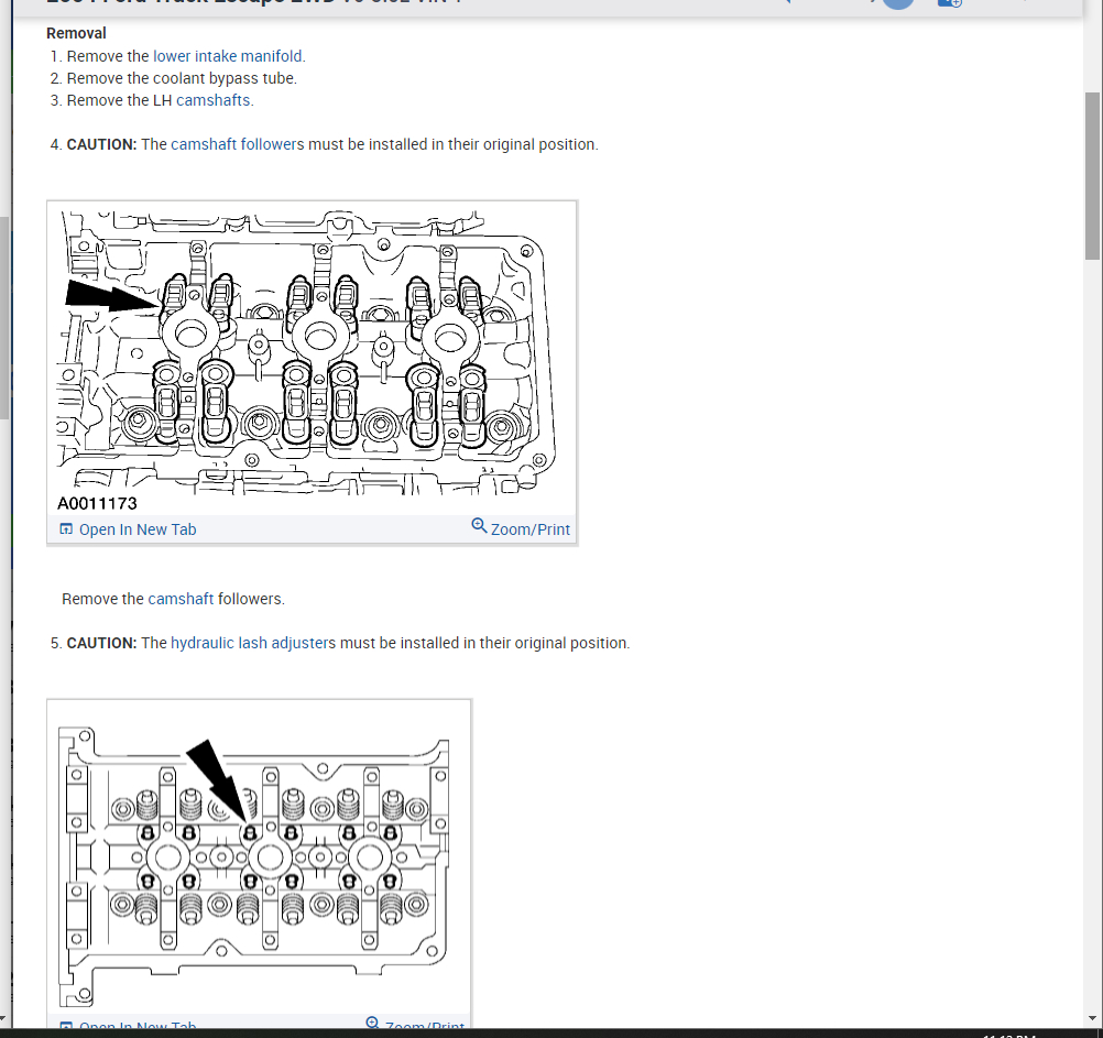

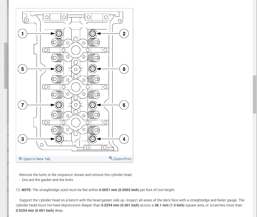

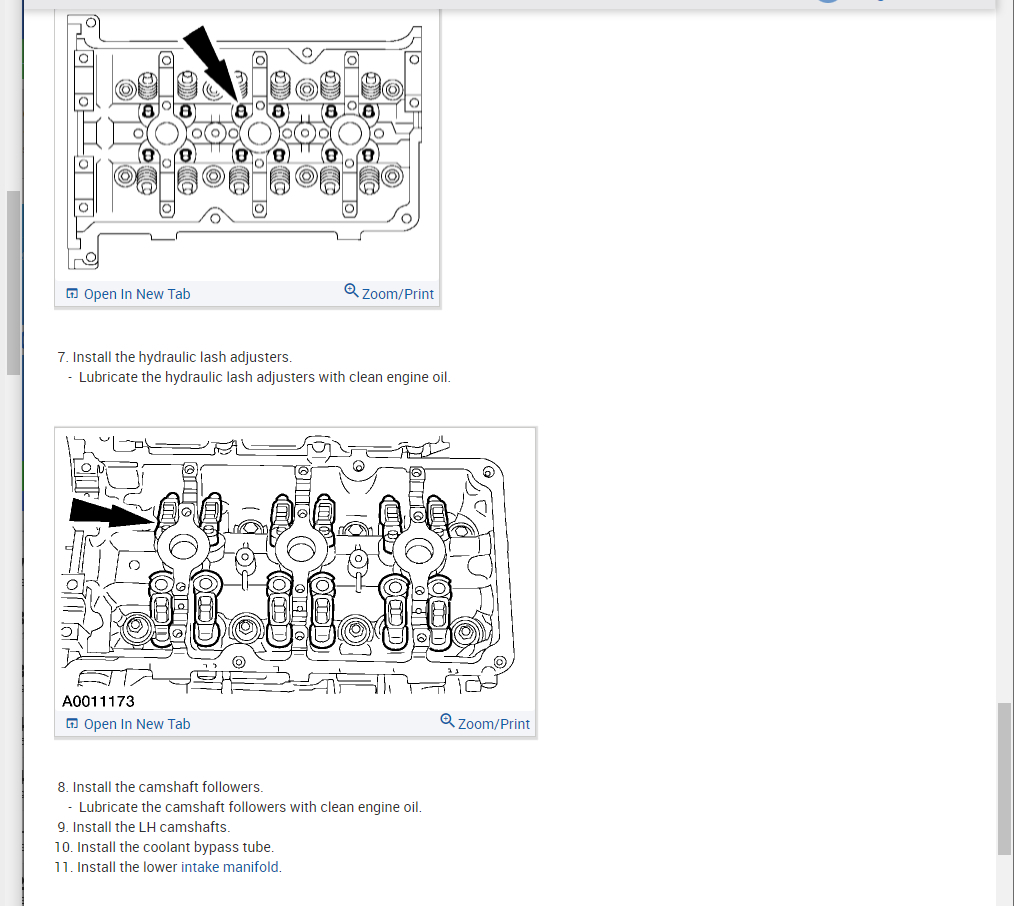

Okay. I understand. Unfortunately that is a tough situation. However, just thinking ahead. Even if you get it out what is the repair going to be?
More than likely the head is going to have to be removed at this point. When you tried to cut the new threads, did you coat the tap in grease? If not then any shavings that were cut are now down in the engine.
If it were me, I would just cut my losses at this point and remove the head, remove the tap and then evaluate the condition of the threads because you may have to replace it. Then you can clean off the top of the piston of any metal shavings.
I attached the process below for the LH head. Please let me know if you have questions on this.
Thanks
