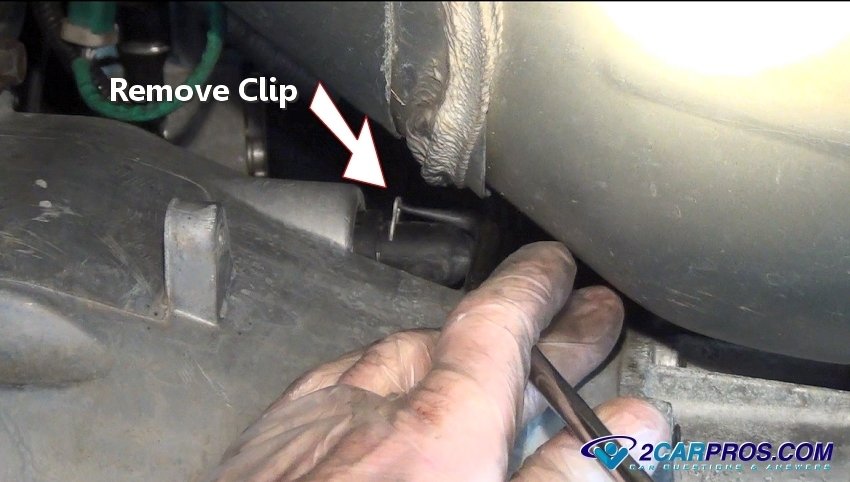

Retainer clip to the elbow of the clutch line to slave cylinder
80,000 MILES • 4.6L • V8 • 2WD • MANUAL
GDR233
What is the part number for the small metal clip that goes into the elbow for the clutch line that is pressed j to the TOB nipple to hold the elbow in place. You removed it with a pick in your video when dropping a TR3650 and when I did it fell down a drain never to be found again. I am going to assume the elbow will not stay on without a replacement. Do you have any spares I can purchase or know the part number?
Oct 25, 2017 at 4:22 AM
STEVE W.
  • 15,399 POSTS
I take it you mean the clip here? Ford sells that as an assembly with the elbow. For around $23.00. They used to sell the clips as well but those pop up "This part is discontinued. It is no longer available for purchase."
Or you can go to a VW dealer or online and order #7M0721431
Or you can go to a BMW dealer or online and order #21521165451
Same clip but runs about $5.00.

GDR233
Spot on.
Thanks Steve
