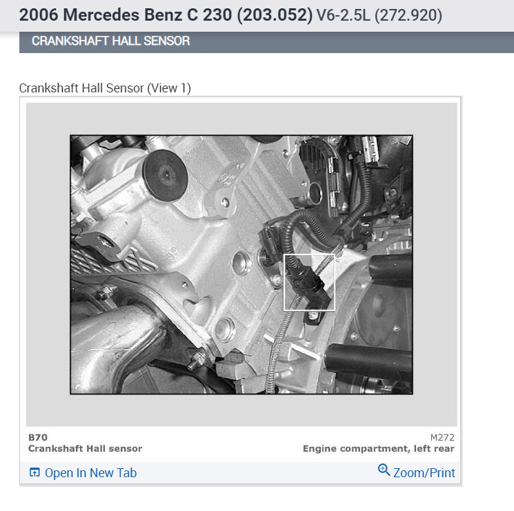

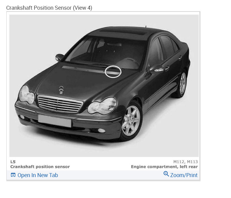

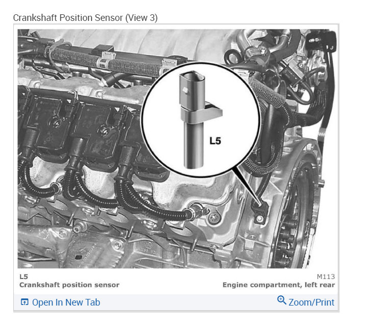

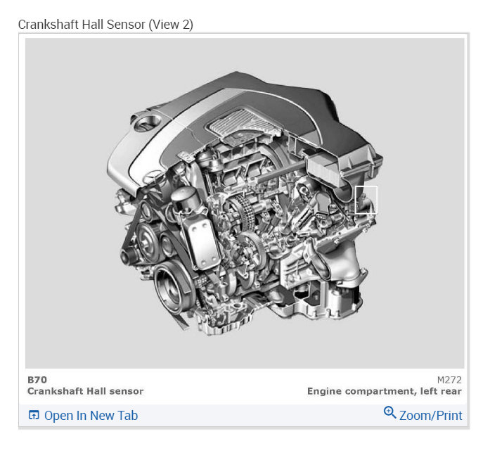

I have seen a weak crankshaft angle sensor cause this issue, but we should run the codes to see what comes up first. This guide can help you get started; also, I have left the location of the crankshaft angle sensor in the diagrams below just in case.

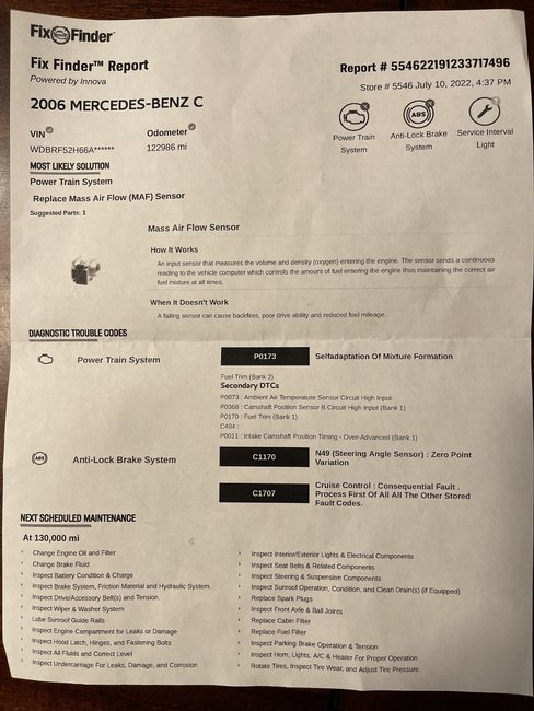

I have the paperwork from the code read yesterday.
I have ordered the mass air flow sensor. Will install tomorrow.

Does the engine crank over? If so, you can try to unplug the MAF sensor to see if it starts, if so, get a new sensor.
