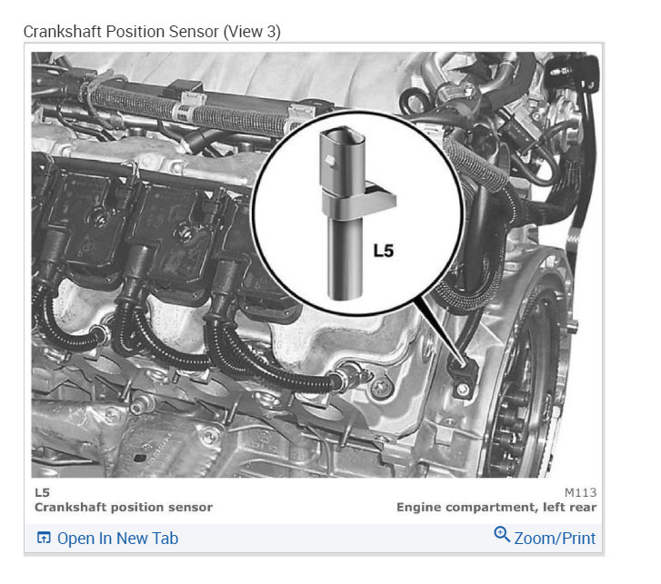

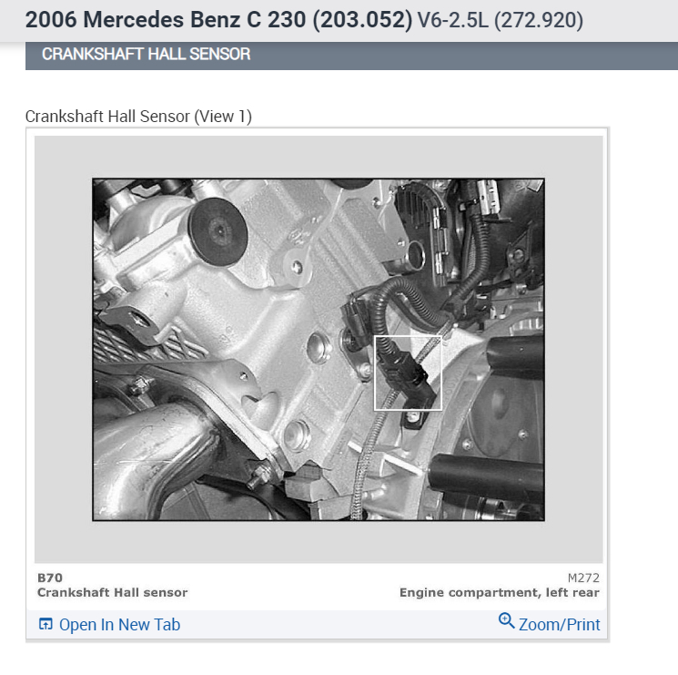

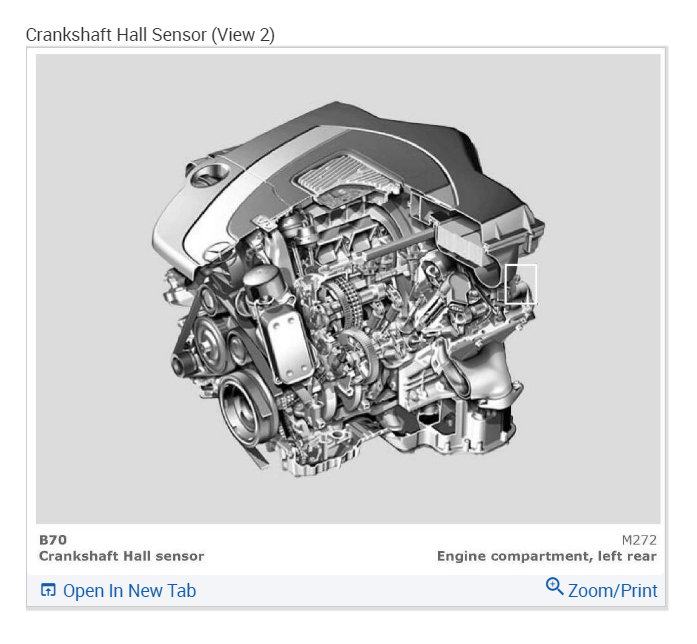

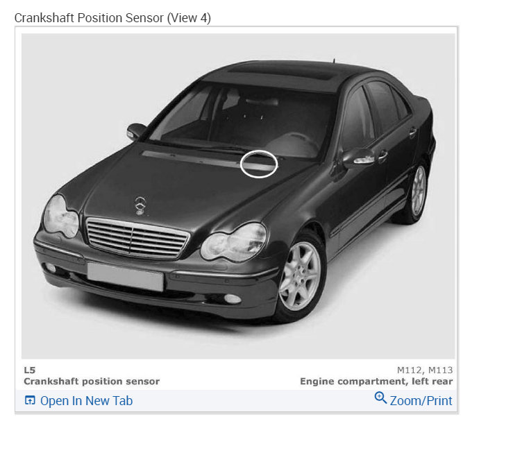

I have seen a weak crankshaft angle sensor cause this issue, but we should run the codes to see what comes up first. This guide can help you get started; also, I have left the location of the crankshaft angle sensor in the diagrams below just in case.

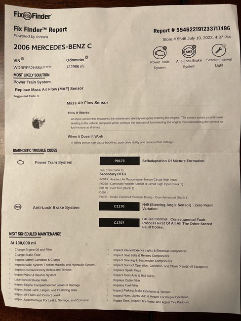

I have the paperwork from the code read yesterday.
I have ordered the mass air flow sensor. Will install tomorrow.
