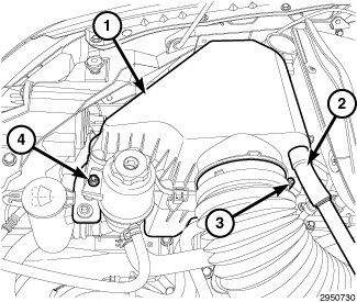

2. Remove the air cleaner body (1) See: Air Cleaner Housing > Removal and Replacement > Air Cleaner Body - Removal.

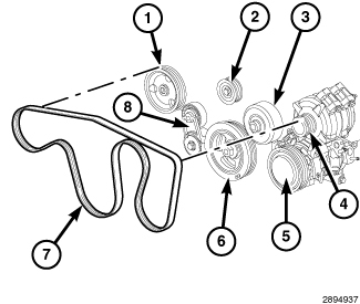

3. Remove the serpentine belt See: Drive Belt > Removal and Replacement > Serpentine Accessory Drive Belt - Removal.

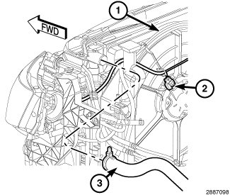

7. Remove the cooling fan (1) See: Radiator Cooling Fan > Removal and Replacement > Cooling Fan - Removal.

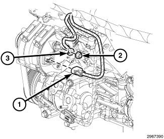

8. (see picture 4)
9. Disconnect the generator field electrical connector (1).
10. Remove the B+ retainer (2) and remove the B+ cable.

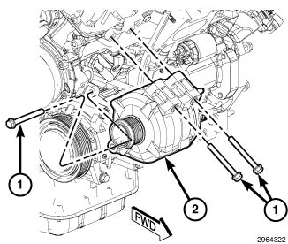

11. Remove the upper generator retainers (1).
12. Remove the generator from the vehicle.

1. Position the generator (2) to the engine and loosely install the upper and lower retainers (1).
Tighten the upper generator mounting retainers to 25 Nm (18.4 ft. lbs.).
2. Install the B+ cable (3) and retainer (2).
Tighten the B+ retainer to 13 Nm (9.5 Ft Lbs.).
3. Install the generator field connector (1).

4. Install the cooling fan (1) See: Radiator Cooling Fan > Removal and Replacement > Cooling Fan - Installation.
5. Install the air cleaner body (1) See: Air Cleaner Housing > Removal and Replacement > Air Cleaner Body - Installation.
