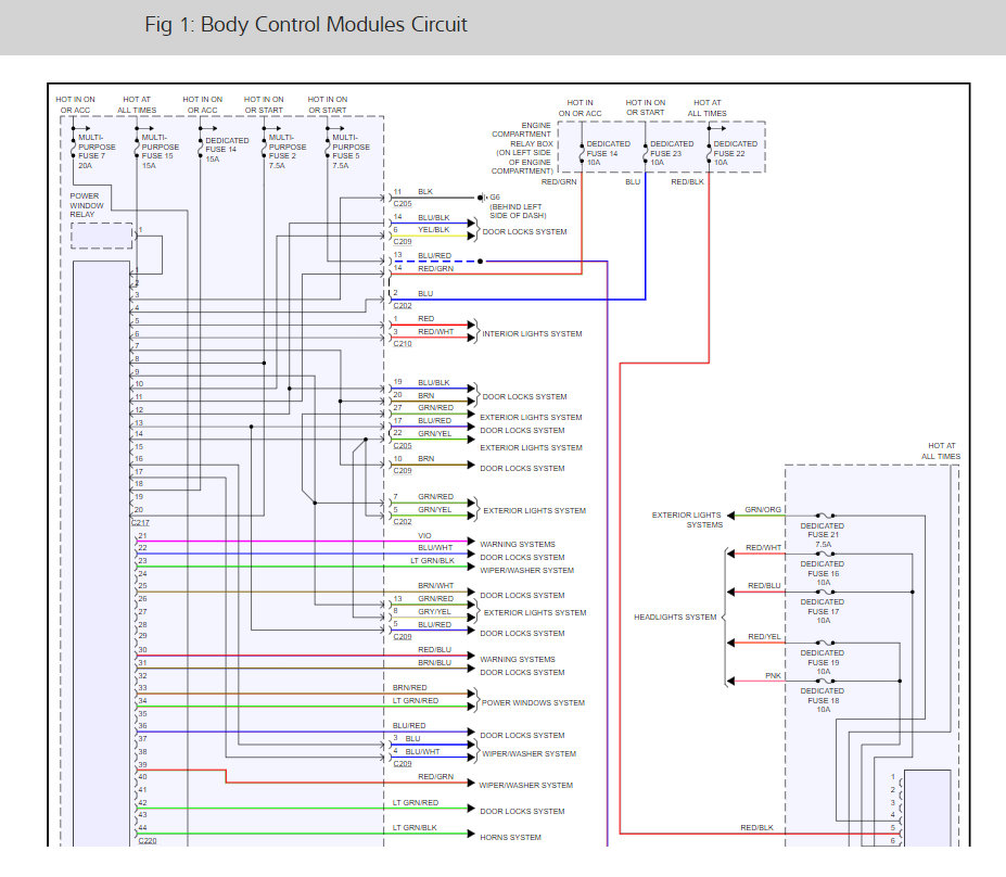

I just tried to reset my key-less remote entry immobilizer by the data link #1 ground 6 times hazardous button press and 3 press immobilizer.the doors will not activate with the anti theft system after the procedure and the on board computer will not initiate the activation.is the #1 pin location from left to right or from right to left.i have been a victim of vehicular intrusions since arriving here in Chicago.the last time I have been on the site and contacted you was in winter garden Florida.

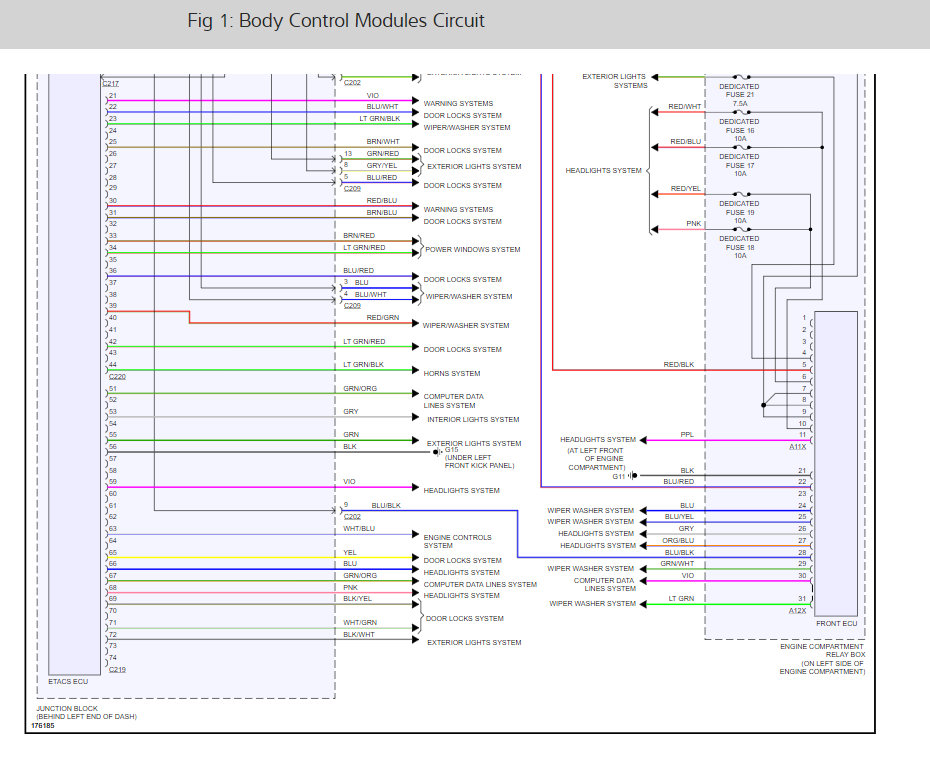

Is the security light flashing on the dash when you try to crank the engine over? Here are the security wiring diagrams so you can see how the system works and a guide to help you reset the system:
https://www.2carpros.com/articles/how-to-reset-a-security-system
Oct 1, 2019 at 5:27 AM
