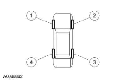

I recently bought the car listed above SE model. The tire pressure sensor warning light is on.
Can you send me the instructions to reset the sensors?

The directions for relearning the TPMS sensors requires special tooling. However, here are the directions. Please keep in mind that each sensor has a battery. They last about five years before they start to go bad. You may have a dead battery in one of the sensors. Again, a TPMS tool/scanner needs used to determine if that is the case.
Here are the directions. The two attached pictures correlate with these directions.

1. Turn the ignition switch to the OFF position, then press and release the brake pedal.
2. Cycle the ignition switch from the OFF position to the RUN position 3 times, ending in the RUN position.
3. Press and release the brake pedal.
4. Turn the ignition switch to the OFF position.
5. Turn the ignition switch from the OFF position to the RUN position 3 times, ending in the RUN position.
- The horn will sound once and the TPMS indicator will flash if the training mode has been entered successfully. If equipped, the message center will display TRAIN LF TIRE.
6. NOTE: It may take up to 6 seconds to activate a tire pressure sensor. During this time, the Tire Pressure Monitor Activation Tool must remain in place at the valve stem.
Place the Tire Pressure Monitor Activation Tool on the LF tire sidewall at the valve stem. Press and release the test button on the Tire Pressure Monitor Activation Tool. The horn will sound briefly to indicate that the tire pressure sensor has been recognized by the SJB.
7. Within 2 minutes of the horn sounding, place the Tire Pressure Monitor Activation Tool on the RF tire sidewall at the valve stem and press and release the test button to train the RF tire pressure sensor.
8. NOTE: Do not wait more than 2 minutes between training each sensor or the SJB will time out and the entire procedure must be repeated.
Repeat Step 7 for the RR and LR tires.
The procedure is completed after the last tire has been trained. When the training procedure is complete, the message center (if equipped) will display TIRE TRAINING COMPLETE.
For vehicles not equipped with a message center, successful completion of the training procedure will be verified by turning the ignition switch to the OFF position without the horn sounding. If the horn sounds twice when the switch is turned to the OFF position, the training procedure was not successful.
