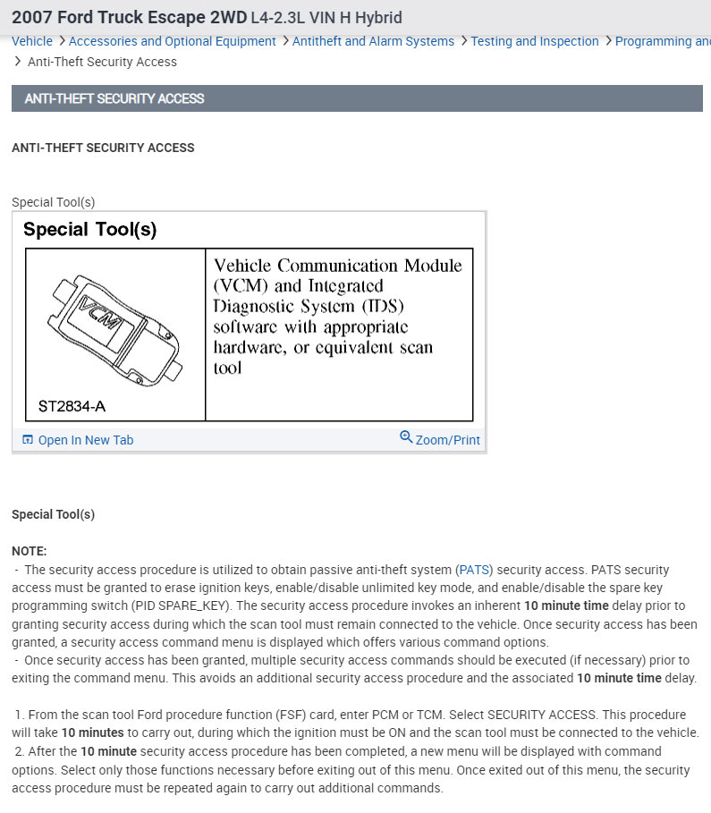

According to Ford this is the procedure:
Hold the panic button on the key fob for 2 seconds. Close all of the doors and while using the key lock and use the key to unlock the lock the driver's door. If that doesn't work remove the negative battery cable for 15 seconds and reconnect.
https://www.2carpros.com/articles/how-to-reset-a-security-system
See attached for some additional helpful information.
Let me know if you are able to reset it.

Let me know how it goes. This might require a special tool to reset, or you could have a faulty immobilizer. Which can be scanned to see what error code it is providing, that also requires special scan tool.
