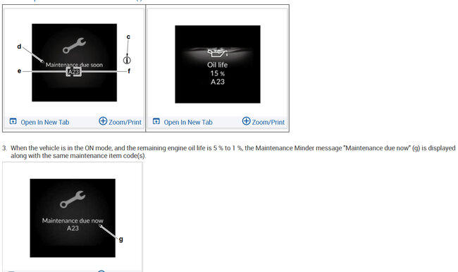

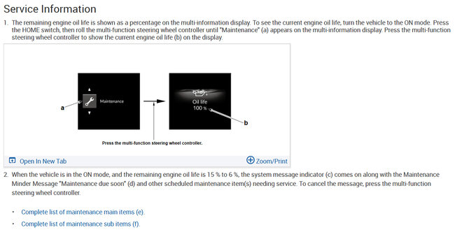

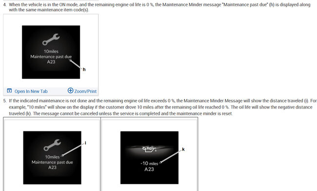

Sure, here is how to rest the engine oil change service light reminder.
Resetting the Maintenance Minder
NOTE:
The vehicle must be stopped to reset the Maintenance Minder.
If a required service is done and the Maintenance Minder is not reset, or if the Maintenance Minder is reset without doing the service, the system will not show the proper maintenance timing. This can lead to serious mechanical problems because there will be no accurate record of when the required maintenance is needed.
You can reset all maintenance items by batch, or you can select and reset each maintenance item individually on the display.
1.Turn the vehicle to the ON mode.
2.Press the HOME switch.
3.Select the "Maintenance" screen by rolling the multi-function steering wheel controller, and then press and hold the multi-function steering wheel controller for 10 seconds or more to show the reset mode.
4.If you reset all the maintenance items shown on the display "A23 (for example)", select "All due items" by rolling the multi-function steering wheel controller and press it. If you reset each maintenance item individually, select an item (complete list of maintenance main item(s) and sub item(s)) you wish to reset by rolling the multi-function steering wheel controller and press it.
NOTE:
If you are resetting the Maintenance Minder when the engine oil life is more than 15 %, make sure any maintenance item(s) requiring service are done before resetting the display.
To cancel the reset mode, toggle the multi-function steering wheel controller to the left.
Check out the images (below). Let us know if you need anything else.
