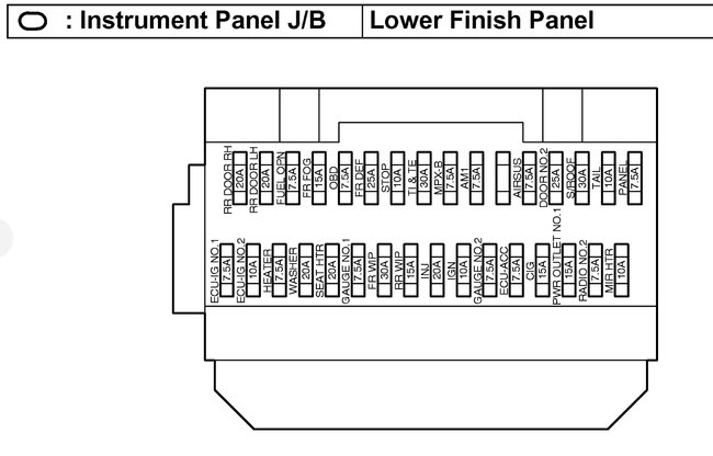

The OBD2 Port is also locked out.
I had tried plugging in the OBD2 code reader but it too is locked out.
What I mean by locked out is when you plug in the OBD2, it does not connect at all. It does not light up or read anything. It is dead.
The OBD2 Port was also affected when the Anti Theft engaged.

There is an OBD fuse in the fuse panel inside the car. here is a guide so you an check it for power:
