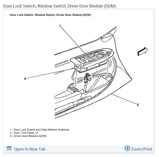

Yep, this happens when the driver's door module goes out which is common, here is the location and how to change it out in the images below. When you say you scanned the BCM did you use a CAN scanner? You can get a CAN scanner (Controller Area Network) which will work on most cars from Amazon.
https://youtu.be/u-4syLc-ifQ
The DDM is integrated into the main window switch. Check out the images (below). Please let us know what happens.

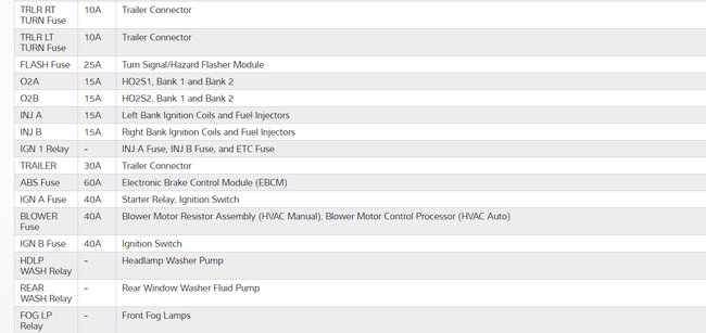

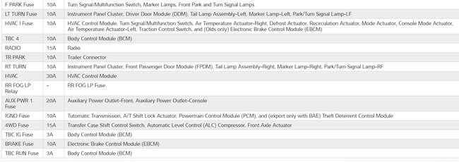

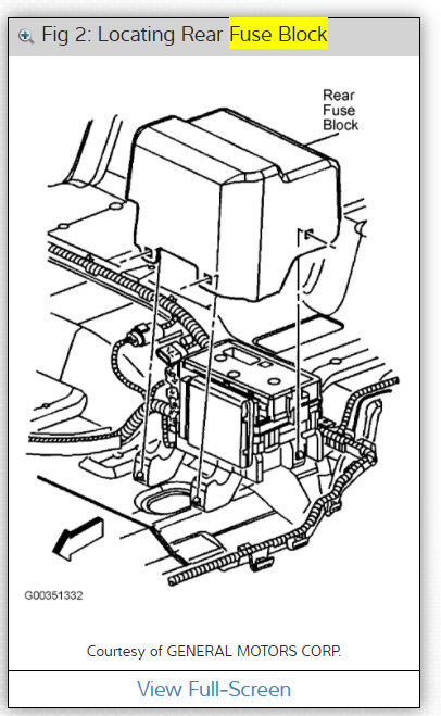

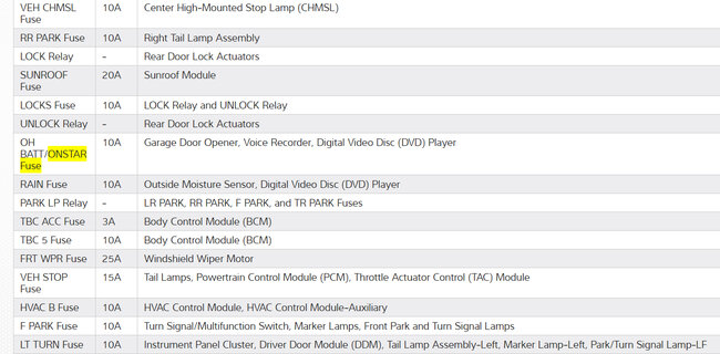

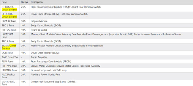

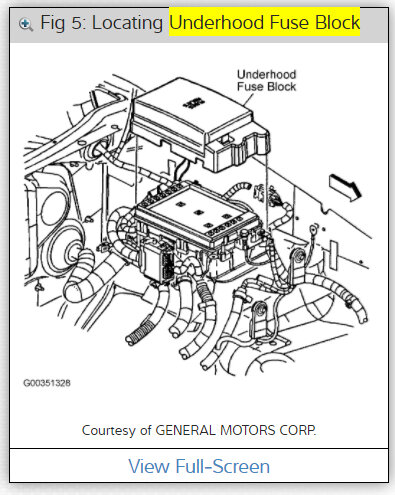

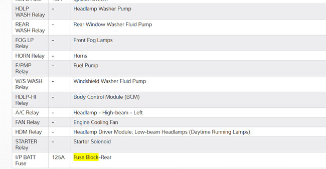

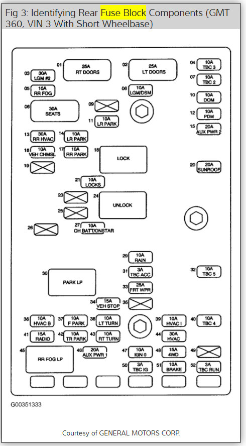

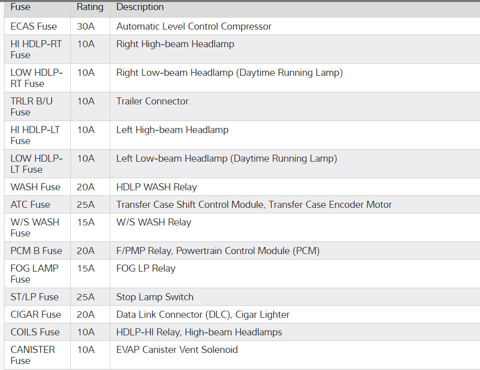

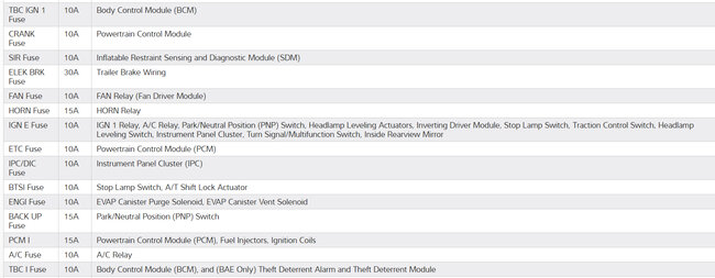

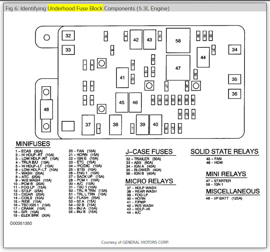

I don't think the garage door opener would do anything, is there an aftermarket remote start kit on this truck i so I would remove it and put the wiring back to stock. I am surprised that a CAN scan is not telling us more. With all systems on I would check all fuses for power. You could have a maxi fuse that has gone out which can power down many systems which makes sense that there are not more codes.
