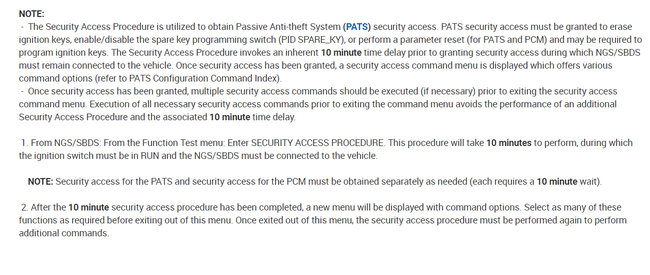

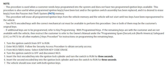

Can I replace my lock cylinder and reprogram my key the same way you explained for the 1998 Ford expedition for my 1998 Ford Explorer? I have the exact same thing happened last the keys drill it out got the lock cylinder, tumbler, and stuff out but then I lost my keys after that, so I don't have the key. so, can I do all the same things you guys explained for the Expedition?
Oct 29, 2021 at 12:20 PM
Good morning,
I attached the procedure for programming the keys for you below.
https://www.2carpros.com/articles/how-to-reset-a-security-system
I also attached the procedure for programming the security system in case you need this performed as well.
Let us know if you have any other questions.
