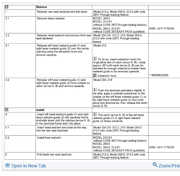

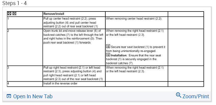

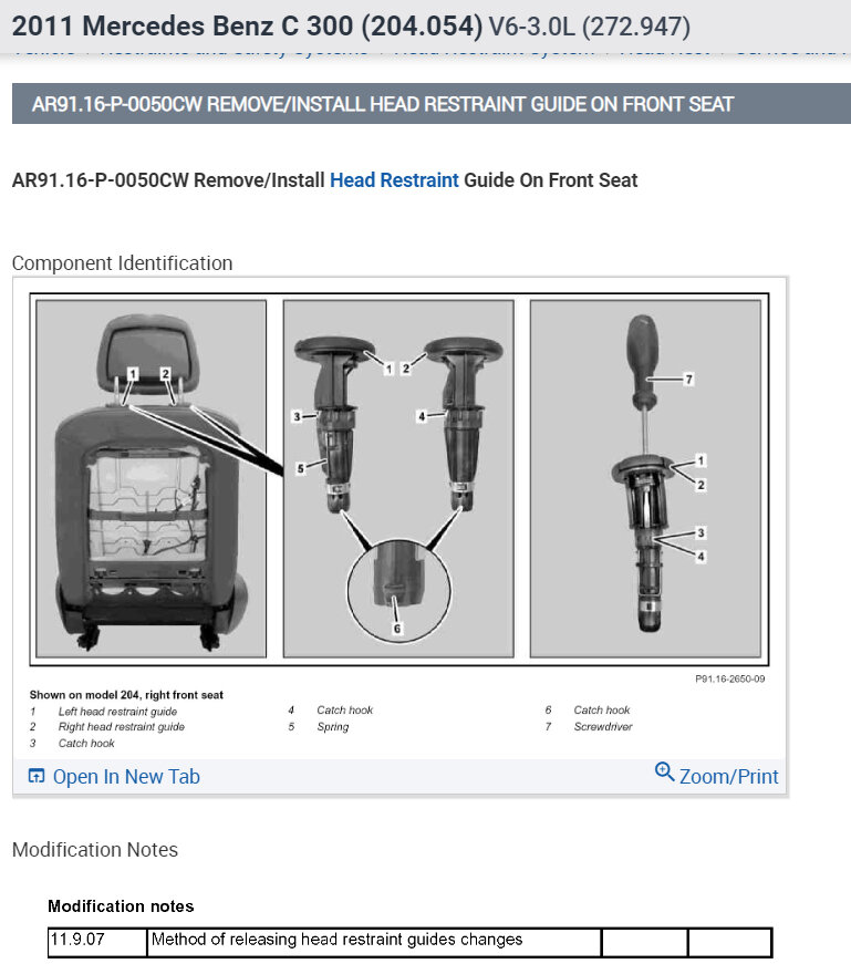

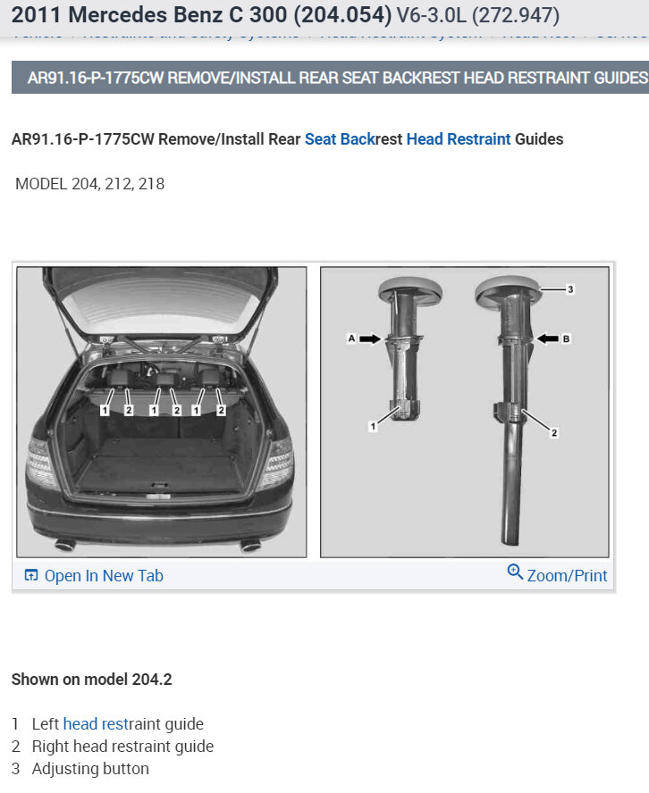

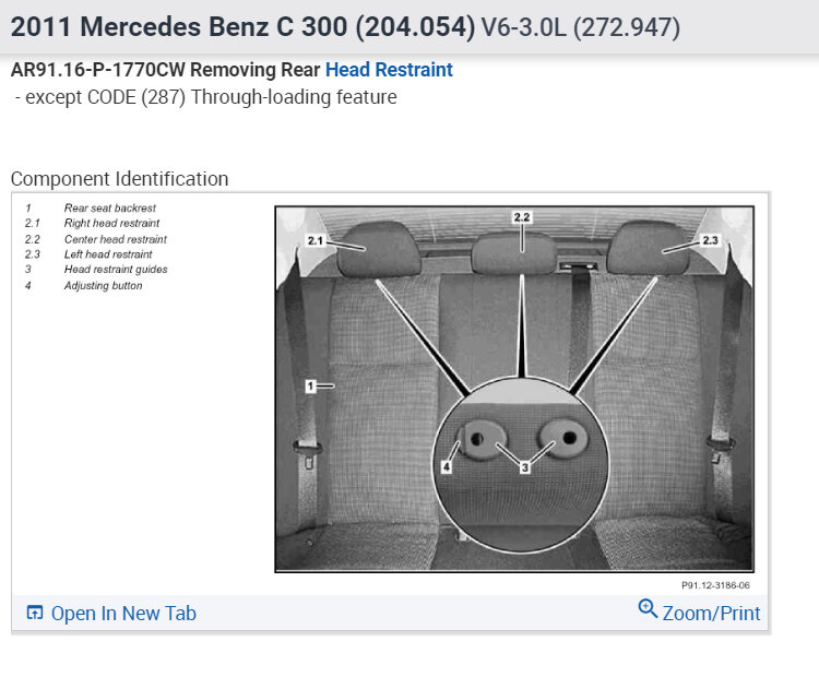

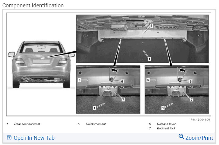

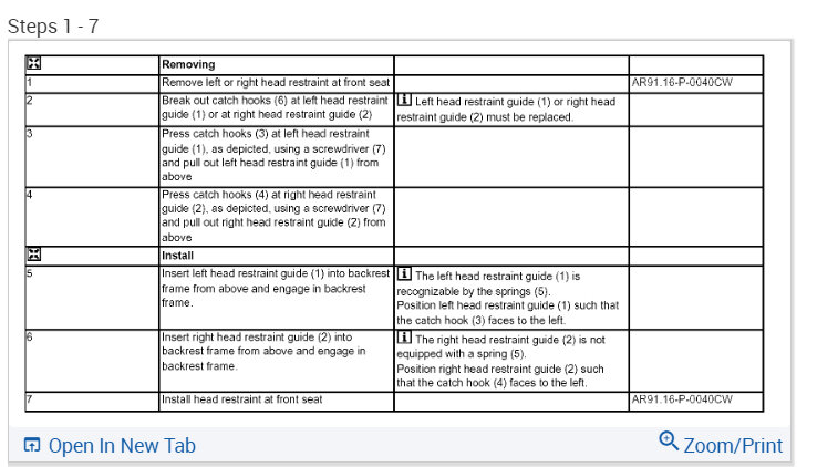

How to remove the headrest guides?
2011 MERCEDES BENZ C300
85,000 MILES • 6 CYL • 2WD • AUTOMATIC
BHAMDOC1973
  • 2,007 POSTS
Do you have any instructions on how to remove the headrest guides where the headrest goes in? for front seat?
Nov 13, 2023 at 6:20 AM
  • 55,399 POSTS

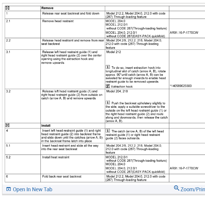

Hello again, here are the instructions on how to remove the replace the headrest guides for both the front and rear seats. Check out the images (below). Let us know if you need anything else.
