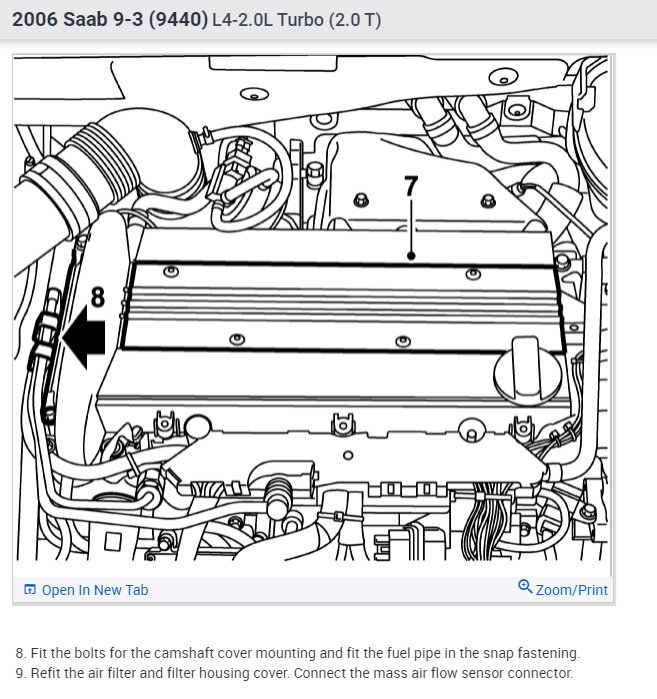

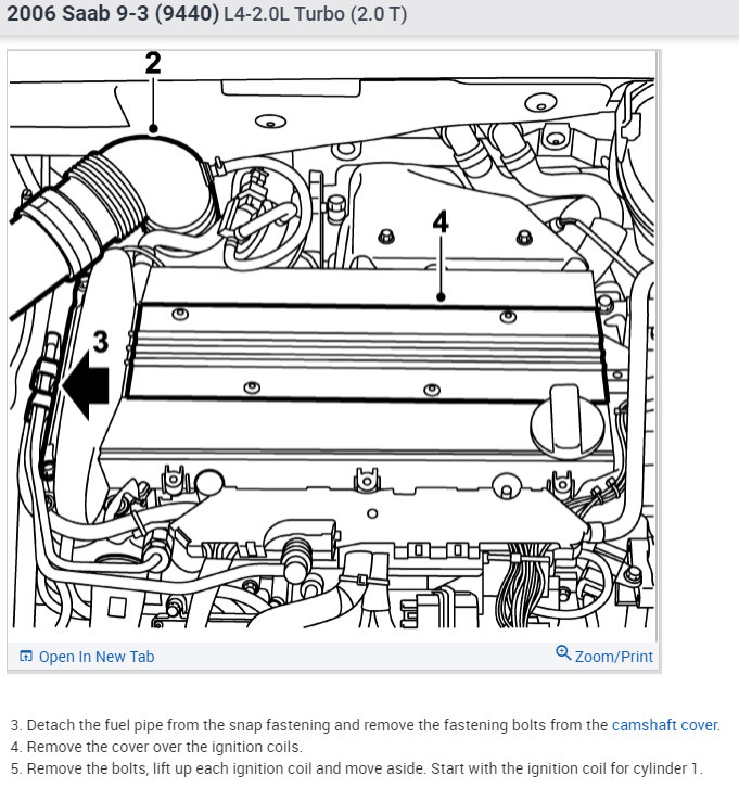

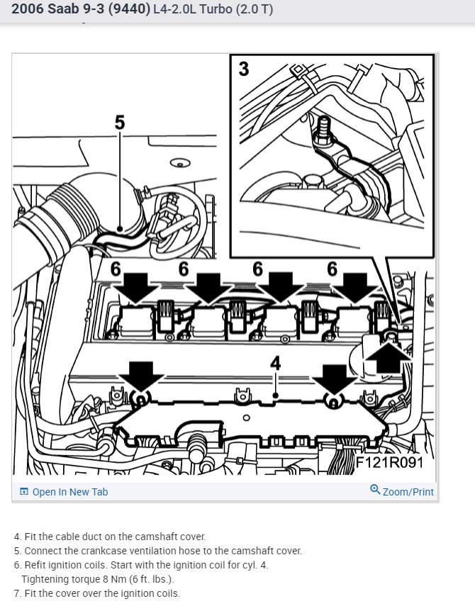

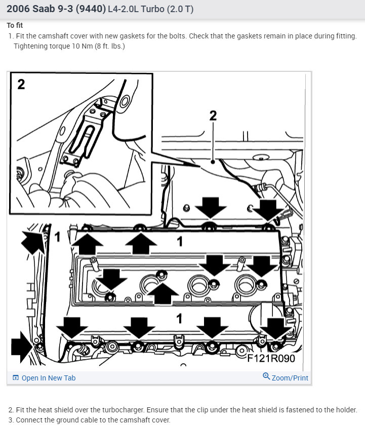

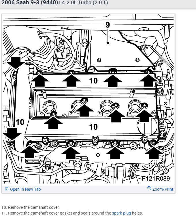

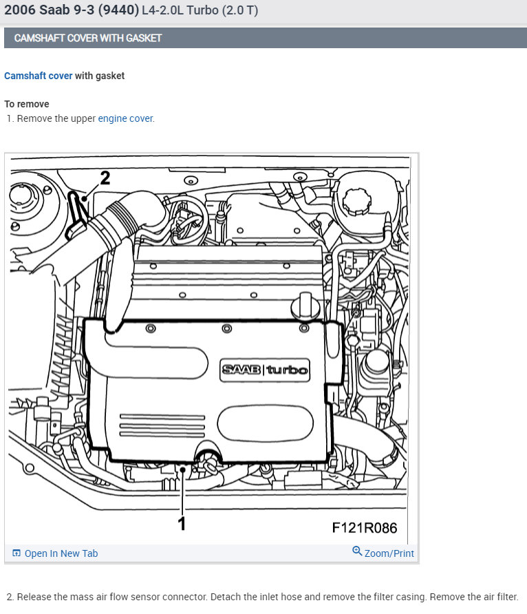

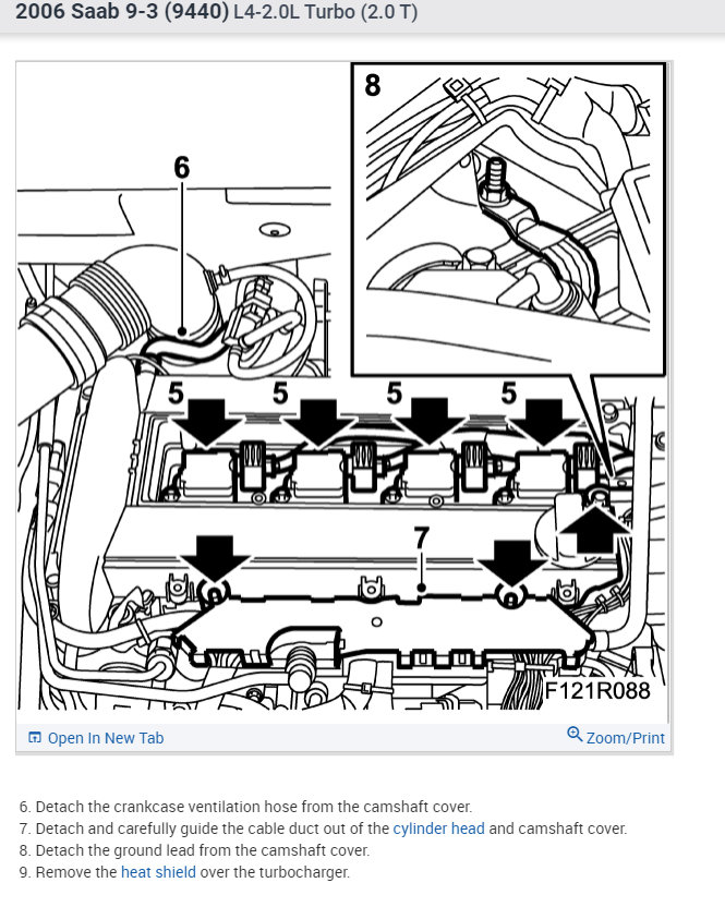

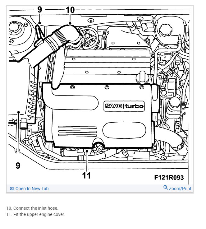

I have attached the valve cover gasket replacement procedure below. It has the torque specifications as well.
https://www.2carpros.com/articles/replace-valve-cover-gasket

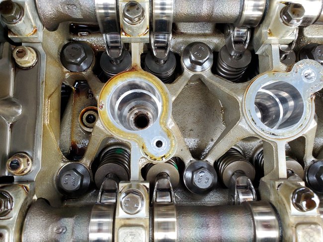

How do I clean the valve cover from the inside after removing the gaskets? Can I use brake cleaner? And how the rest of the block on the vehicle, just spray and wipe brake cleaner?
Now, when attaching the gaskets, how do I know if they are not going to slip out once I turn the cover upside down to install it.
Jan 13, 2022 at 6:50 PM
SQM
  • 6,383 POSTS
To clean the components, you want to use any type of parts cleaner or brake cleaner. If you do use a brake cleaner be sure to use only on metal surfaces.
This can be used for block as well.
If you have old gasket residue on the engine or the cover, you can use a plastic scraper to remove that.
When attaching the gasket, you can use some RTV sealant/gasket maker on a few spots on the cover to keep the gasket in place. Just use enough so the gasket does not move as you lower the cover on the engine.

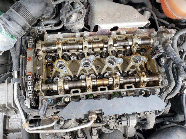

Do you think there's sludge and how should I clean it it, just with paper towels or microfiber towels?
Jan 18, 2022 at 11:11 PM
SQM
  • 6,383 POSTS
It does not look slugged up.
Just first clean with a microfiber towel. You don't want to use a paper towel as it can leave residue.
You can also spray the cleaner on the towel and clean the spark plug holes. Careful not to get any debris inside the holes.
Also be sure to give it enough time to dray from any cleaner or solvent, before putting it back together.

How about the torque settings for the spark plugs and the 12 bolts that hold the valve cover down.
Jan 19, 2022 at 3:30 AM
SQM
  • 6,383 POSTS
The valve cover torque : 8 ft. lbs.
Spark plugs : 21 ft. lbs.
Ignition Coil bolt : 15 ft. lbs.
Ignition coil cover: 6 ft. lbs.
Let me know if you need any other info.
