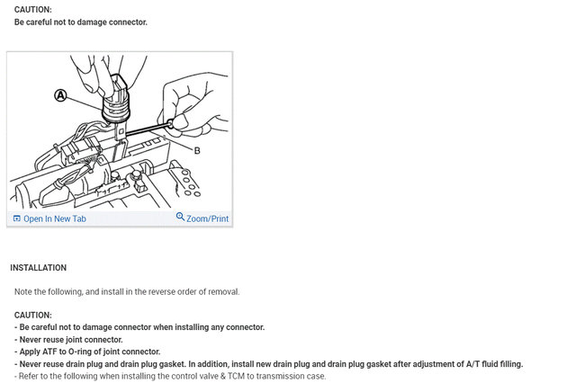

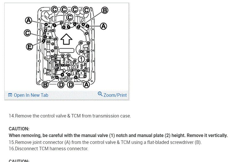

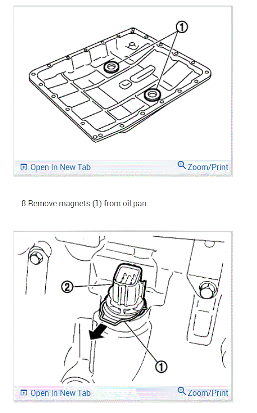

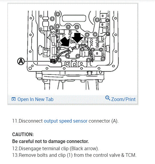

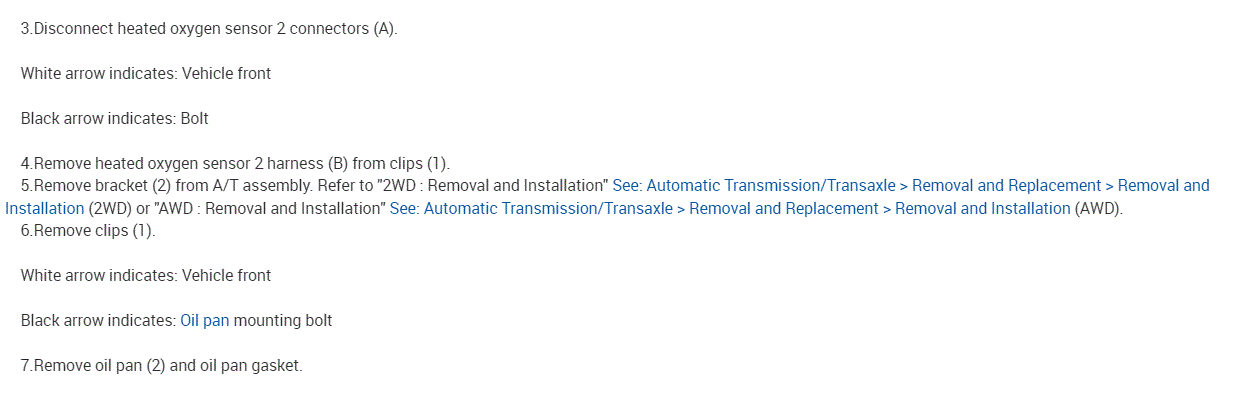

I read a lot about this common issue with valve bodies, but never seen someone replace it and say anything about programming it even when they buy a rebuilt one from Ebay. is this the case?
Apr 16, 2022 at 8:45 AM
  • 110,244 POSTS

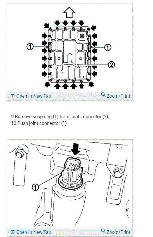

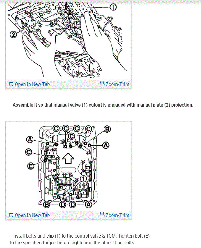

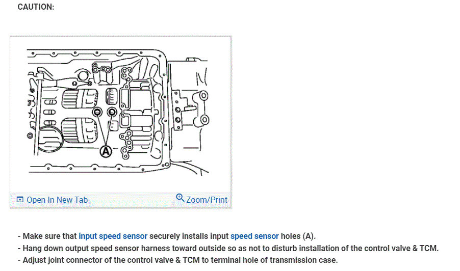

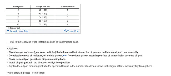

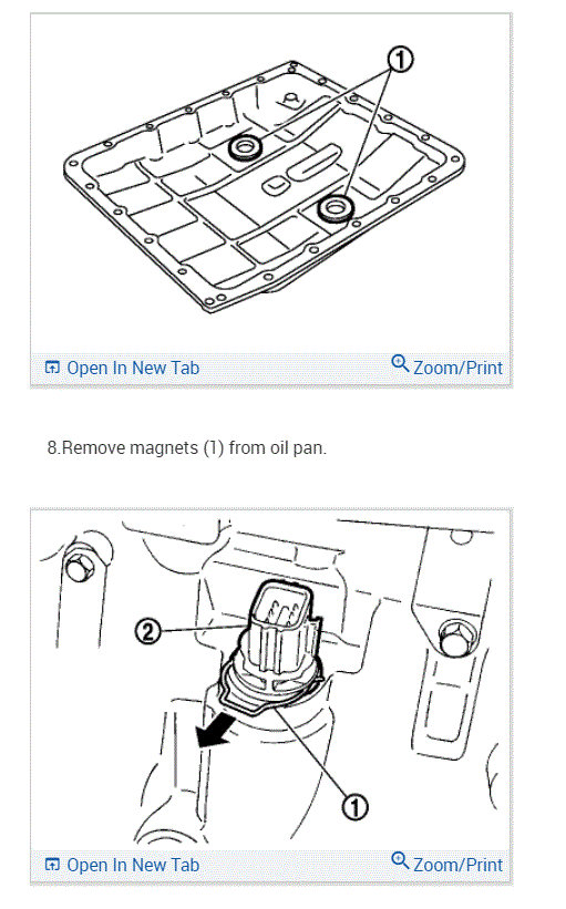

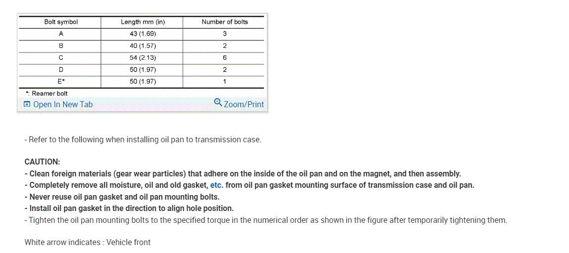

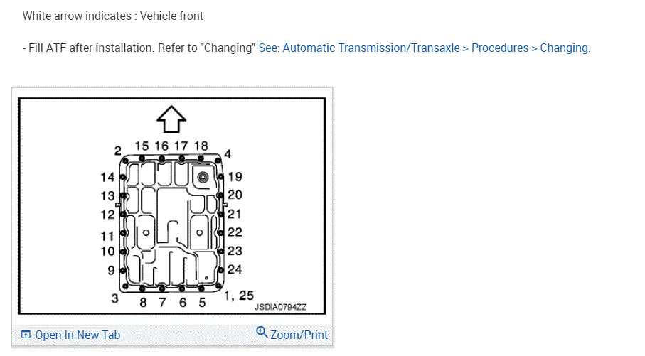

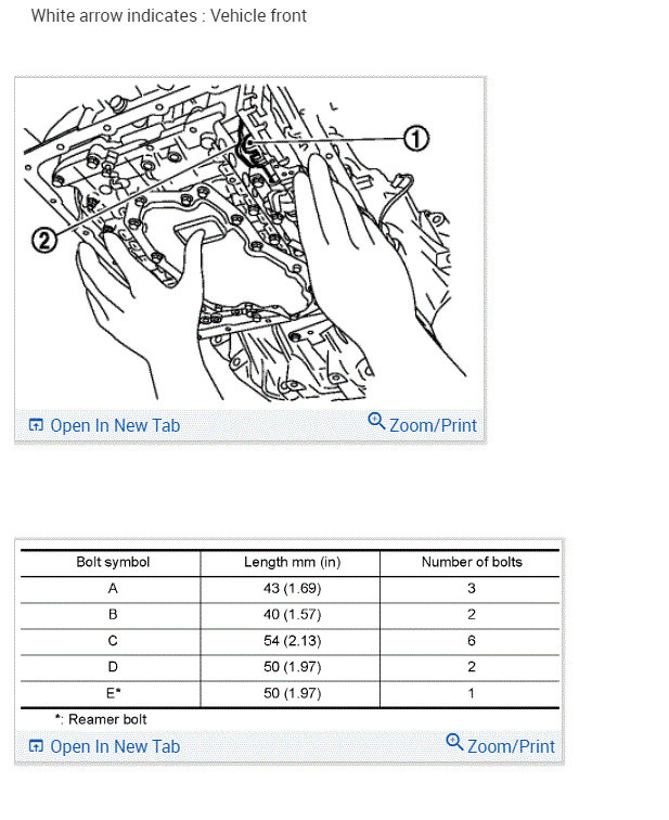

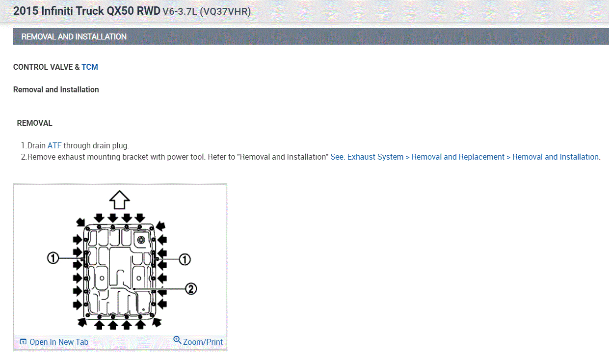

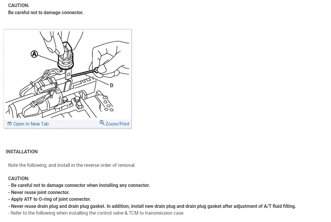

I just read through the procedures for the removal and installation of the valve body. There is nothing listed that indicates reprogramming.
I attached the directions below for the procedure. Take a look through them and let me know if you have questions. Additionally, let me know what you are experiencing and if you have found diagnostic trouble codes stored.
