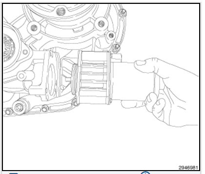

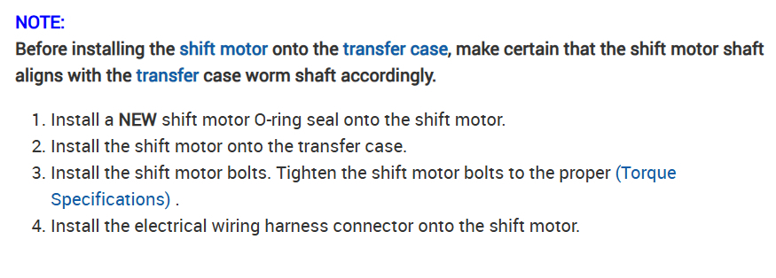

Here are some images to help as well.

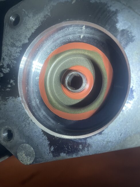

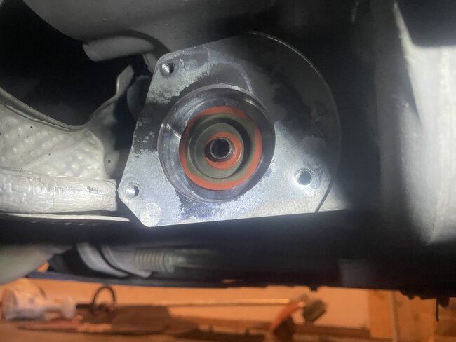

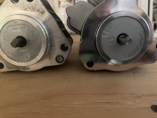

Here's some photos of the transfer case with the actuator off and a side by side of the old and new actuator.

Nice work, okay you can see that the new actuator is "timed" differently than the old one. So we need to move the internal part of the transferase to match it or, plug the new actuator in and turn the car one, (do not start the engine) and work the 4wd controls so it matches the old unit then install it. Let m know how it goes.

If you don't drive the car you should be fine, both of the methods you motioned will work. The idea is to align the actuator with the slot in the transfer case or, move the slot manually to line up with the actuator.
