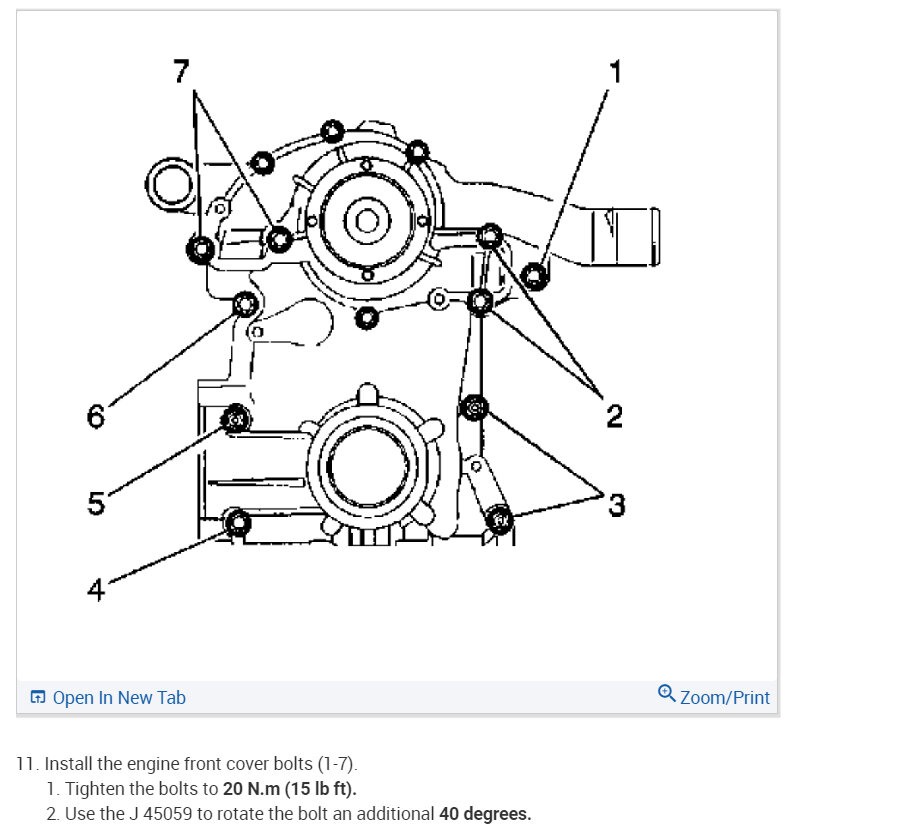

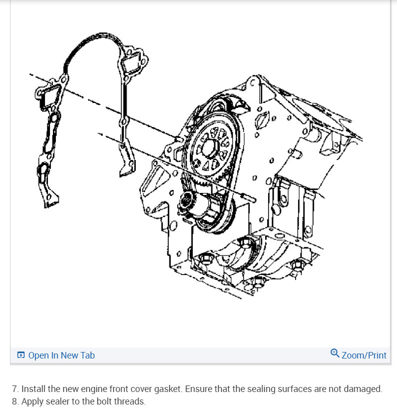

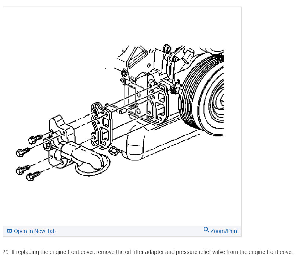

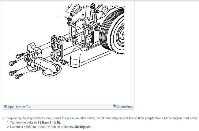

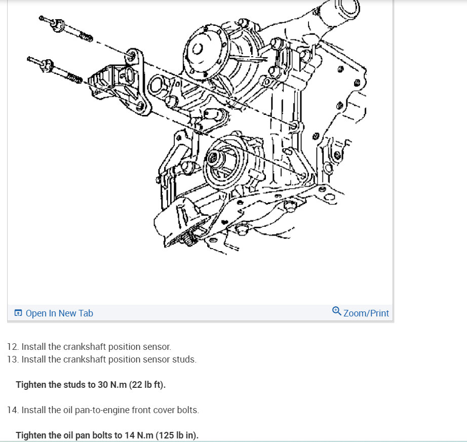

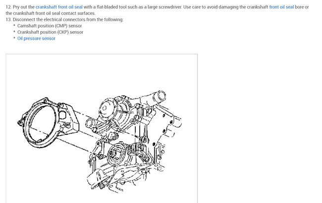

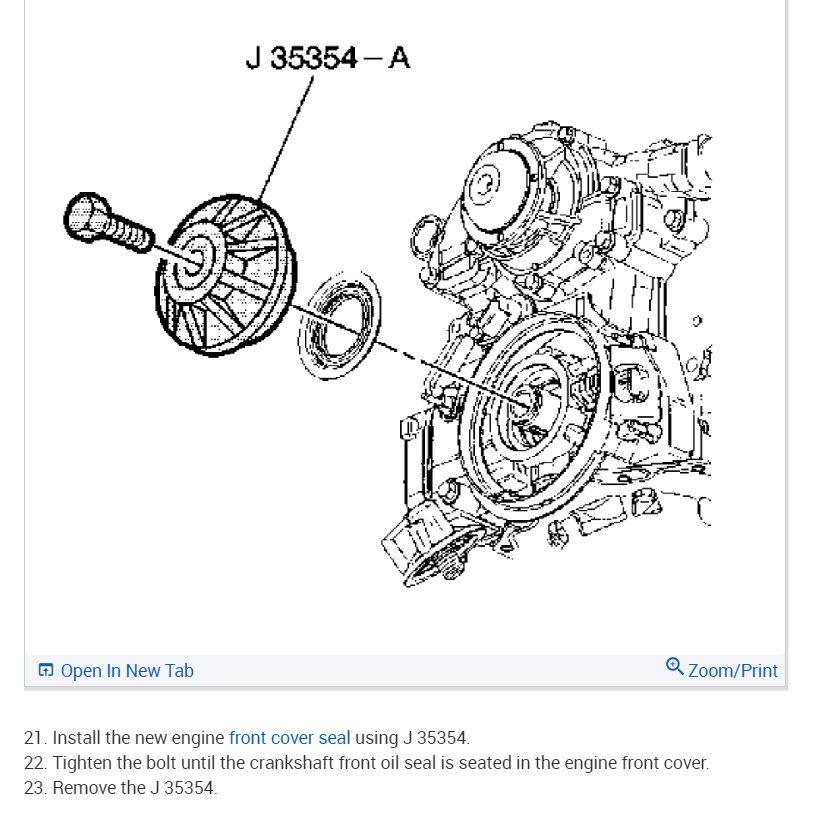

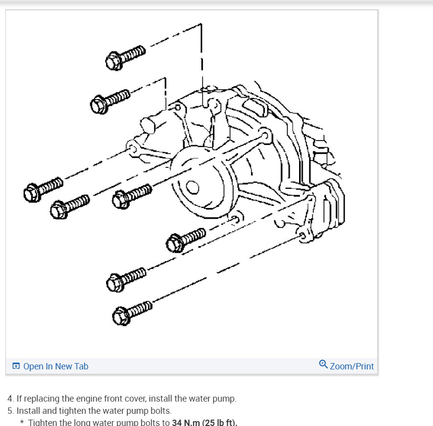

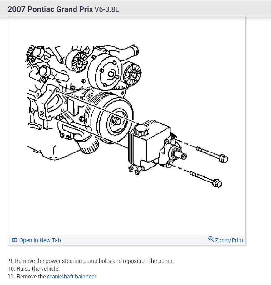

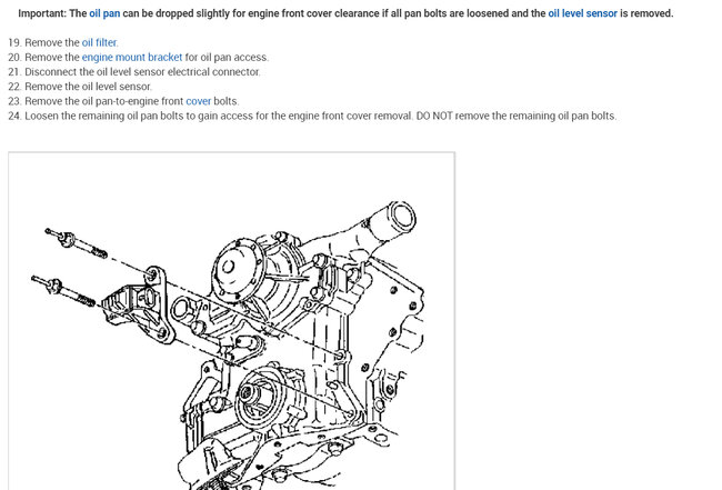

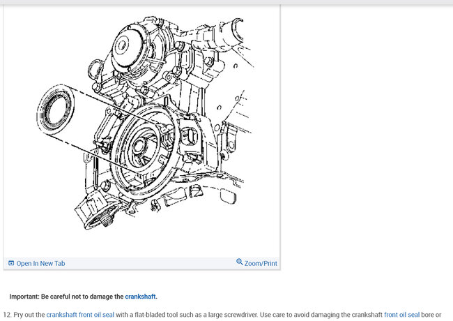

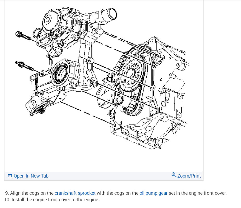

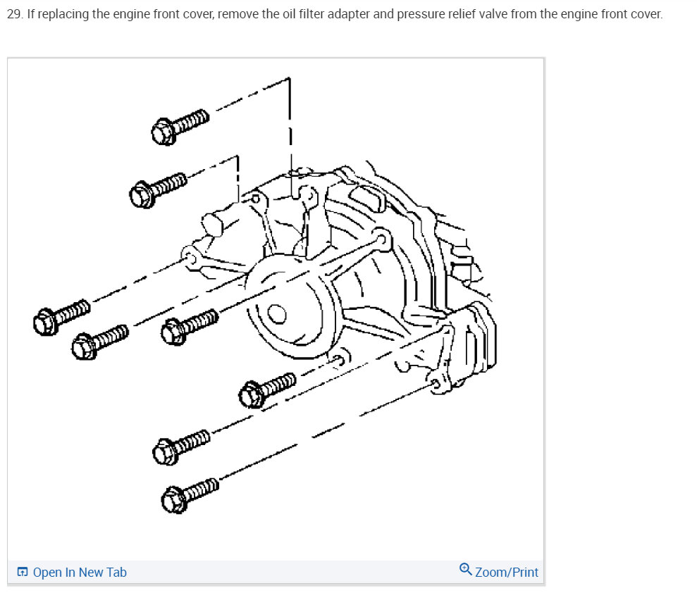

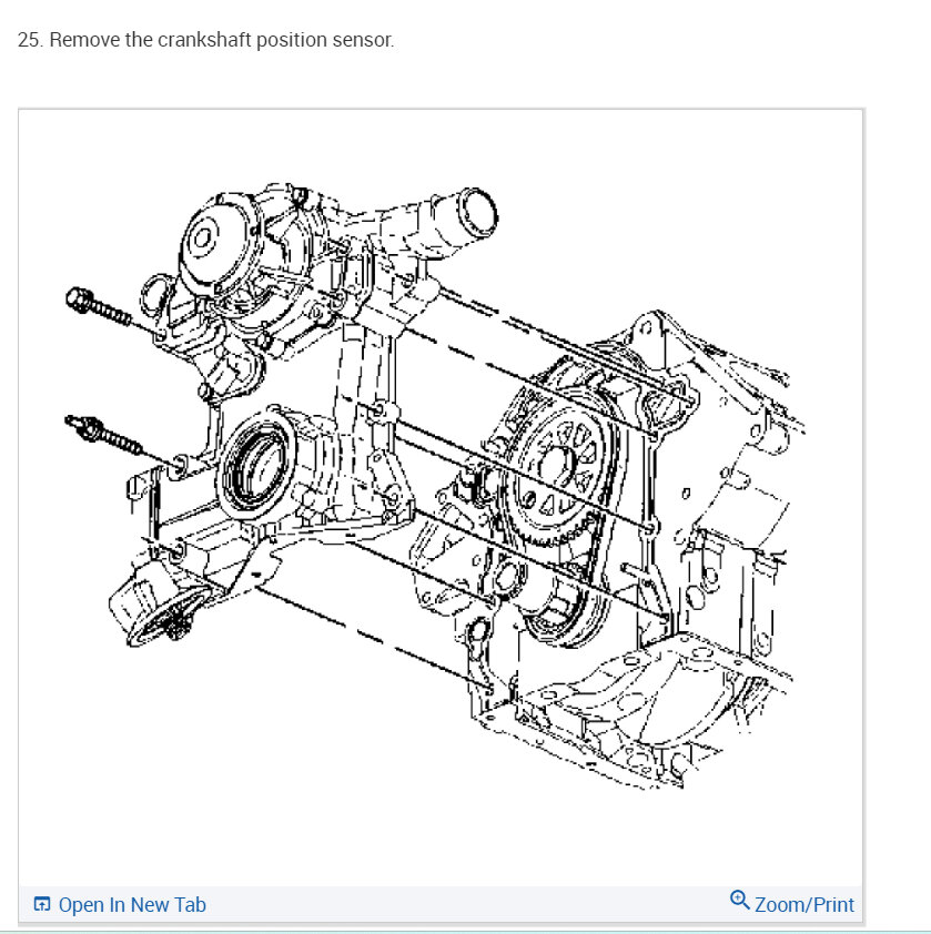

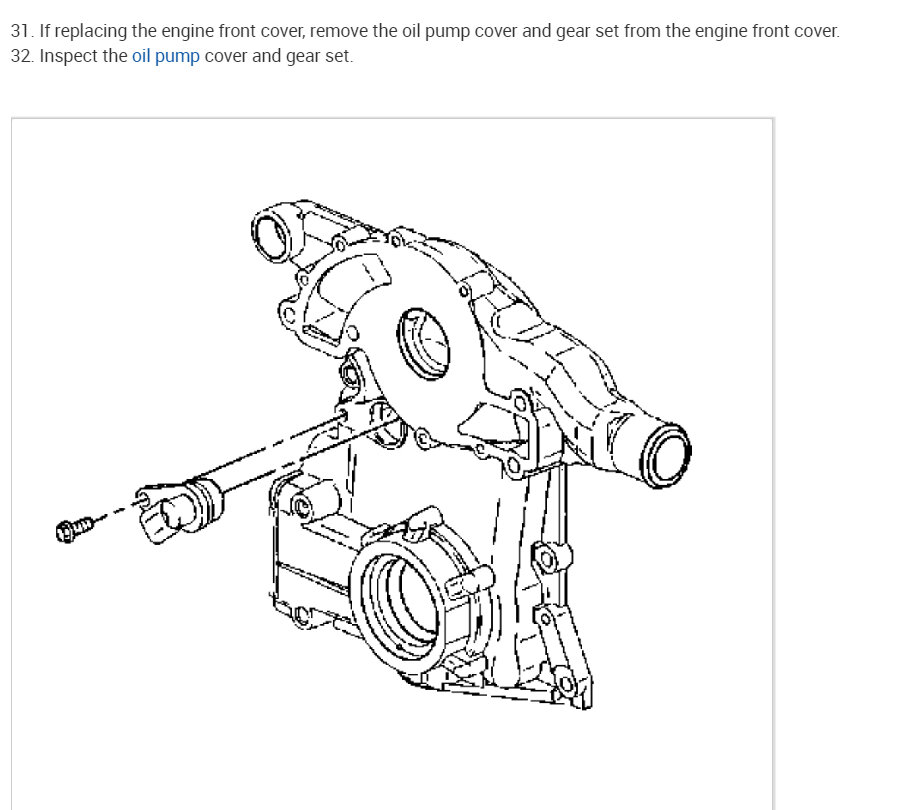

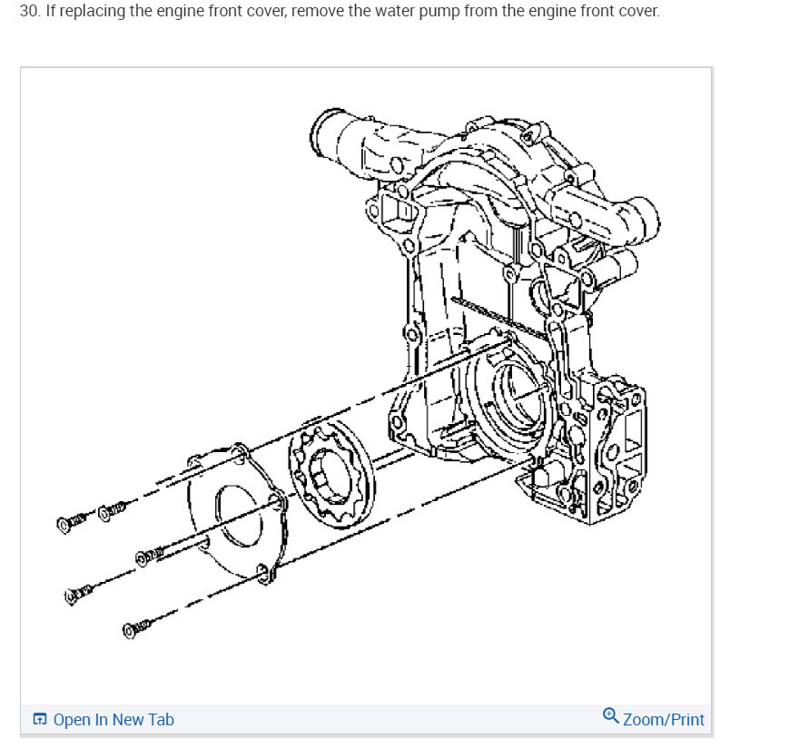

Hi, I am in the process of replacing timing chain gasket, seal, upper and lower intake manifold gaskets. It is a 3800 super charged. Somehow I got the bolts mixed up on the front of the engine and I am not sure of what ones go where. I was wondering if you guys had a schematic layout or picture of what bolts go where? I know it won't be exact. But I think with a little help I could figure this out. Thank you!
Aug 2, 2023 at 8:22 AM
  • 55,399 POSTS

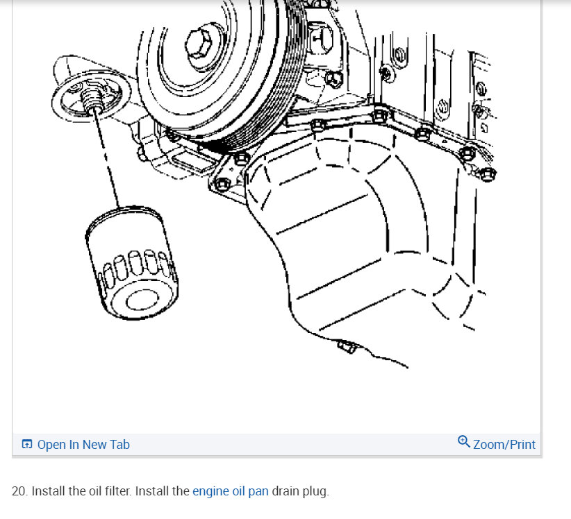

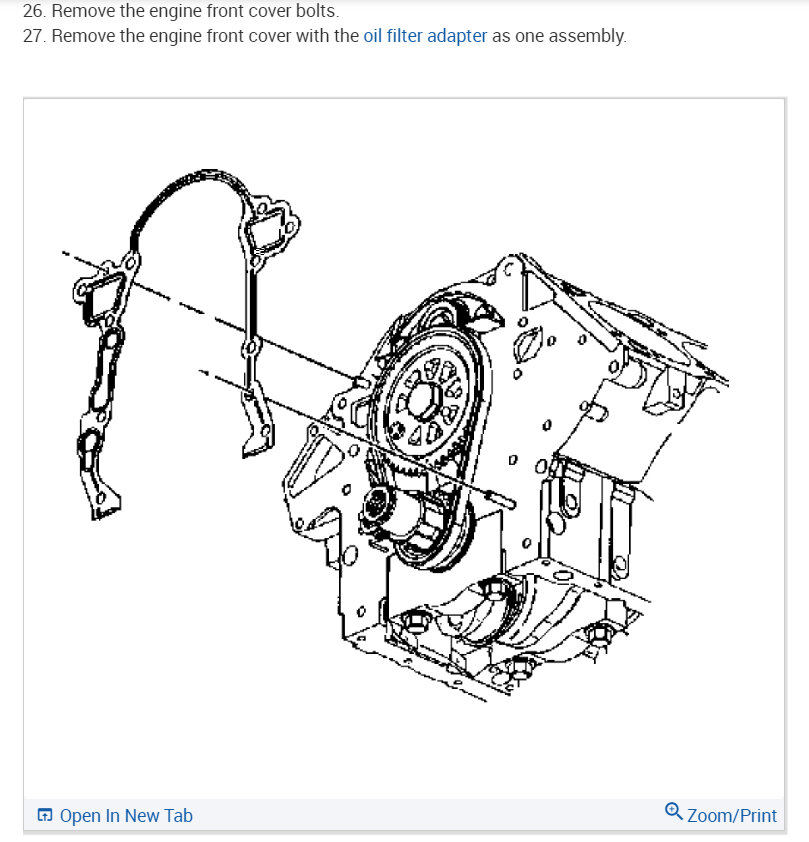

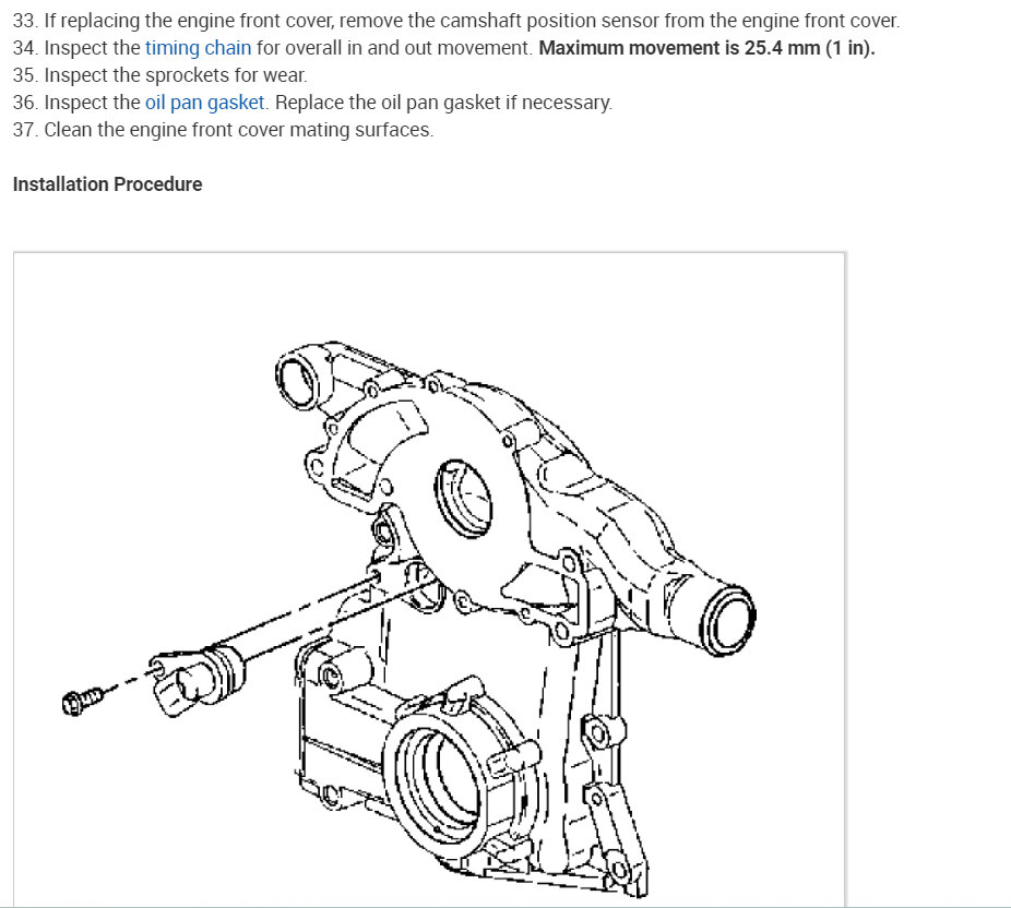

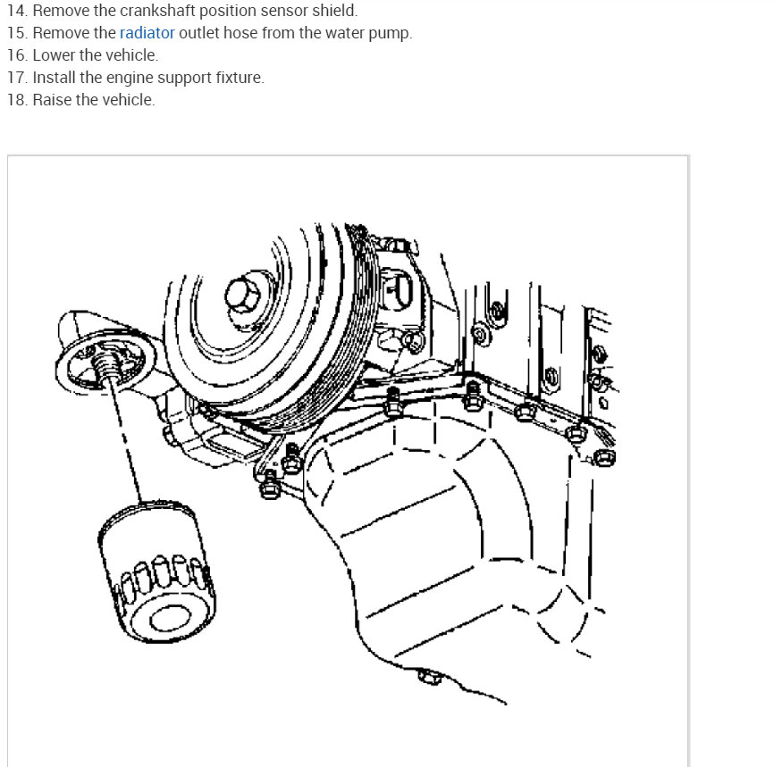

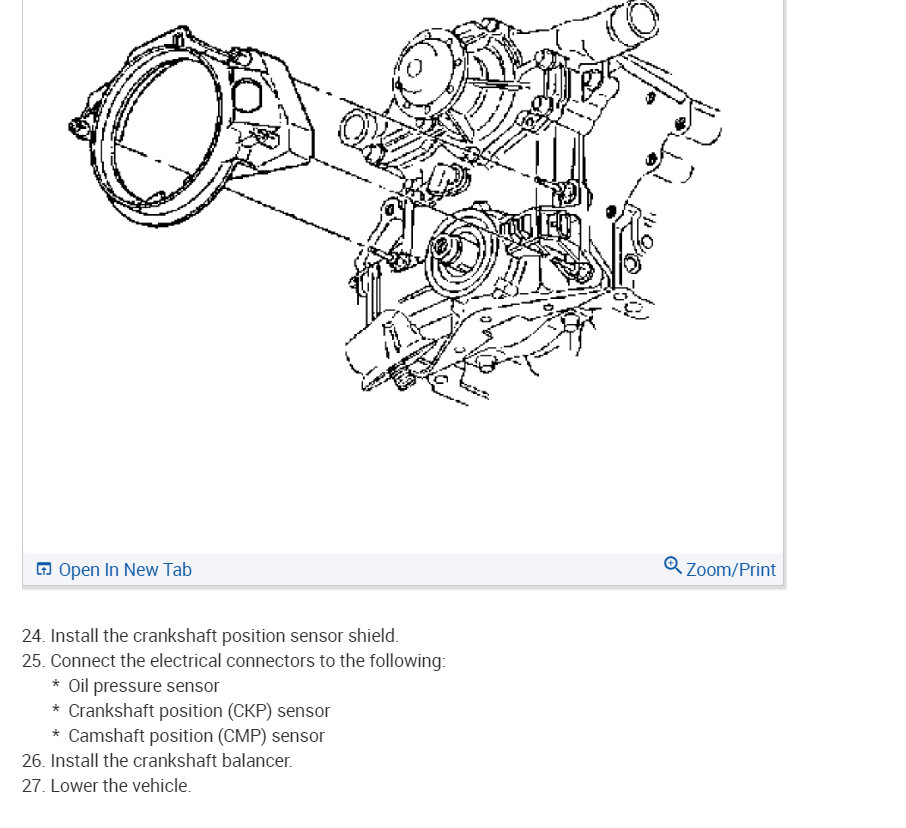

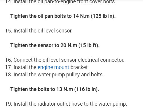

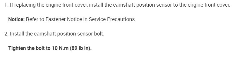

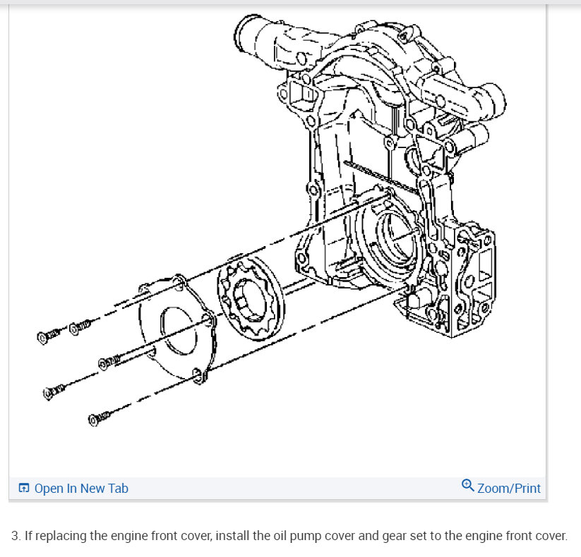

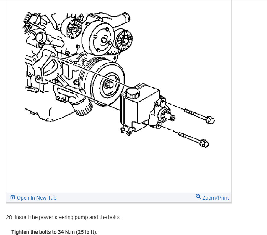

Sure, here are the instructions for replacing the timing cover gasket, where the bolts go and how much to tighten them torque wise. Check out the images (below). Please let us know if you need anything else to get the problem fixed.
