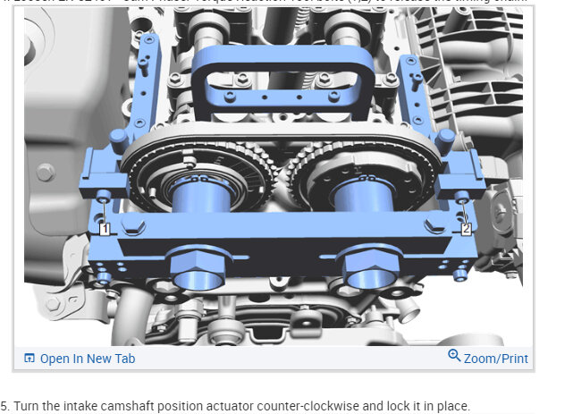

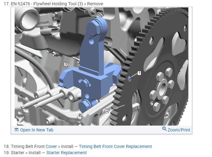

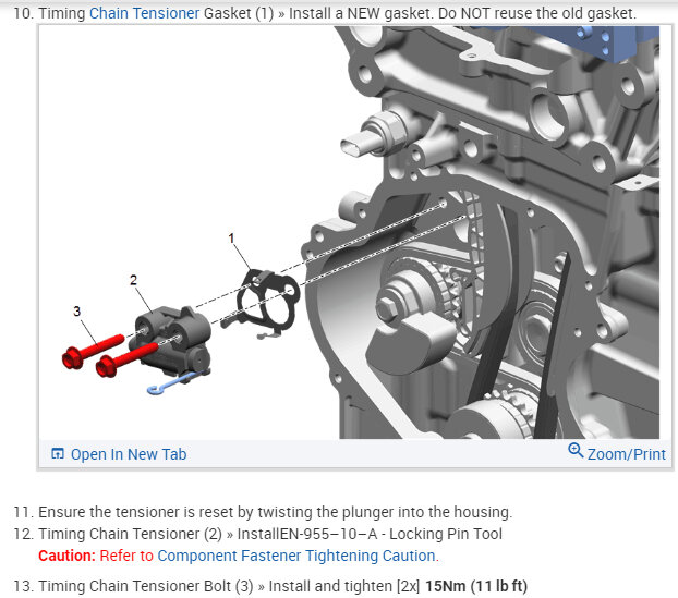

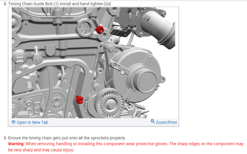

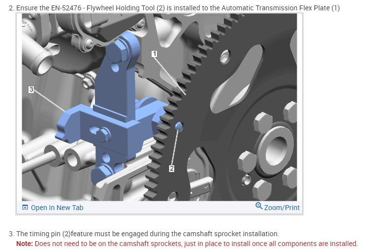

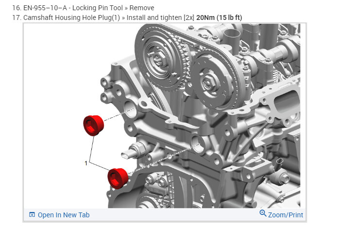

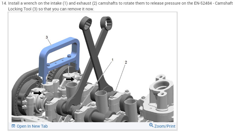

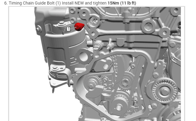

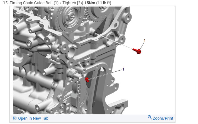

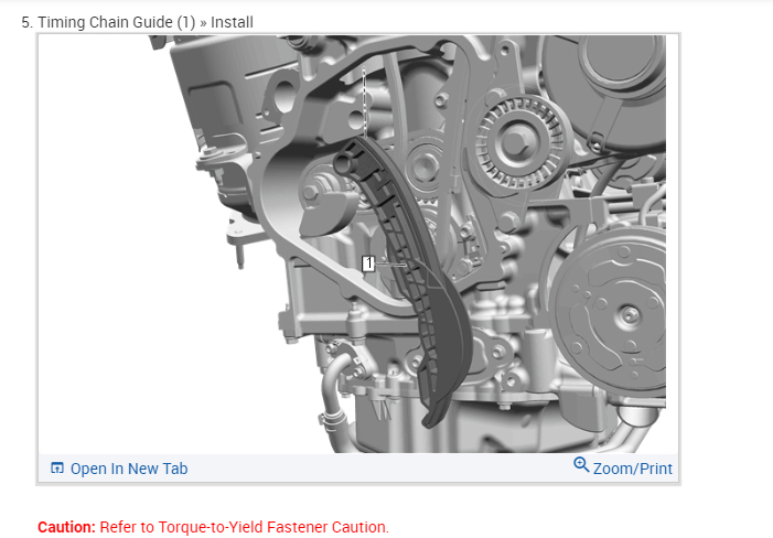

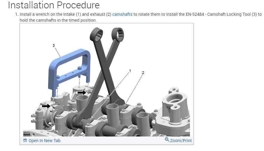

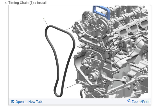

Tell me how to set the marks when replacing the timing chain on vehicle listed above with a 1.3 Liter Turbo I-3 L3T Engine.
Sep 15, 2023 at 11:02 PM
  • 110,194 POSTS

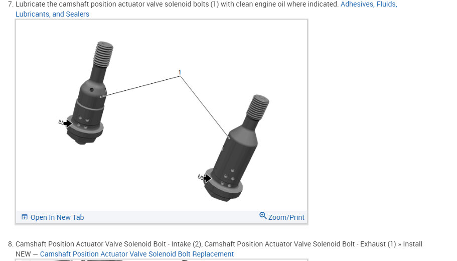

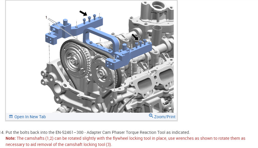

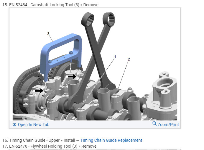

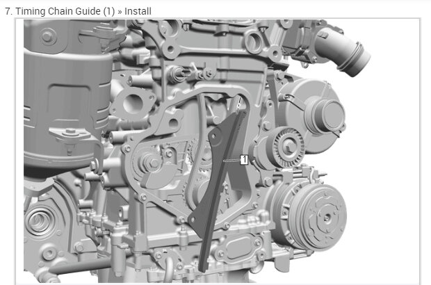

This process requires special tooling. You need them to prevent the camshafts from moving and properly setting them.
If you look below, I attached the directions for installation from my manual. Take a look through them and let me know if you have questions,
Sep 15, 2023 at 11:14 PM
AKON54

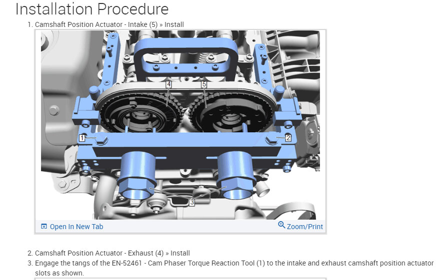

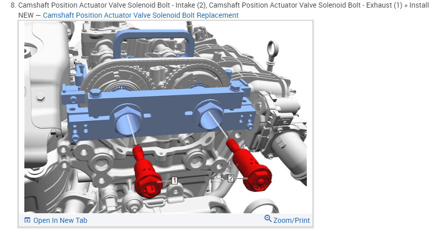

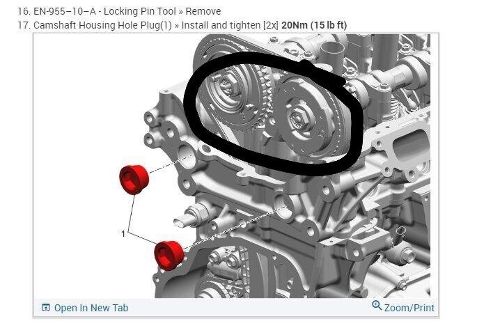

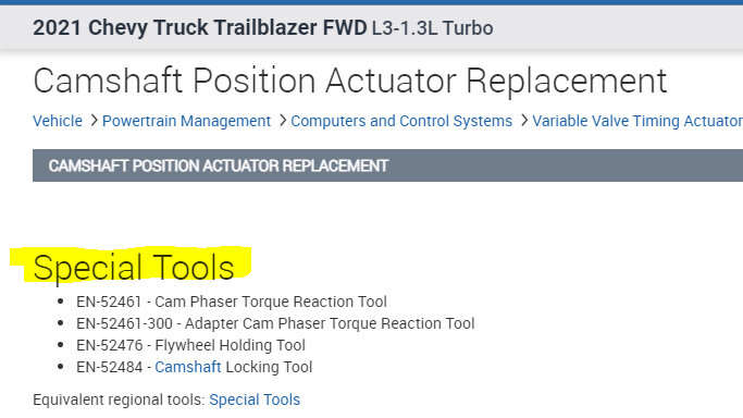

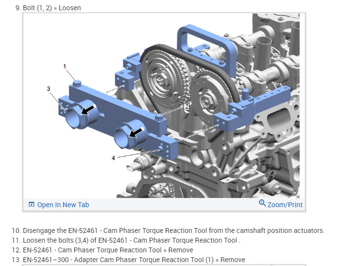

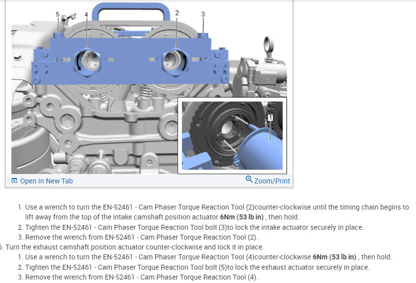

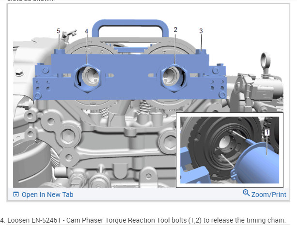

Thank you very much! one more question, is any special tool required when installing phase shifters?
Sep 16, 2023 at 12:09 AM
  • 110,194 POSTS
Yes, they have special tools for everything anymore. LOL As far as the phasers are concerned, I attached the directions below for replacing them. The tools needed are indicated.
Let me know if this helps.

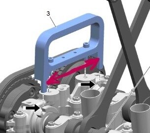

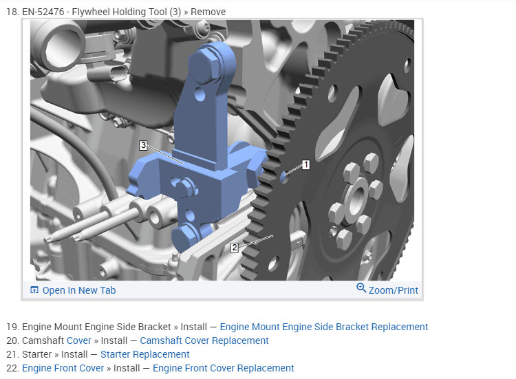

Thank you, is it possible to find out what is the distance of the internal part (in millimeters) on this device?
Sep 16, 2023 at 11:24 PM
  • 110,194 POSTS
I'm not sure what you need. Are you talking about the clearance between the pistons and valves? If so, that isn't something I have.
Sep 17, 2023 at 1:09 PM
AKON54
no, I need distance inside the tool itself (number 3 in the photo).
