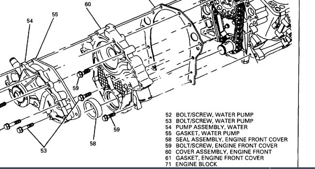

In the Haynes manual it says to remove the oil pan. Is that required to replace the timing chain and gears? If it is, it is probably worth it to replace the oil pump, too. But I did not expect to have to remove the pan for this job.
Aug 9, 2018 at 12:15 PM
Good afternoon.
The procedure is to remove the pan but you do not. If you loosen the front bolts in the oil pan, it will move down enough to remove and install the cover. It is tight but can be done. I do it all the time.
Aug 9, 2018 at 1:02 PM
DOUG42190
  • 23 POSTS

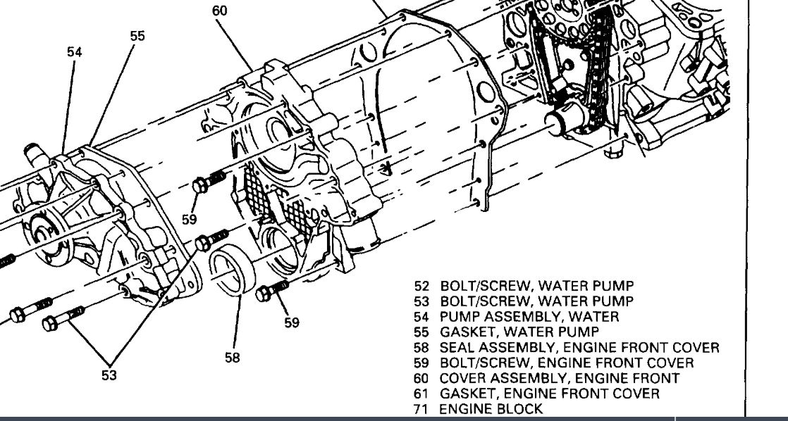

That sounds good, thank you Roy. Your diagram clearly shows the gaskets for the water pump, the timing cover to block, and the crank seal, but what precautions do I need to take when I put it back together to make sure I do not get an oil leak from the oil pan or from the oil pan/timing cover joint? When I separate them (even if I am careful), am I likely to tear the oil pan gasket? Is there a gasket or seal I should replace between the the pan and cover or do they just butt together? Just apply RTV?
Doug
Aug 10, 2018 at 6:22 AM
The oil pan gasket is a thick rubber gasket, not a paper gasket. put some gray sealer on the bottom of the timing cover when installing.
clean all the surfaces well and make sure they are clean. a small amount of RTV is good.
Aug 10, 2018 at 1:59 PM
