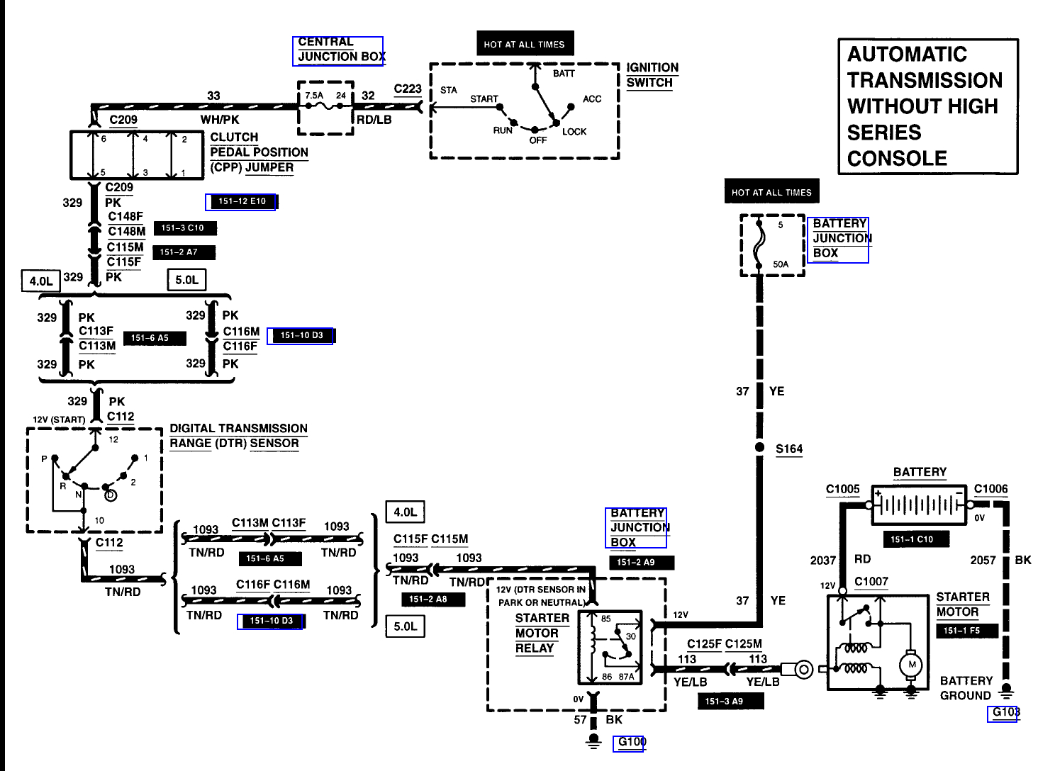

Does my car have a starter solenoid on the firewall?
2001 MERCURY MOUNTAINEER
140,000 MILES • 0.5L • V8 • 2WD • AUTOMATIC
FRANK TOLBERT
Replacing the starter and I want to see if the solenoid is any good on the firewall that is if it has one.
Jun 13, 2018 at 3:50 AM
STEVE W.
  • 15,345 POSTS
It has a starter relay but not on the firewall, it is in the relay box under the hood. Check out the diagrams (Below). Please let us know if you need anything else to get the problem fixed.
