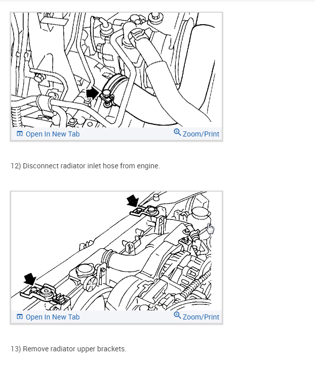

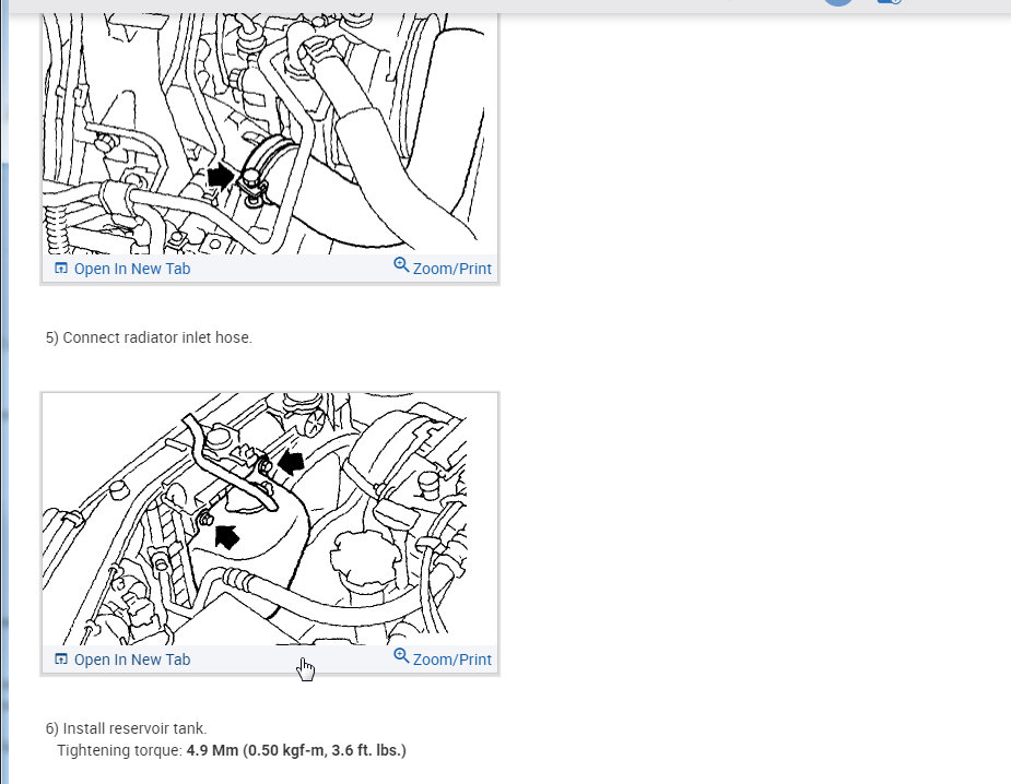

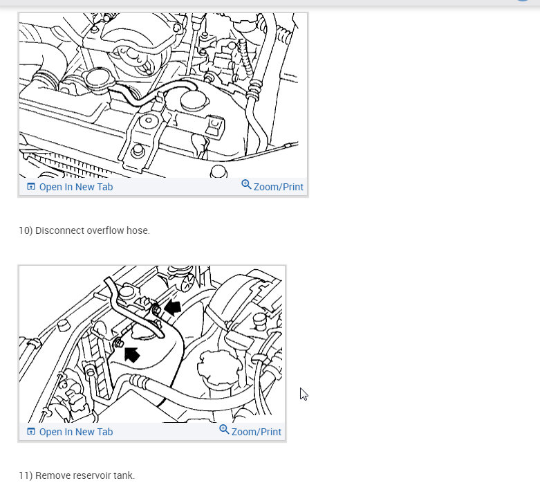

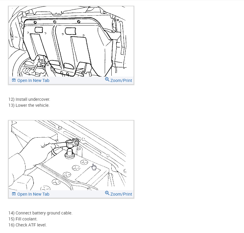

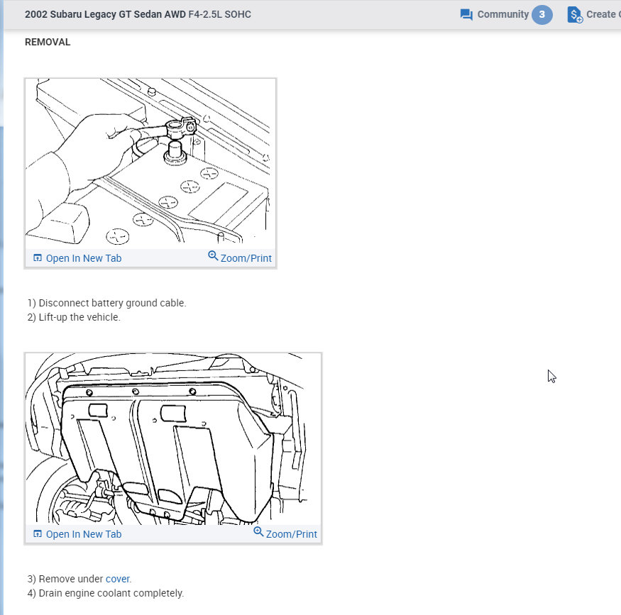

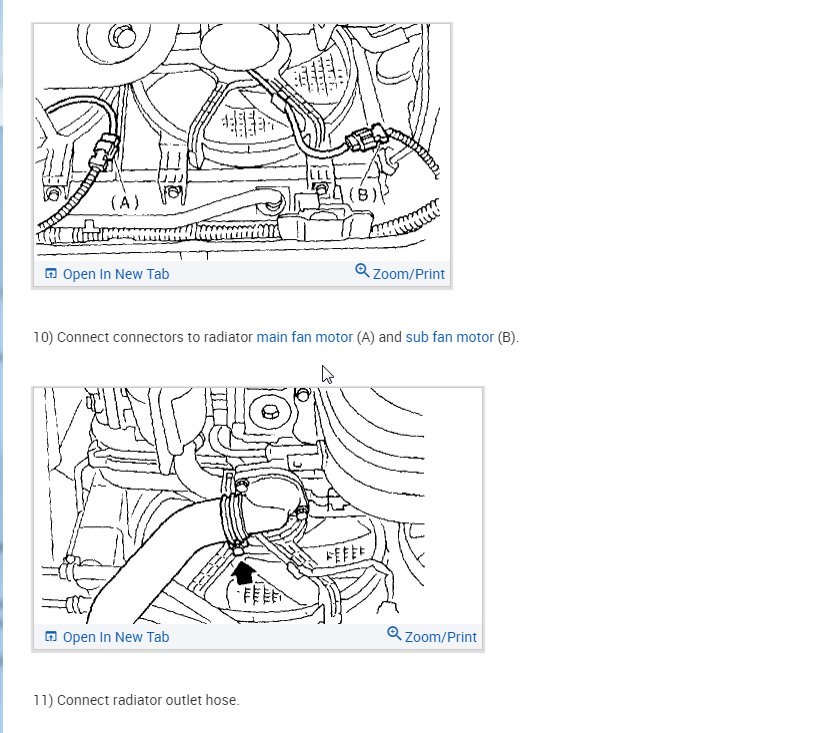

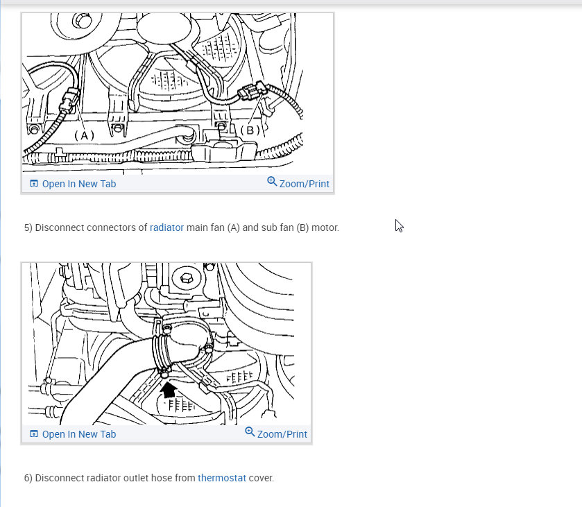

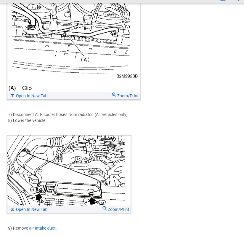

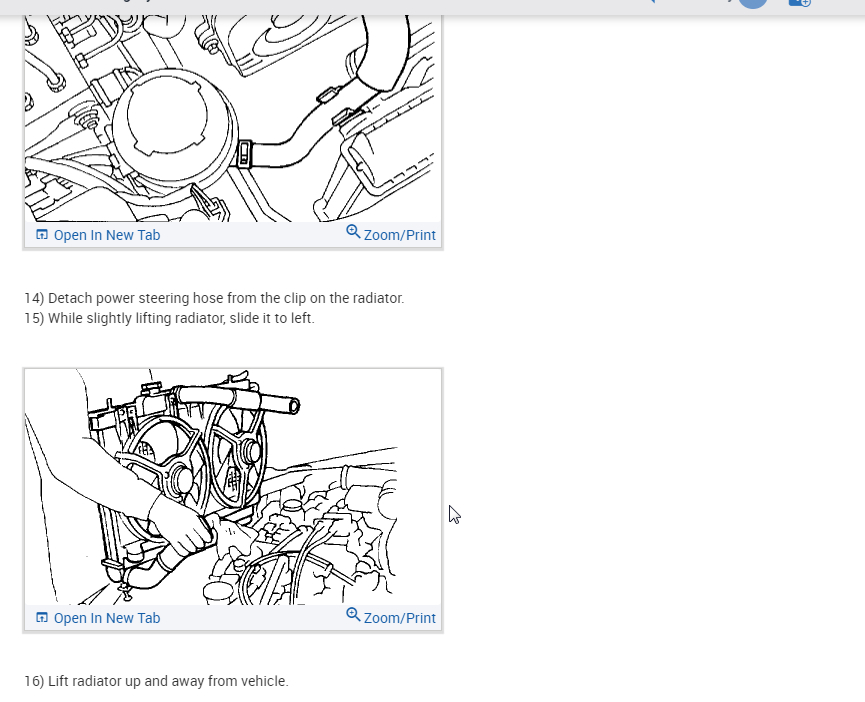

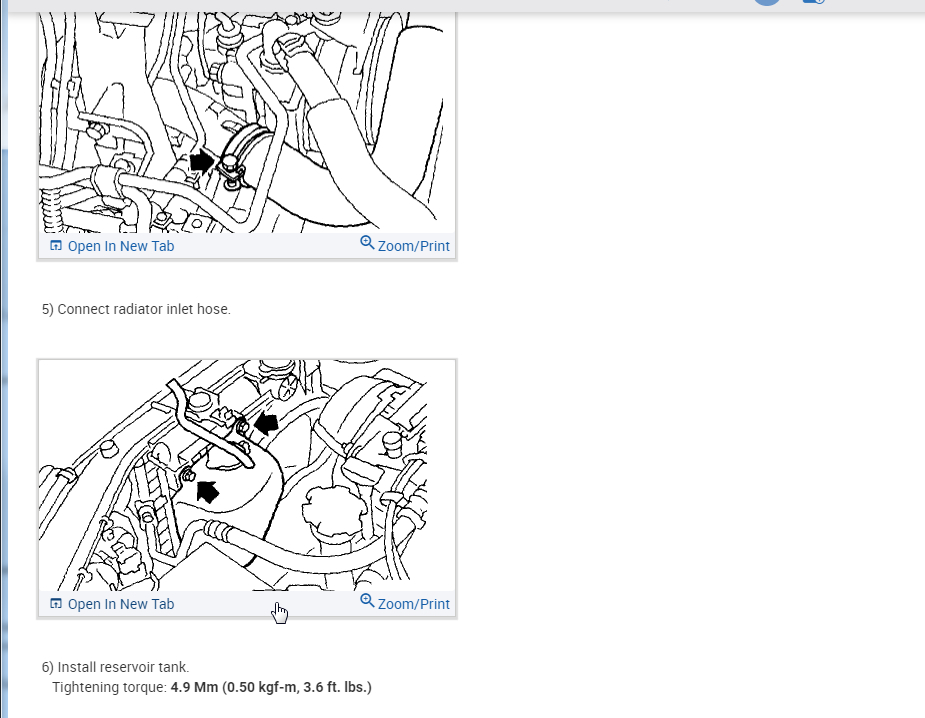

Do you know where i can find the measurements of the length of each of the hoses needed? most importantly the length of the smaller circumference hoses and can they be the same type and strength for both small hoses needed.
May 19, 2020 at 10:47 AM
  • CAR REPAIR CONTRIBUTOR

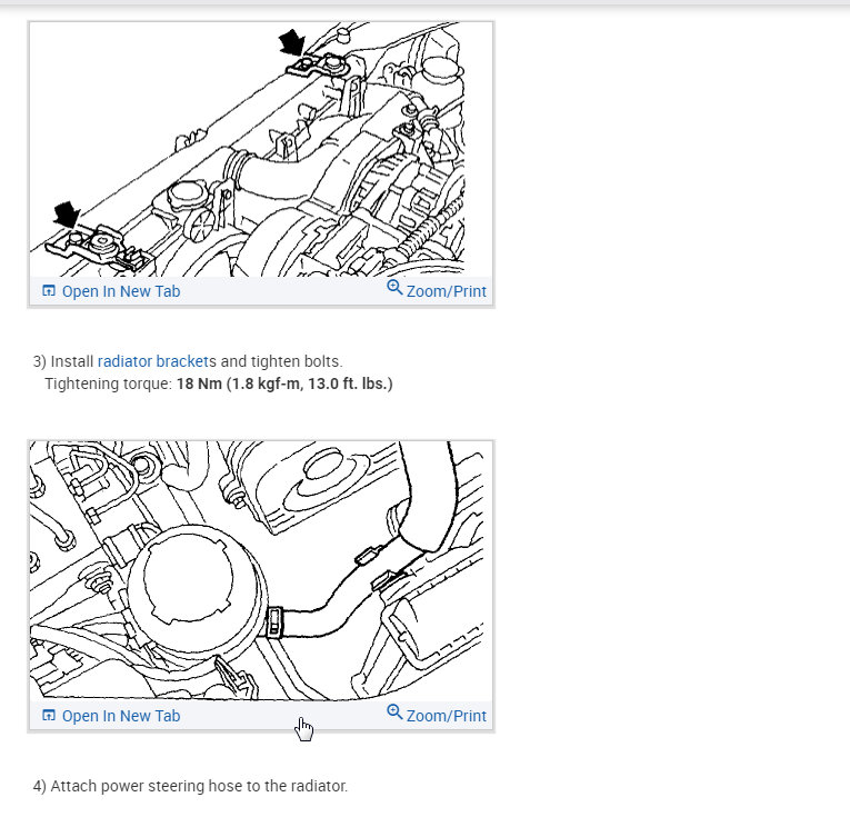

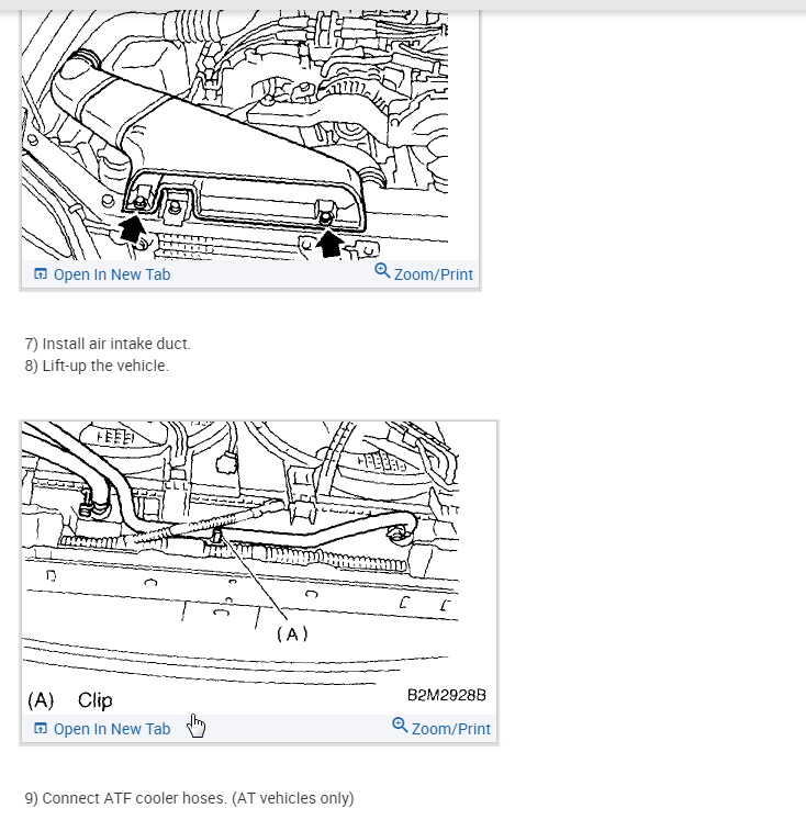

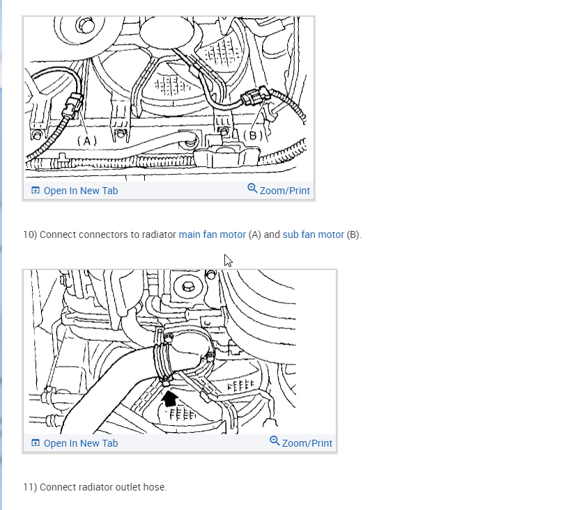

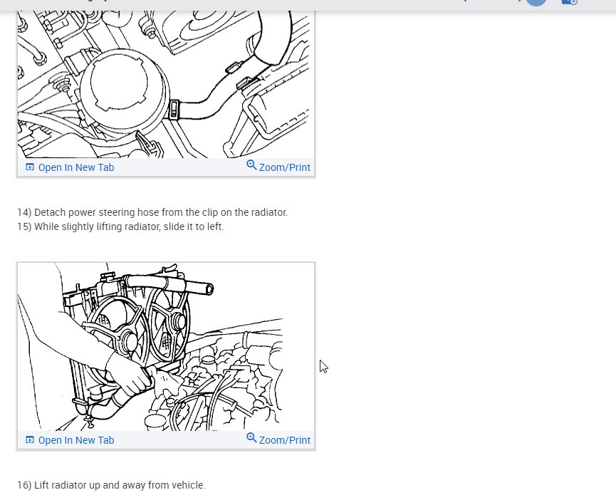

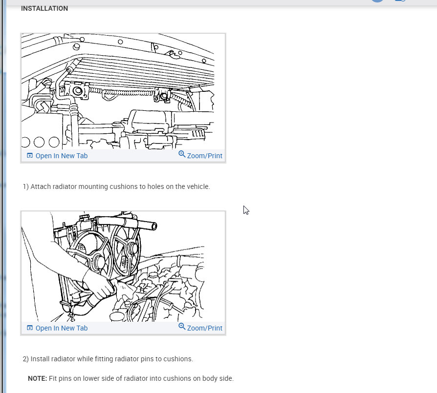

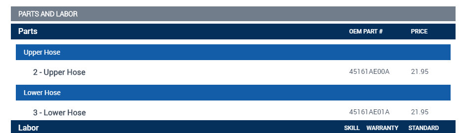

I attached the process for replacing the radiator. Also, the part numbers for the upper and lower radiator hoses. The smaller hoses are just bulk hoses that you can take to the parts store and match them up. We don't have a size for these hoses so again, you will just need to compare them to the bulk hose at a parts store.
I also attached a link to a popular parts site that lists all the available hoses for the system. Let us know if you have questions. Thanks
https://www.rockauto.com/en/catalog/subaru,2002,legacy,2.5l+h4,1378784,cooling+system,radiator+upper+hose,2058
