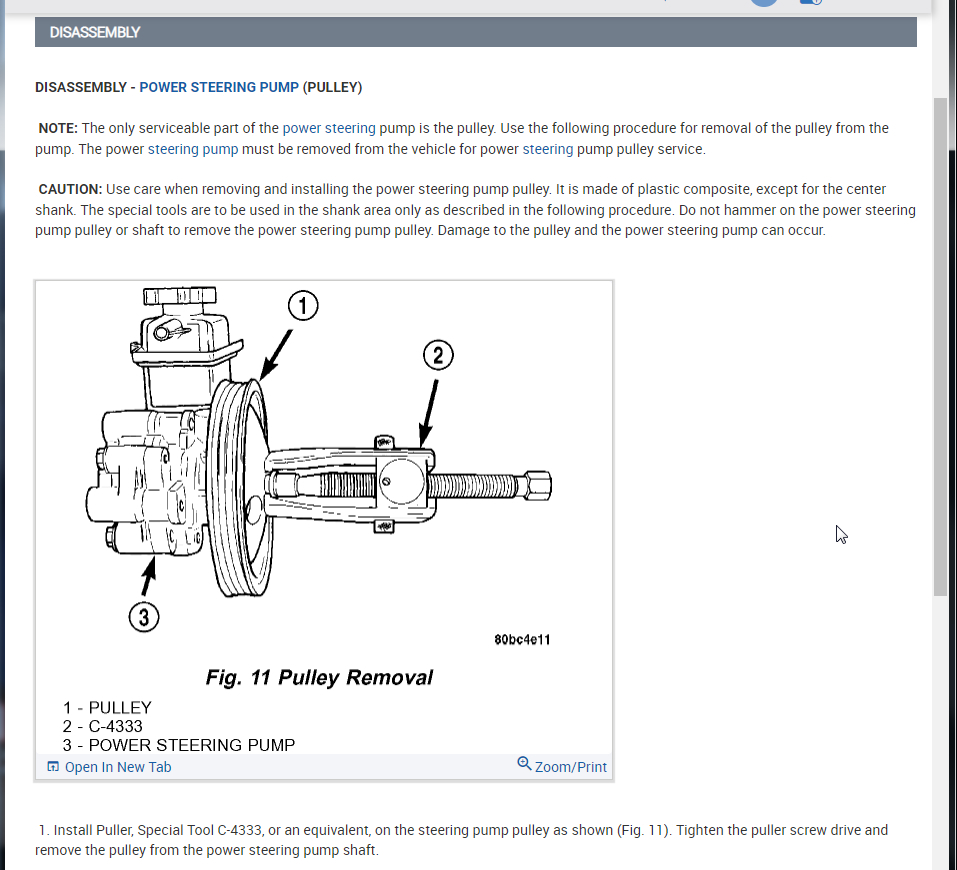

I would like to know what tools are needed and how to replace a power steering pump pulley?
Nov 24, 2015 at 4:10 PM

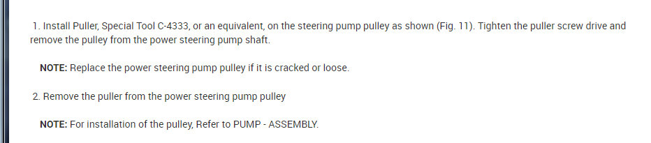

There are not a lot of tools needed other then a puller. I attached the process for removing the pulley. Let us know if you need more info and we can go from there.
Also, here is a guide that will show how this is done as well:
https://www.2carpros.com/articles/remove-reinstall-power-steering-pulley
