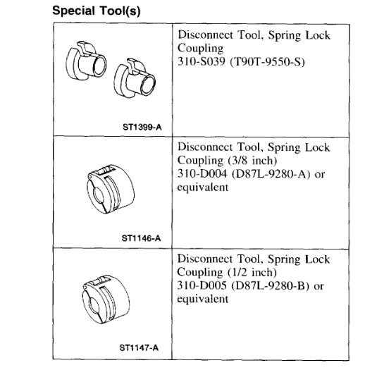

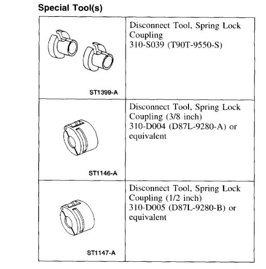

Trying to remove the fuel lines to replace a fuel filter on this SUV. One is a push and release, but i cannot figure out the one line and how to remove the line.
Feb 14, 2019 at 11:17 AM
Good afternoon,
There is a tool to release the clip for the line. You can get a set of the line release tools at a parts store for about $10.00.
Below are the tools you need to release the clips.
