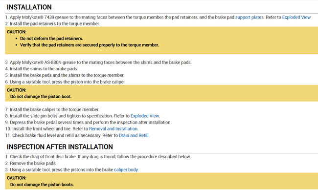

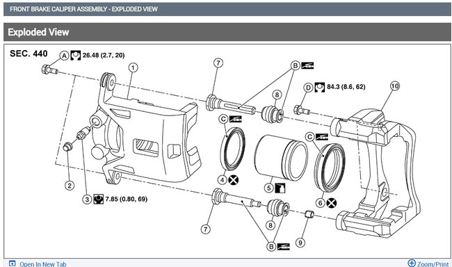

Hello, I need to replace the front struts and the front brakes on my vehicle listed above. I was hoping you could share the torque specs for these 2 areas. Thank you.

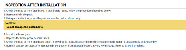

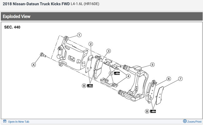

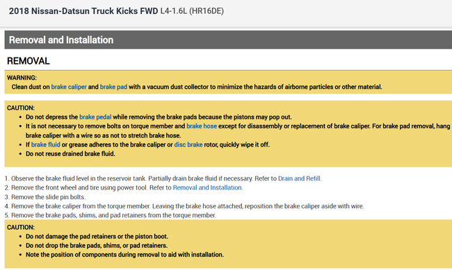

No problem, can you start a new thread for the struts, sorry, we only handle one problem per thread, we will do the front brakes on this question. Here is how to change out the front brake pads and rotors with the torque specs. Check out the images (below). Let us know if you need anything else.

Awesome, thank you so much for that. I’ll ask about the struts in another post. You're the best.
