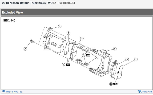

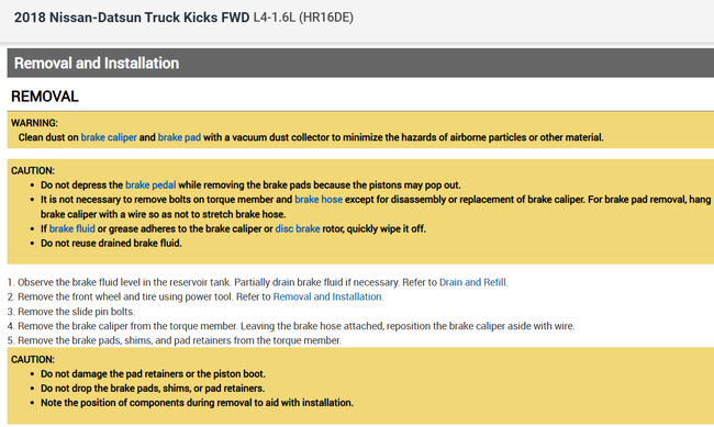

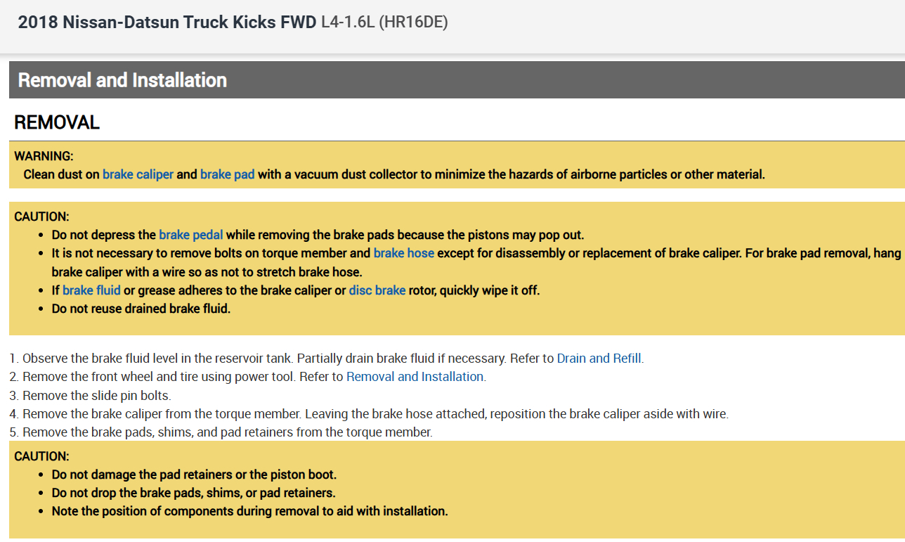

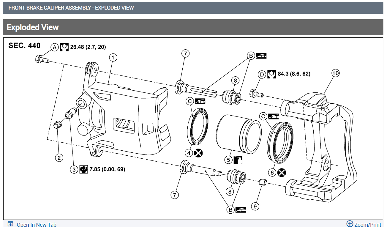

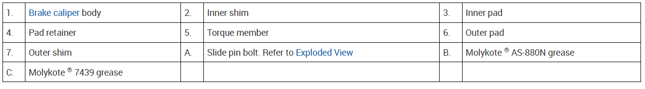

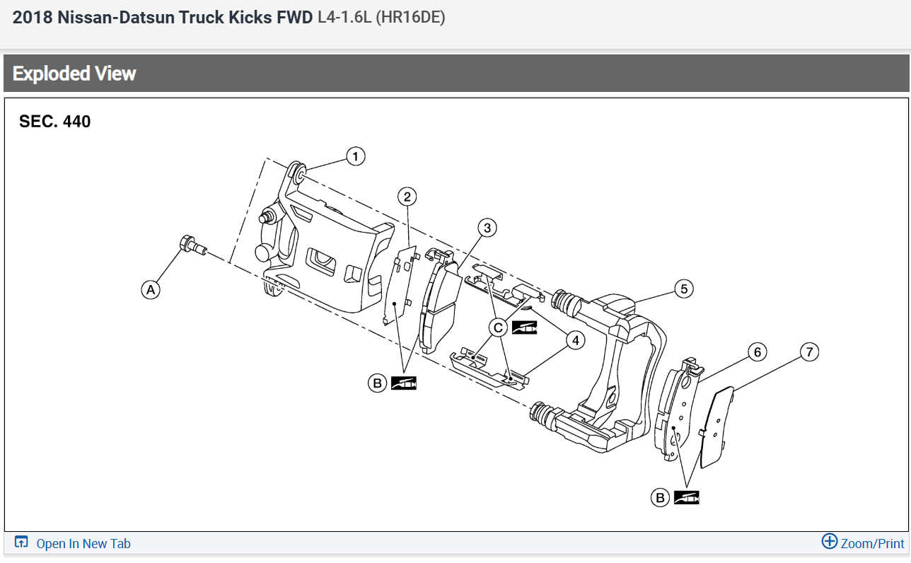

Hello, I need to replace the front struts and the front brakes on my vehicle listed above. I was hoping you could share the torque specs for these 2 areas. Thank you.
Mar 14, 2025 at 9:48 PM
  • 55,395 POSTS
No problem, can you start a new thread for the struts, sorry, we only handle one problem per thread, we will do the front brakes on this question. Here is how to change out the front brake pads and rotors with the torque specs. Check out the images (below). Let us know if you need anything else.
