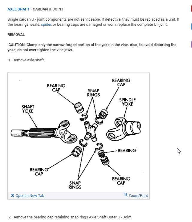

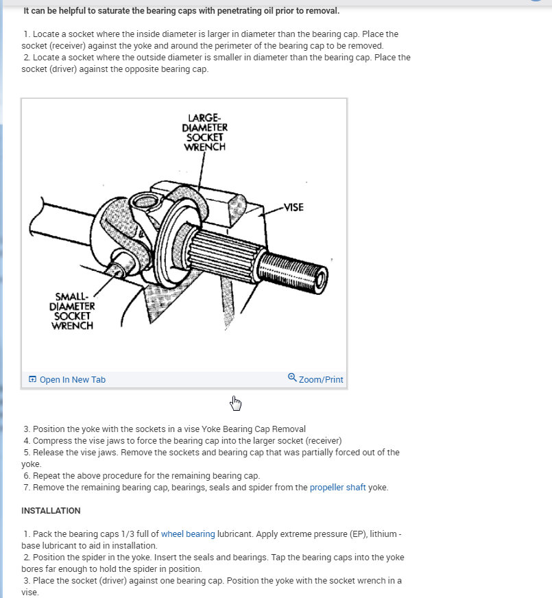

We had to have the 4x4 drive shaft removed due to it slipping into neutral going down the highway. Was wondering what parts do I need to fix the drive shaft joints or should I just replace the thing as a whole?
I'm on a budget but I don't want it to be half hazard either. what would be better for me in the long run? Have to replace the exhaust too.
Feb 14, 2020 at 3:48 PM
Just to clarify, you are replacing either the entire driveshaft or the universal joints for it slipping to neutral on the highway?
If this is the case, I doubt the drive shaft is the issue. However, here is all the info on what you asked for on the U-Joints. You do not need to replace the entire shaft if the joints are an issue but it is much easier to replace it.
https://youtu.be/PmbiyaOP_Ss
https://www.2carpros.com/articles/how-u-joints-work
Let me know if I am not understanding something and we can go from there. Thanks
