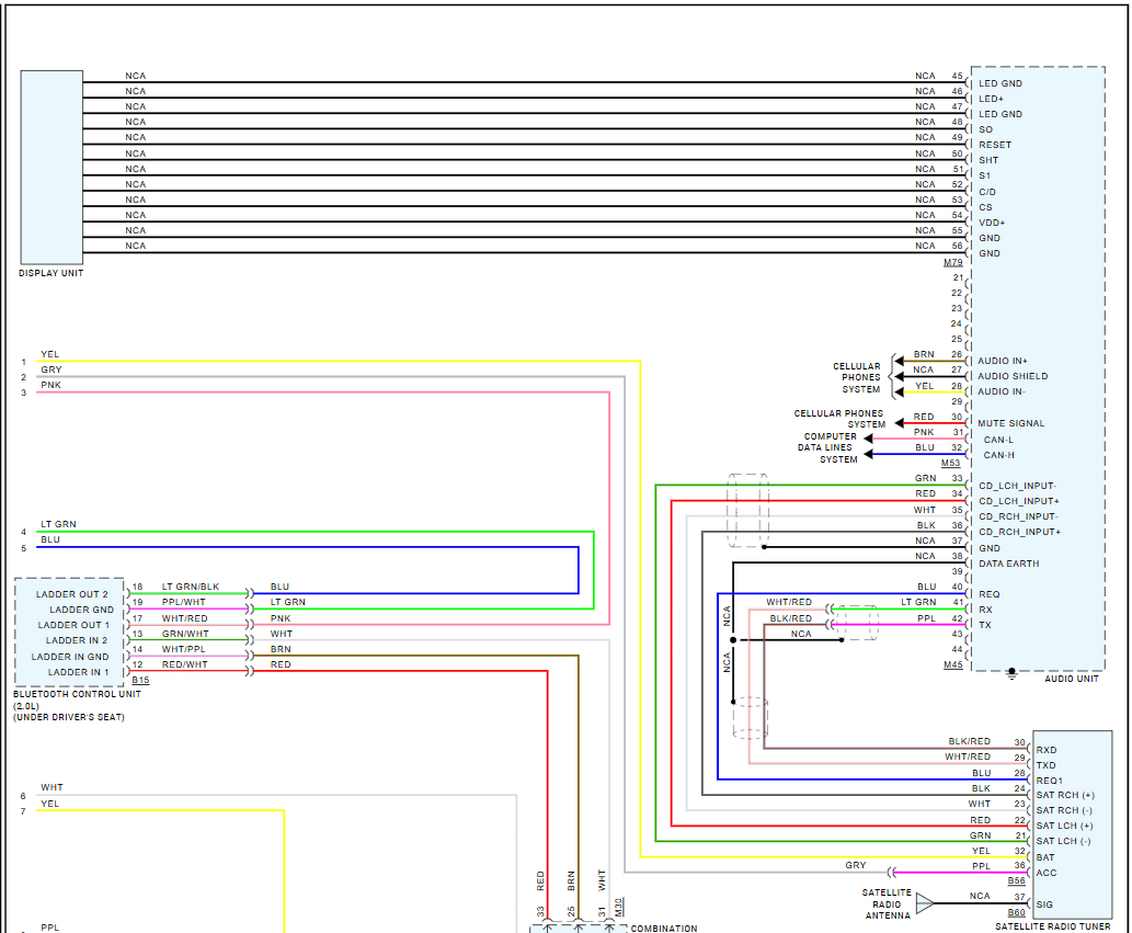

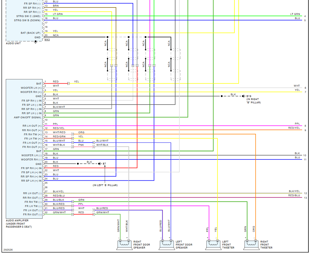

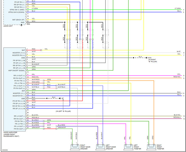

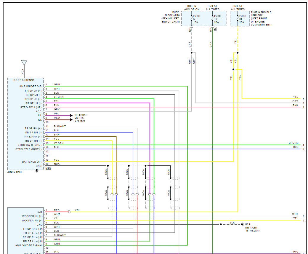

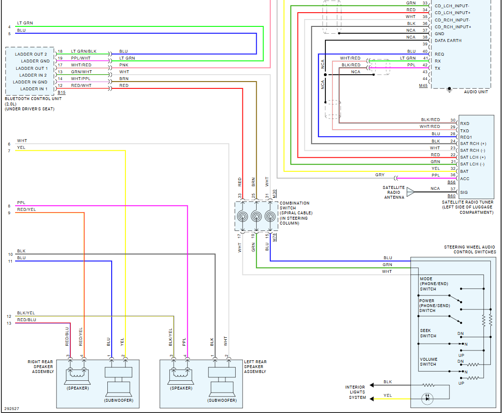

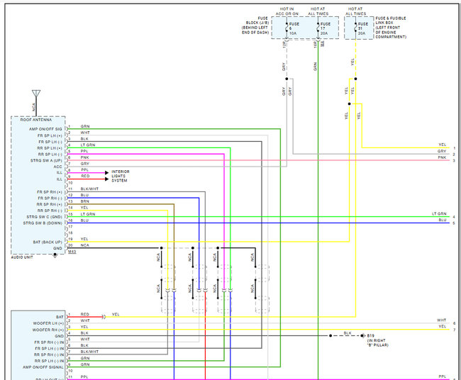

I need the stereo wiring diagram so that I may hook up aftermarket stereo correctly.

Sure here is the radio wiring diagram as requested. Check out the images (below). Let us know if you need anything else.
