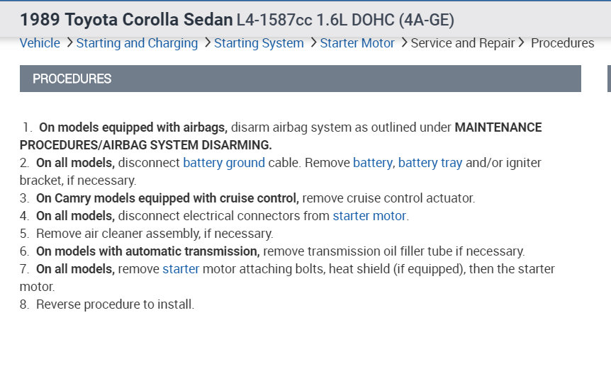

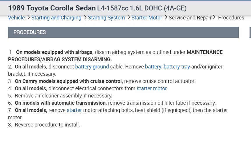

Someone said they would replace starter for me, but only took starter out. So I looked at a couple of videos and thought I could probably do it myself. However, this person went in from up top. I am unsure once I get the starter in, in what order does everything go back?

Not to worry, starters are probably the easiest thing on an engine to do. They usually are just held in place with two bolts. One thing you definitely want to do is to disconect the battery before starting any work on your starter. I have included a link below for you to go to.
I have also included directions for the removal and installation of your vehicle's starter in the diagrams down below for you as well. Please go through these guides and get back to us with what you are able to get done.
