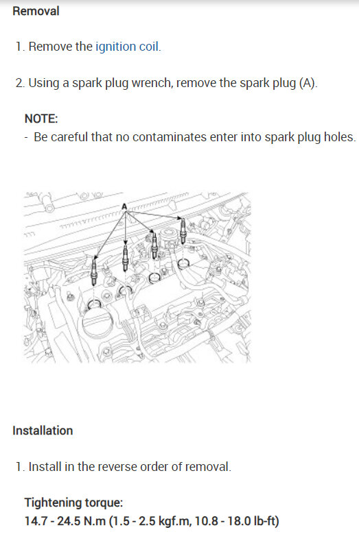

Replacing Spark Plugs - going with NGK IRIDIUM IX (don't need longevity of the Lasers)
Thought I use 3/8 socket to remove plugs but keep seeing multiple #'s.
Can someone please tell me what I need to buy? 14mm ...16mm...3/8...5/8 .. ?/16????
Completely lost.
Thanks,
Diane P
Aug 31, 2024 at 8:43 AM
  • 55,433 POSTS

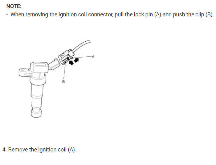

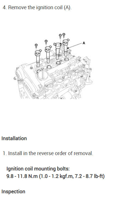

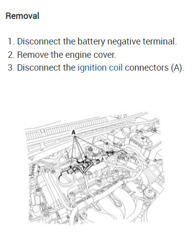

5/8-inch (16mm) Spark Plug Socket: This socket size is standard for many spark plugs, including the NGK Iridium IX that you're planning to use. Here is how the job is done correctly in the images below. I would replace the ignition coils as well and service the throttle body.
https://www.2carpros.com/articles/how-to-tune-up-a-car-engine
and
Check out the images (below). Let us know if you need anything else.
