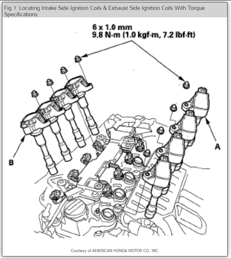

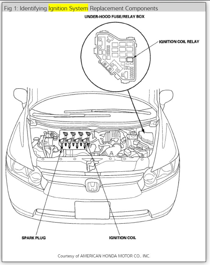

Hard to replace spark plug last one that close to windshield. How do I replace the spark plugs?

This is specific information for your car
Torque 18 Nm (13 lb-ft)
Gap 1.0 - 1.1 mm (0.039 - 0.043 in)
Many of these cars will have a special or custom tool to remove the spark plugs. It is a tight fit so hang in there.
Here are diagrams on what it will be like for your car (below)
