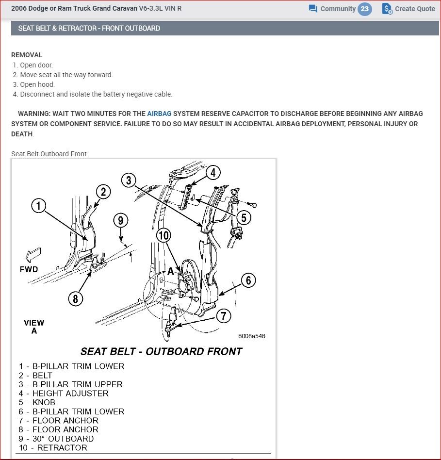

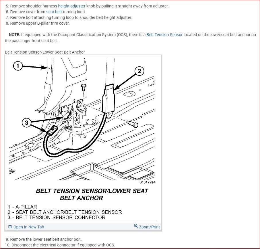

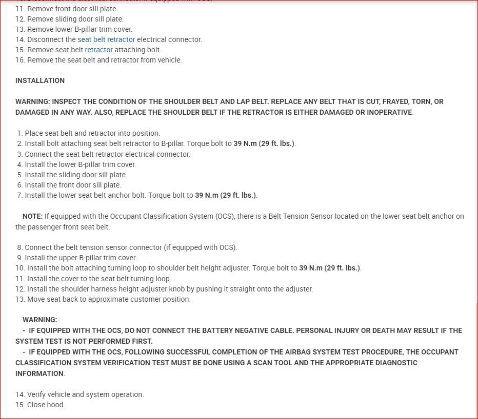

I'm removing the drivers side seat belt and replacing it with a used one in better condition. I can see that it's not going to be a straight forward ordeal so I would like any tips I can get. Will I need any special tools? Are there any fasteners I will have to replace? I don't want to have it apart and then have to run to the parts/tool shop, if ya know what I mean!
Jun 13, 2019 at 8:42 PM
  • CAR REPAIR CONTRIBUTOR
Hi JLSKEPTIC,
I provided the procedure for replacing the seat belt. It is not extremely complicated, just takes a fair amount of de-trimming so you can get to the seat belt.
However, once you get there, it is just a few bolts to actually remove the seat belt and reinstall it.
Please let me know if you need more information. Thanks
