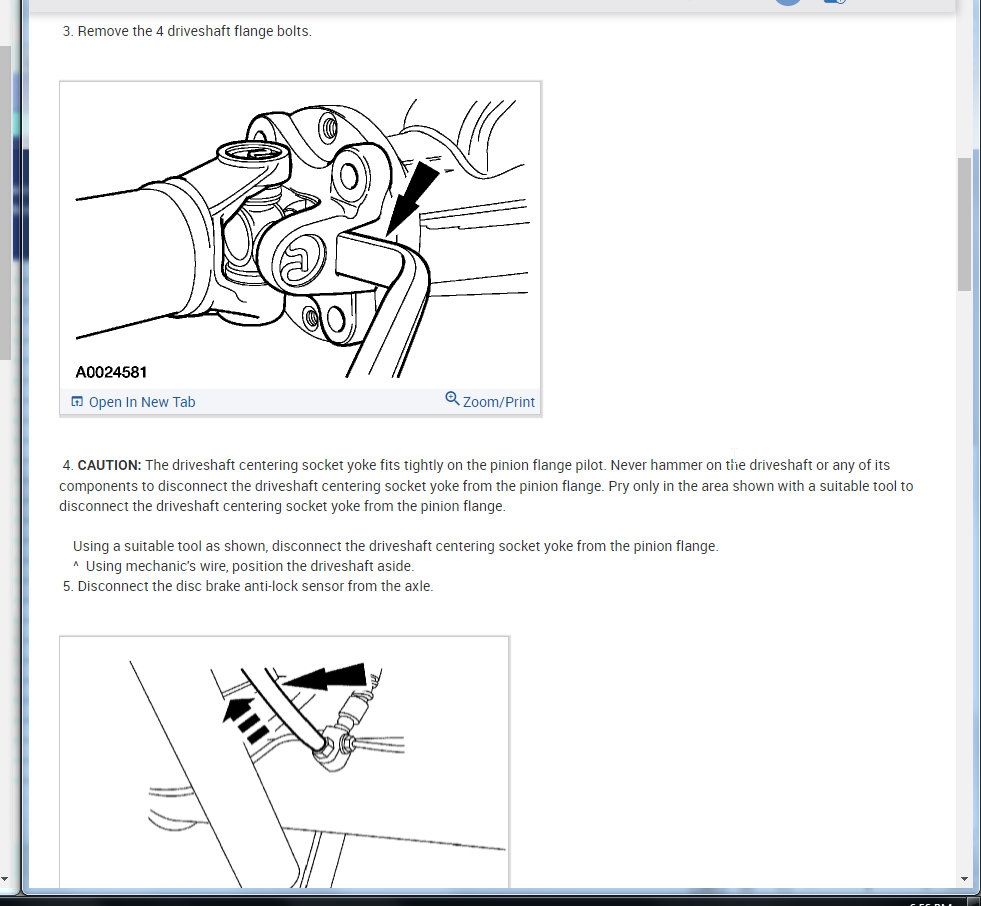

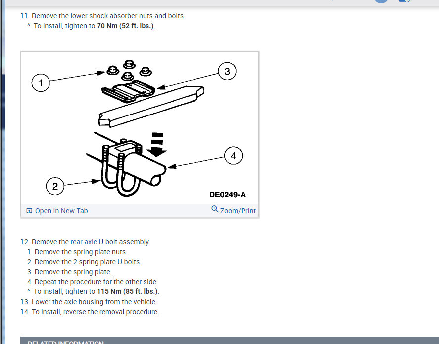

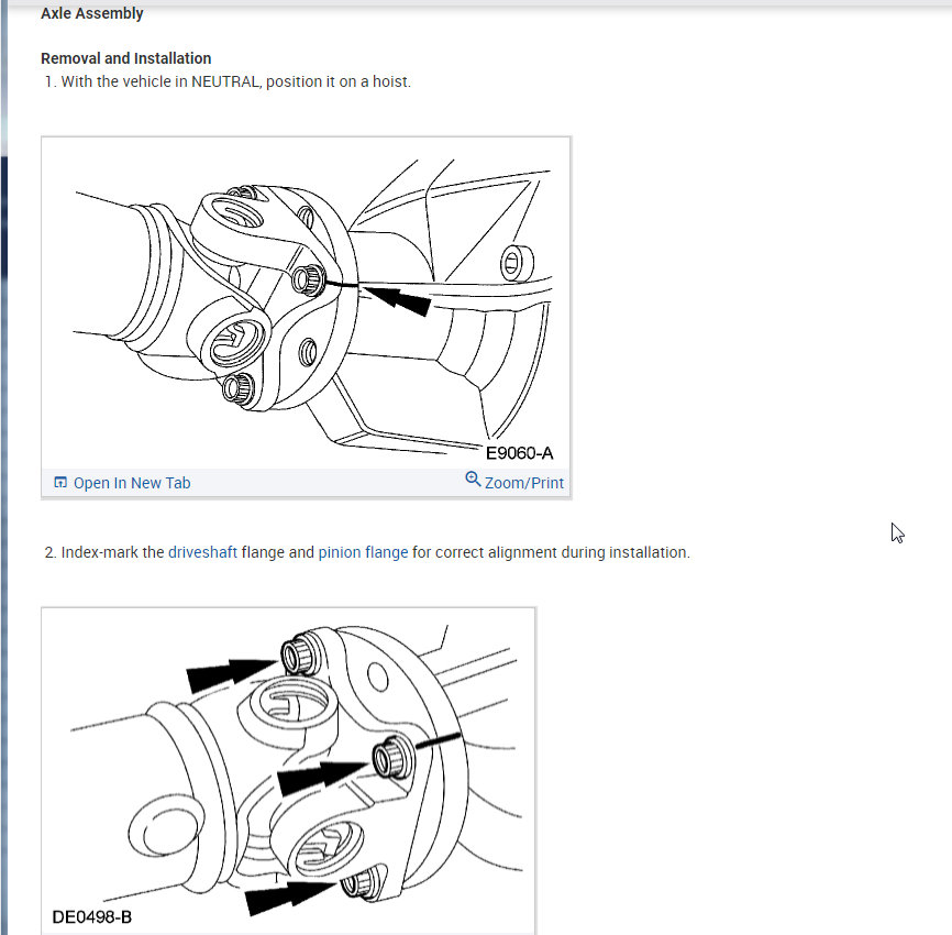

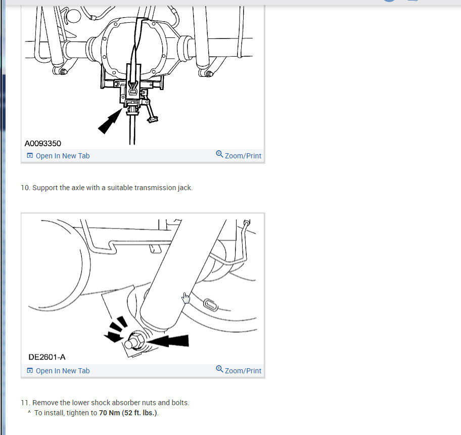

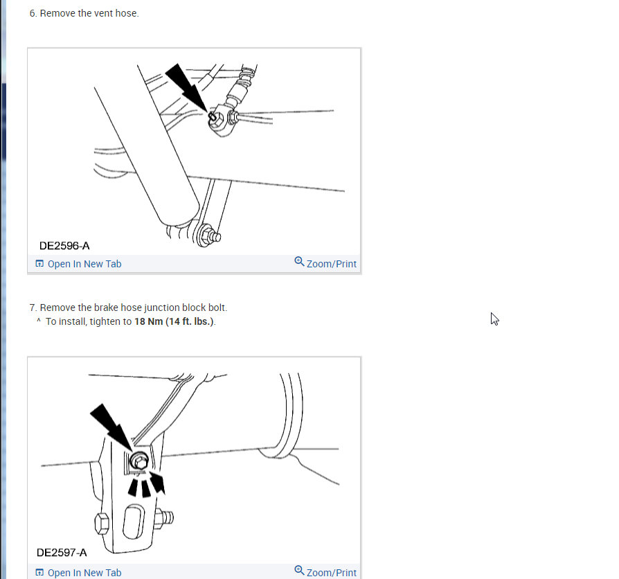

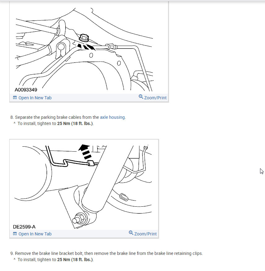

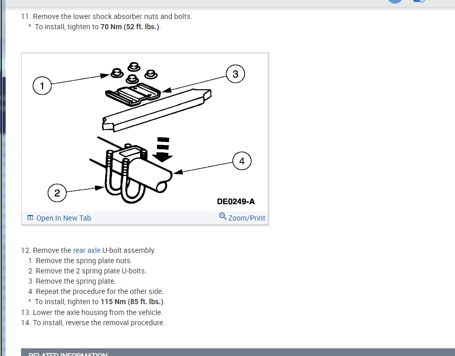

Need to replace the rear end in my F150. I need to know info on doing the job can you help me?
Wednesday, July 16th, 2014 AT 11:55 AM
MECHANIC
18,907 POSTS
This is a job that can be done in a driveway but you have to have a jack that will lower the rear end once it is loose.
I attached the process below that will help with this. Please let us know if you have other questions. Thanks
