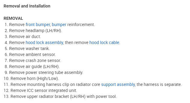

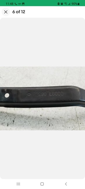

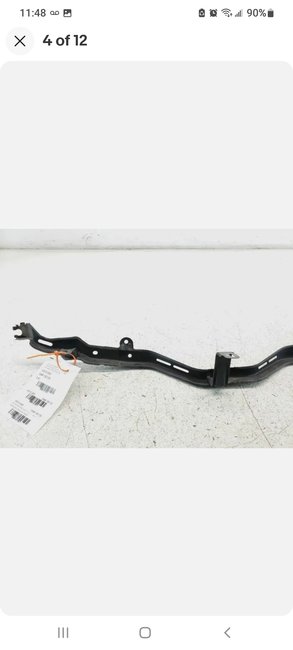

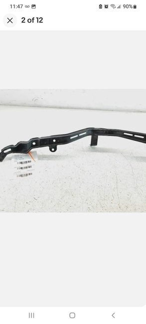

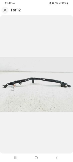

I had to replace my radiator support due to an accident. I also had to remove the radiator, the A/C condenser and the fan. When doing that i removed a bar that i believe is an upper radiator retainer tie bar, now i don't remember where the bar goes. can you please help?

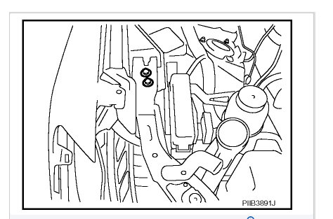

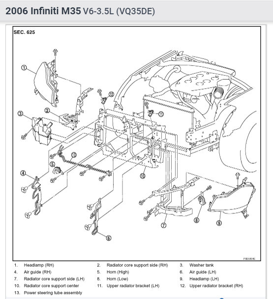

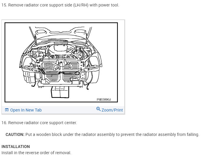

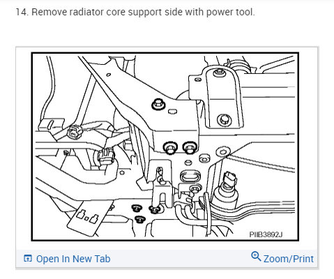

I'm not sure the exact part you are referring to, so I attached the directions for the removal and installation of the radiator core support below.
Take a look through them and let me know if they help. If they don't, take a pic of the part in question and upload it for me to see.

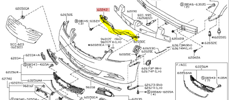

This is the bar I am trying to figure out where it goes.
Aug 15, 2022 at 1:50 AM
  • 110,240 POSTS
That is the front bumper cover upper retainer. It should bolt on each end of the body and the upper bumper cover attaches to it.
I attached the best pic I could find. Let me know if it helps.
