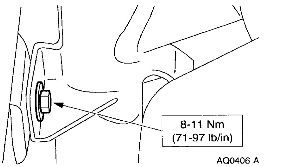

Taken off top hose, bottom house, hose to antifreeze reservoir and moved out of way, left and right 8mm upper screws, removed plate and screws left and right on top. What am I missing that it will not come out? Seems like there is something on bottom holding the radiator in, but I cannot find anything. The condenser and all the lines are intact and not connected to radiator. I took the battery and housing out to get more room but the radiator will not budge.
May 21, 2018 at 7:40 AM
Good evening.
There are bolts holding the condenser and the transmission cooler at the bottom.
I have attached a picture for you to view.
May 21, 2018 at 10:49 AM

Took apart the bottom no screws going up? I think I need more direction as to where the screw is. That picture looks like the top part of the radiator. Does the condenser also have to come out? My radiator only had water lines hooked to it. Thanks
May 22, 2018 at 3:26 AM
Can you move the upper part of the radiator back and forth?
May 22, 2018 at 4:09 AM

Yep, that is what I figured. You need to hunt down that bolt I sent a picture to you. It is down the bottom.
