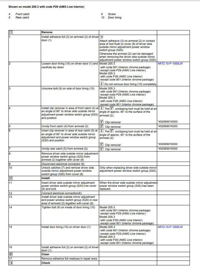

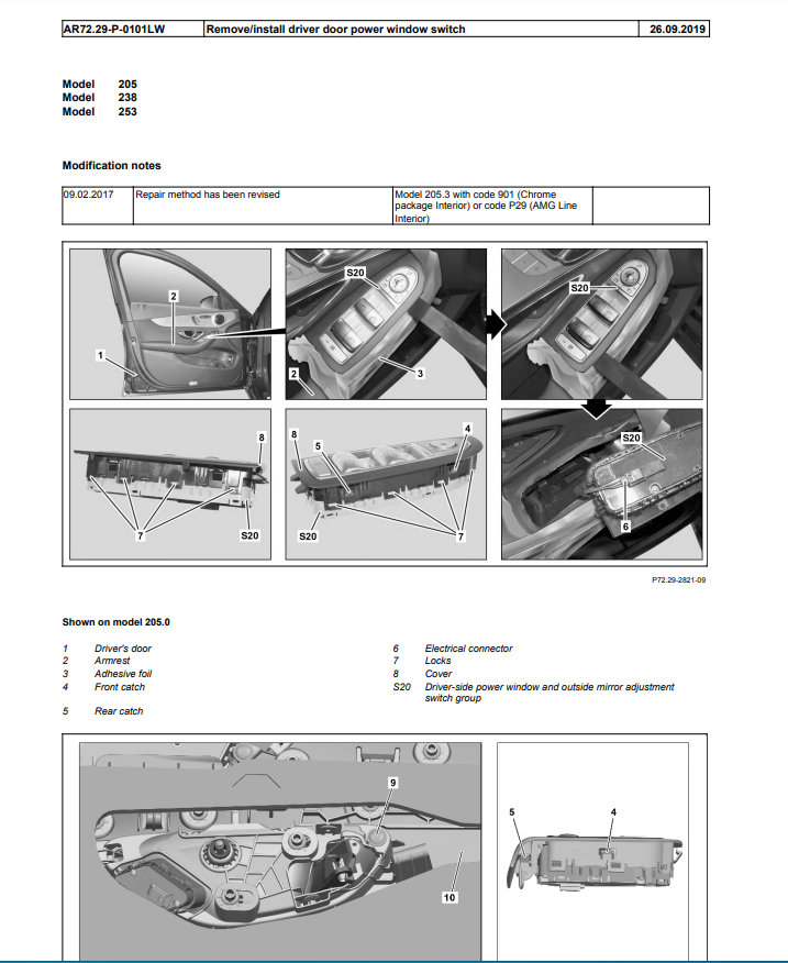

Can you find out for me if this master switch can be removed without removing the door panel? Also, the lock/unlock button.
May 7, 2022 at 4:23 PM
SQM
  • 6,383 POSTS

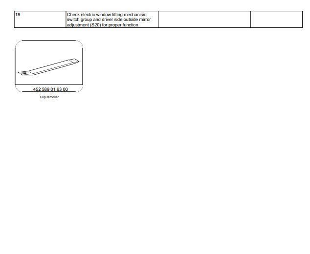

I have attached the procedure below for the switch removal. It appears that you will need to remove part of the panel in order to remove the switch.
Let me know of any questions.
