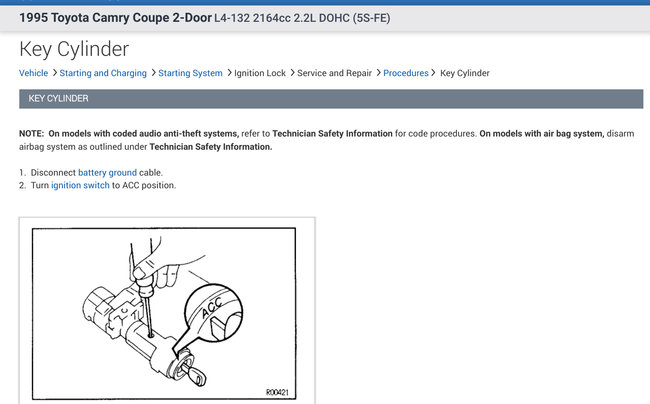

Broke key in half. Need to replace key ignition lock. No idea how.

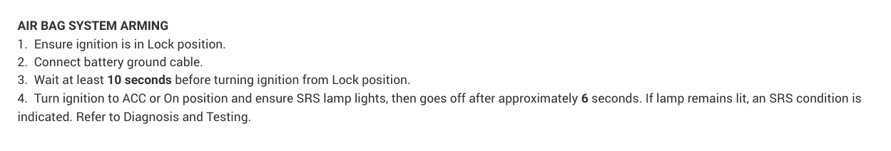

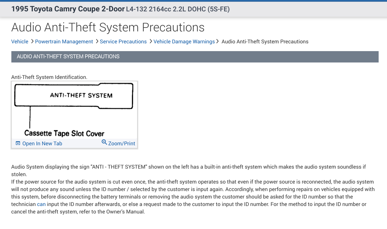

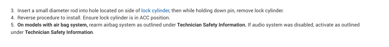

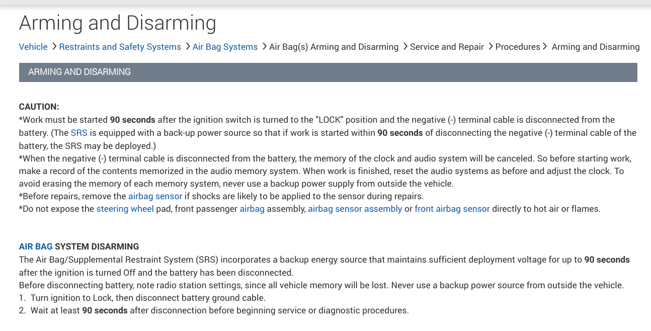

Have you tried extracting the half of the key with a pair of tweezers or a good magnet just stuck the key? Anyway, in the diagrams down below I have included the instructions for the removal and installation of the ignition lock cylinder for your vehicle, including the instructions for the disarming and arming of your vehicle's air bags and coded audio anti theft. Please go through these guides and get back to us with how everything turns out. I hope this helps and Happy Holidays.
