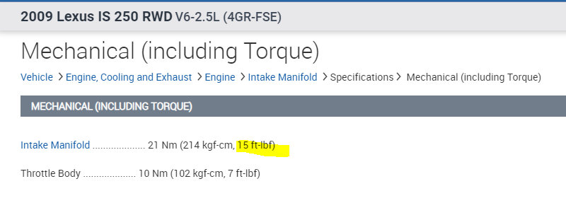

Can I get the torque specs for aluminum plenum to heads, and upper plastic intake runner?
80,000 MILES • 2.5L • V6 • 2WD • AUTOMATIC
ROBERT JENSEN

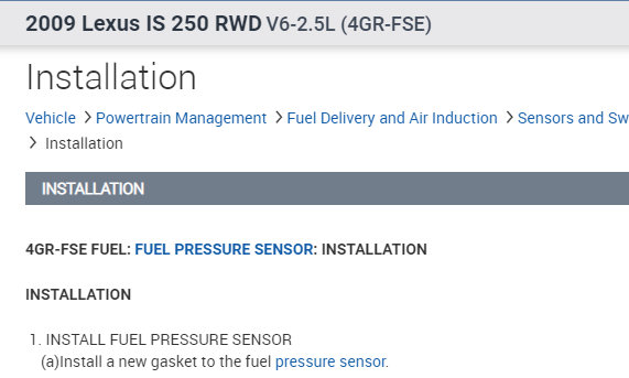

Replacing fuel pressure sensor under intake.
Aug 3, 2022 at 8:49 AM
  • 110,248 POSTS
The intake was easy to find the specs for, but I'm struggling with the runner. I looked through three manuals and none provided that info. What is it that you are actually removing? Is it the swirl valve?

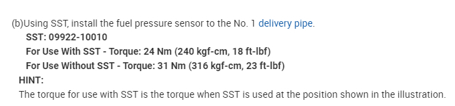

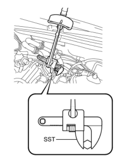

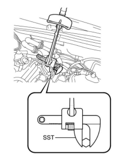

I was able to find the specs and directions for torquing the pressure sensor. See attached pics below.
