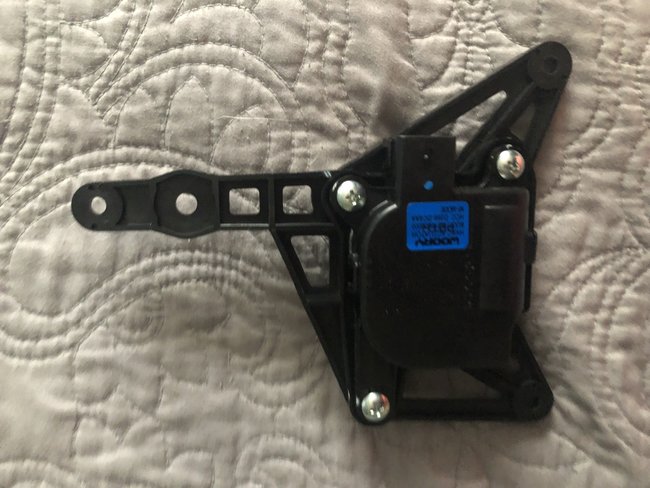

New HVAC actuator (the issue is hard to get back on) I took old one off, it fits in this round pancake looking thing pics below, but for the life of me I cannot get it back the way it came off. Is there a trick to lining it up? Do I need to remove the dash parts for better access? Oh, mercy it’s cramped and hot and I’m so beside myself trying to get this thing lined up for the three screws on the housing. Tell me there’s a solution.

Is that the air-temperature actuator? If it is, connect the actuator and by changing the temperature requested, it should allow you to align it.
If I recall (this is from memory), the new actuator is set for everything off as far as temperature. I'm not sure what the original one was set at when it failed.
Try that and let me know if it helps. Also, hang in there. I agree the heat was crazy today. LOL

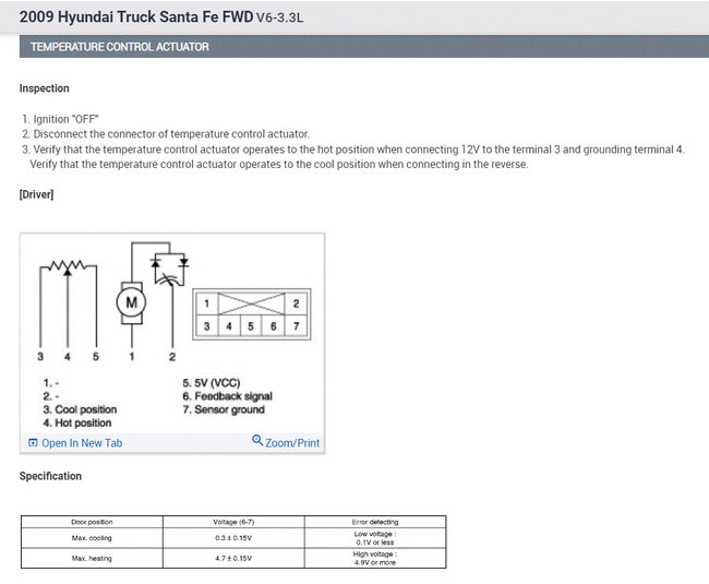

If everything were tight and in good condition, there could be a voltage issue to the actuator itself. The actuator receives voltage from the controller. Based on the request, different voltages are sent to the actuator for cooling. That is how the actuator knows how far to open. When you want heat, the polarity is switched to the actuator which causes the motor to turn in the opposite direction. How much of a difference is there between the two sides?
If you want to check the voltage signal, I attached the directions below. Note that you will be checking voltage to the actuator and not from the actuator.
The specs are at the bottom of the pic.
Let me know if you have questions or what you find.
See pic below.

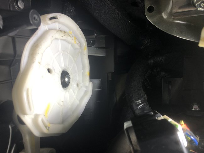

At this point, what I suggest is this. Remove the new actuator. With it plugged in, see if it responds when you change the temperature request. If it does, turn the blend air door manually to see if you get cold air on the driver's side.

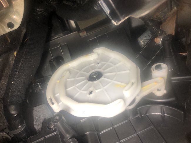

Are you saying this pic below is the thing I need to manually turn after I remove the actuator but leave it plugged up? The thing is it has the 2 holes where the actuator housing fits and it won’t line up but 1 way - I manually turned it every way but inside out lol trying to get the new actuator with the housing to fit ( it only fits if it’s turned a certain way and that’s how I got it back in … are we sure the passenger side actuator isn’t a problem even though it cools much cooler than the driver's side (is this drivers side more the “ mode “ actuator than a blender ?
Jun 27, 2022 at 1:36 PM
  • 110,248 POSTS
Yes, that is what will turn. As far as the actuator, it is a blend air door actuator. When you have dual climate control, each side has its own actuator.

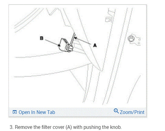

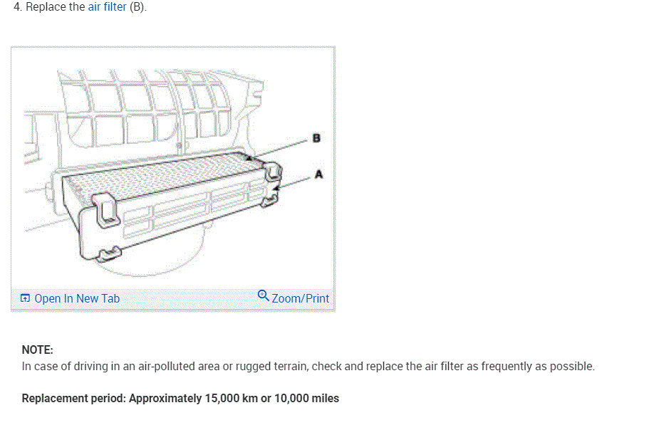

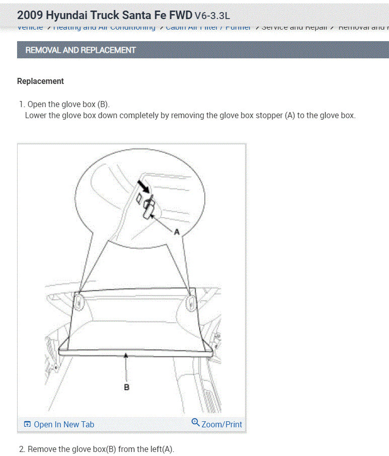

Have you ever replaced the cabin air filter? If it's really dirty, it can cause air restrictions? Also, when you noticed the change in air flow, are you sure it wasn't changing air flow direction?
If you never replaced the cabin air filter, I would suggest removing it and inspecting it. It is located right behind the glove box.
I attached the directions for replacing it below.
Jun 28, 2022 at 6:52 AM

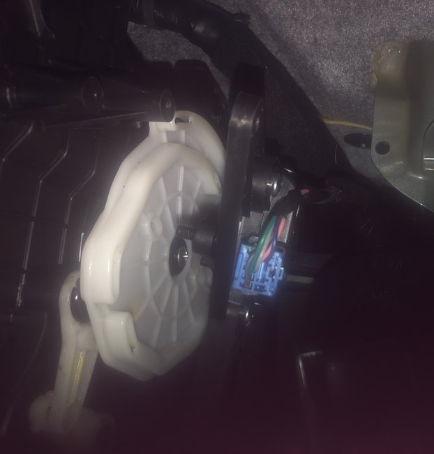

I’m hooked the housing but not the plug after turning car on A/C on the white thing does not move.
Jul 1, 2022 at 2:01 AM
  • 110,248 POSTS
The tick you heard was likely one of the actuators. As far as the pic above, the white thing is turned by the actuator. If you checked it while it was disconnected, it won't move. You have to watch the motor itself to see if it is moving.

I took the housing off the white thing but did not unplug. The white thing did not move after turning on key /AC. I put housing with motor back on white thing and check fuses again / o return on car and A/C and it did not move. But it definitely controls the defrost and under dash air flow on drivers' side because when it was white thing it did not have defrost or under dash air. Maybe that’s all it does. Maybe my issue is with the passenger side actuator, maybe it controls temperature as well for both sides. it’s definitely been a mystery.
Jul 6, 2022 at 11:22 PM
  • 110,248 POSTS
The white thing is what the actuator turns. With the actuator removed, can you manually turn the white thing to change air flow?

Yes, I can manually turn the white thing because I had to turn it to beagle to put the actuator housing on it lined up. I’m not sure if turning it affects the air flow (I know the white thing did not move while the motor housing was still plugged in but not bolted onto the white thing. After I re-bolted the housing and motor back to the white thing then I had the defrost and under dash air and I have always had vent air regardless of any of this. That’s why I think that might be all it does. I’m going to try the passenger side actuator at some point this weekend (it’s very rainy and hot where I am but it’s easier to get to). So we will see.
Jul 7, 2022 at 7:15 AM
  • 110,248 POSTS
Do me a favor. This is going to sound crazy, but with the actuator removed, move the white thing to see if you are getting all air flow directions.
Now, I need confirmation. Are we focused on the air temperature or the air flow direction? I'm getting confused. LOL They are two different actuators. What you show me in pics is the air temperature actuator, but you mentioned it now changes from floor to defrost. I just need to refocus myself. LOL

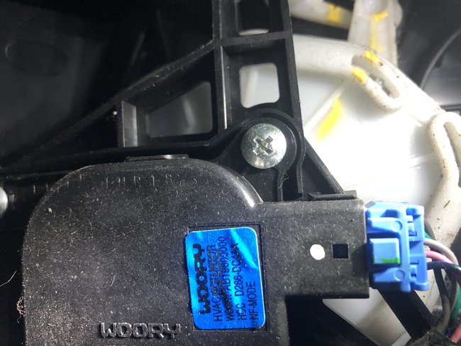

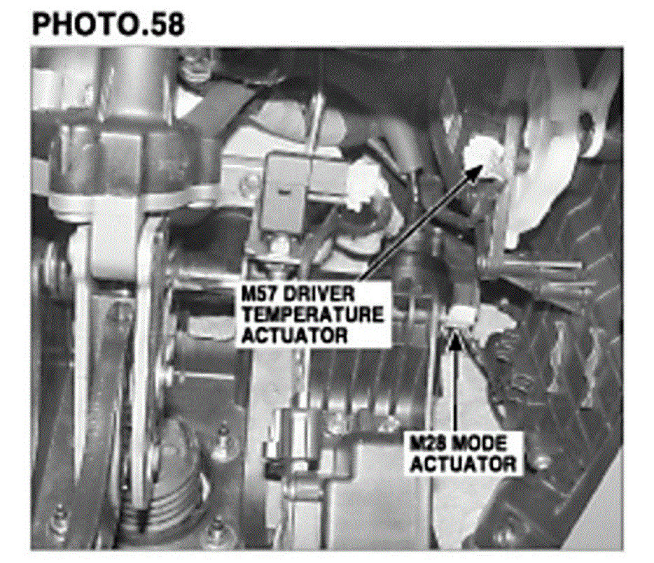

Okay, then the actuator you are working with is the mode door actuator. That doesn't control the air temp. Have you replaced the blend door actuator?

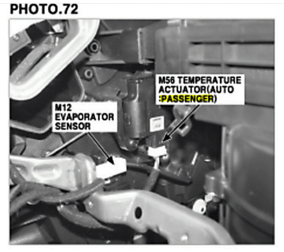

There are two temperature actuators. The passenger temperature actuator is on the right side and driver's is on the left, right above the mode actuator.

Guess I will have to look under the driver’s dash again, all I see is the actuator that’s connected to the white pancake thing. so, that makes two under the drivers? You kind of lost me, some diagrams don’t work. Because they may not be for. My Hyundai 09 - it’s been a headache trying to find the correct actuator. Okay, so, what if the new actuator motor isn’t making the pancake thing turn? In one of our talks you said the motor on the housing that bolts onto the white pancake is supposed to move so that it controls the air, that’s when I said with it plugged up but not connected to the pancake thing I have no defrost no under dash air of any kind but when I put it back on the pancake and screw it done. I then have defrost air and under dash. Not sure that’s controlling the temperature? Should I try the passenger to see what’s up with it?
Jul 8, 2022 at 12:44 AM
  • 110,248 POSTS
You are correct. It sounds like it's the mode door you are working with. That is what changes the airflow direction and not the air temperature.

Well, according to your pictures the white thing with the actuator is what I been trying to get to work, obviously it works for the air flow of defrost and under dash air flow only. So, where is the blend door actuator?
Jul 8, 2022 at 1:27 PM
  • 110,248 POSTS
Interestingly, the pic shows that is it. But I have a feeling they made a mistake in the pic. In the pic I sent, they identify the mode actuator. Maybe that is the one for temperature. Is there one in your vehicle like that?
