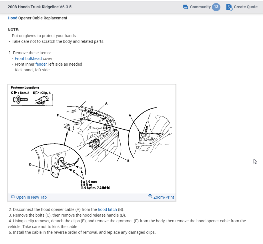

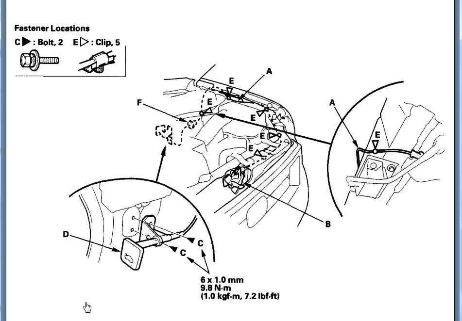

I understand this is usually an easy one on a Honda, but want to make sure there aren't any steps I needed to take while replacing it. Thanks
Aug 13, 2020 at 12:50 AM
You are correct. This one is not that complicated. I attached the info below. Thanks again. Check out the diagrams (Below). Please let us know if you need anything else to get the problem fixed.
