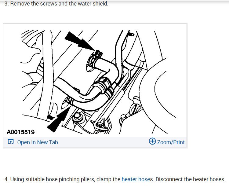

To be clear you need the heater hoses to be replaced not he heater core, correct? There is a big difference FYI.
Here is a repair guide to help you step by step for the heat hoses:
https://www.2carpros.com/articles/replace-heater-hoses
Check out the images (below).

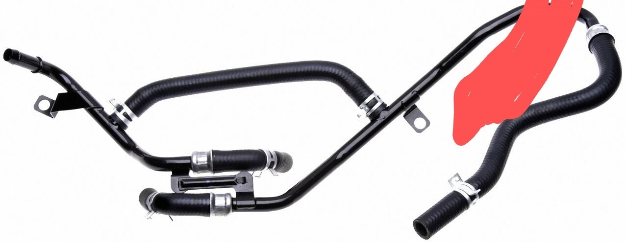

Correct, I replaced the heater core around a year ago. But recently a leak developed on one of the hoses calling out of the heater core so I'm replacing the heater core hose assembly. On the driver's side the hose runs behind something that looks almost like a leaf blower attachment. It's black plastic, how do I remove that? My very crude drawing shows the location.

So you see the regular hose clamps and the crimp style of hose clamp? These you can't replace. I have seen people use a hack saw and cut them off and use regulator hose clamps, but it can be a little difficult. Other than that, you can use regular heater hose and a hose tee to help build your own if you can find a replacement.
