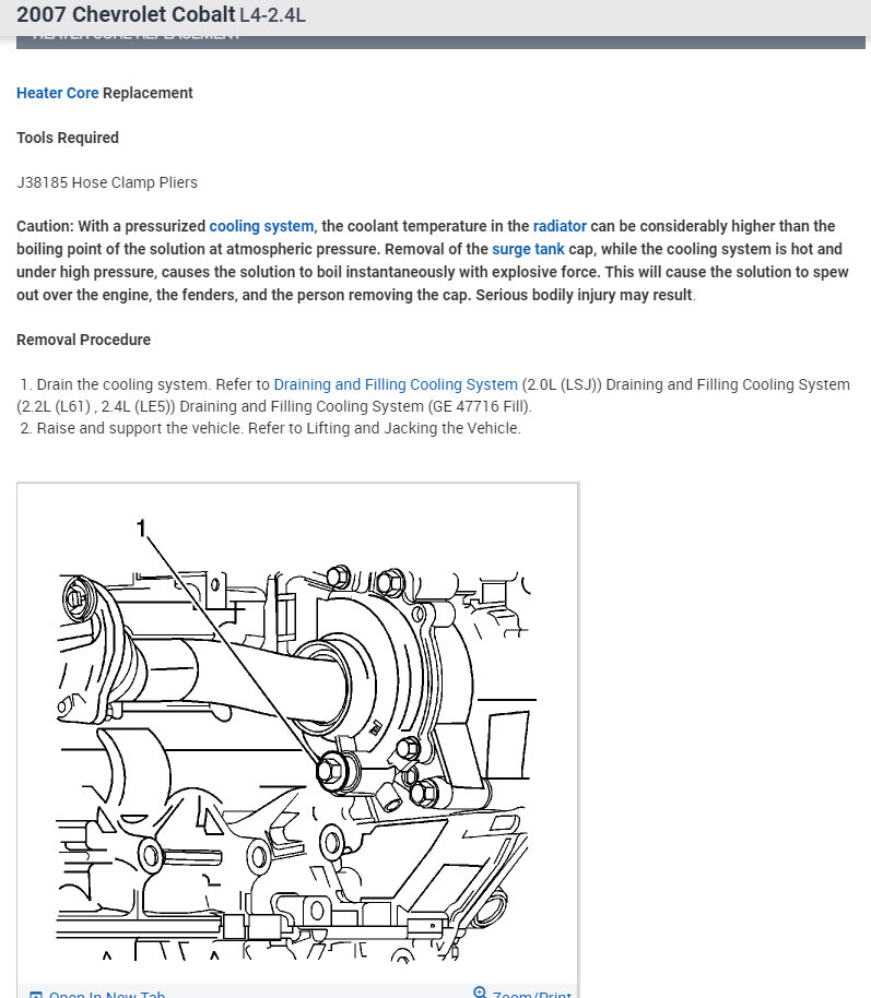

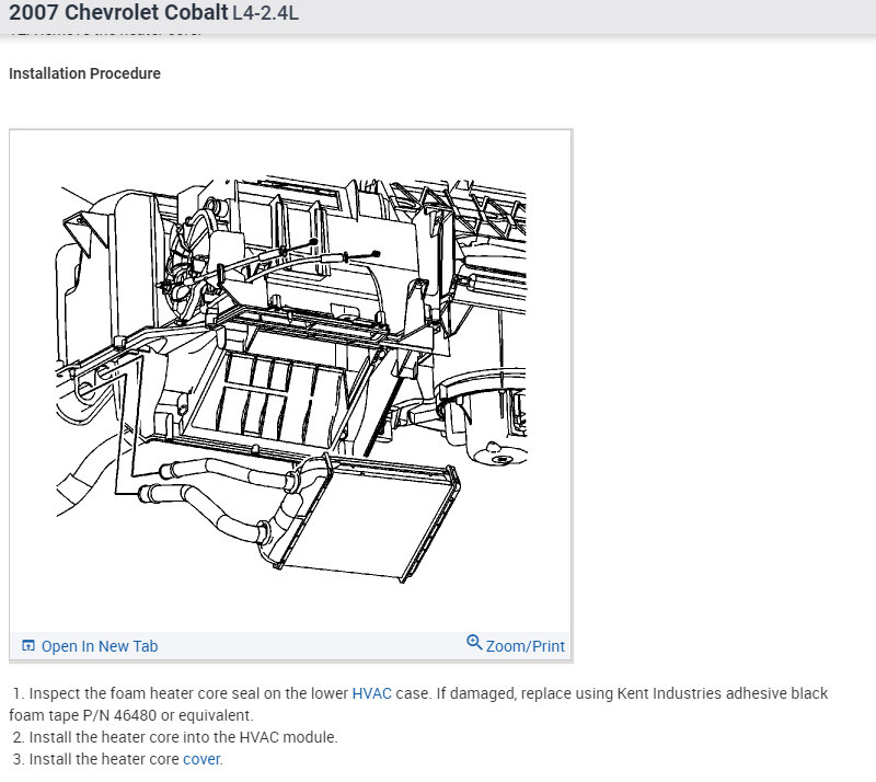

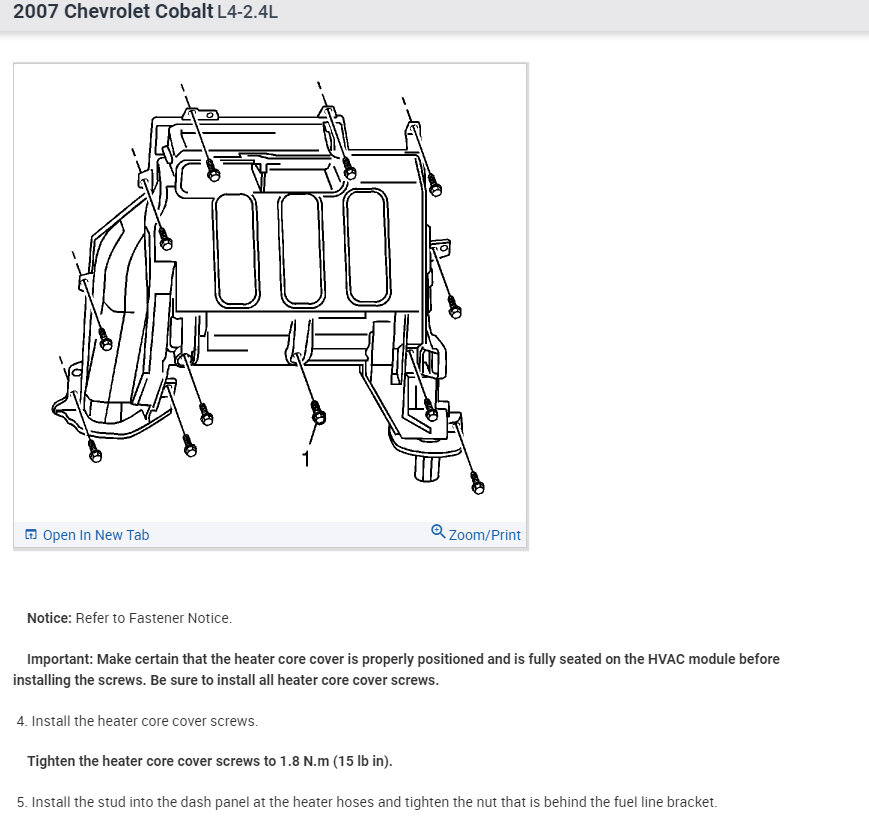

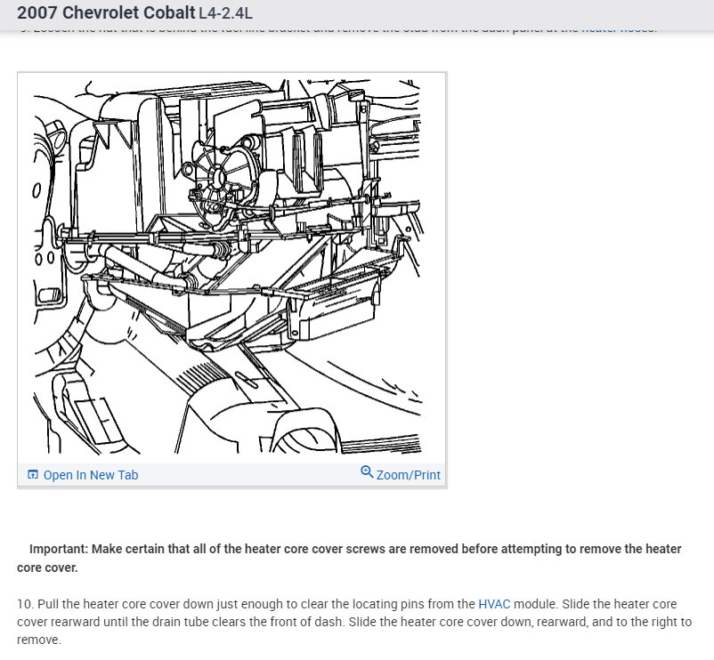

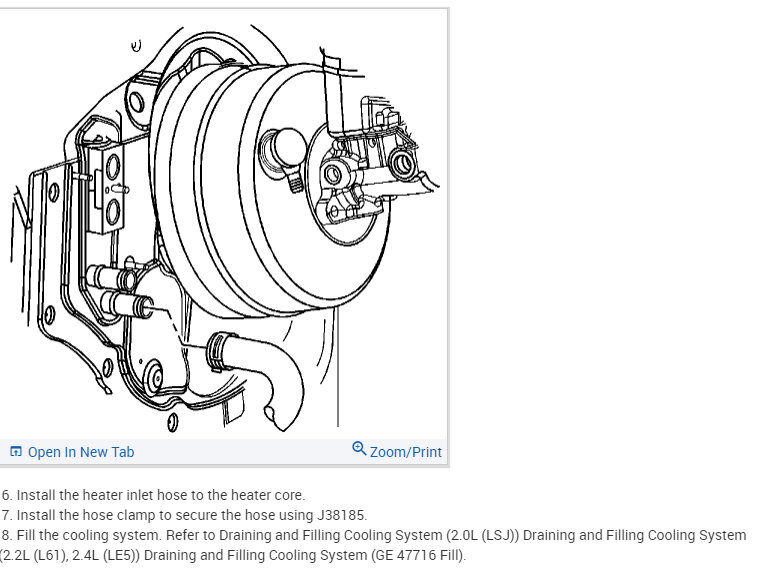

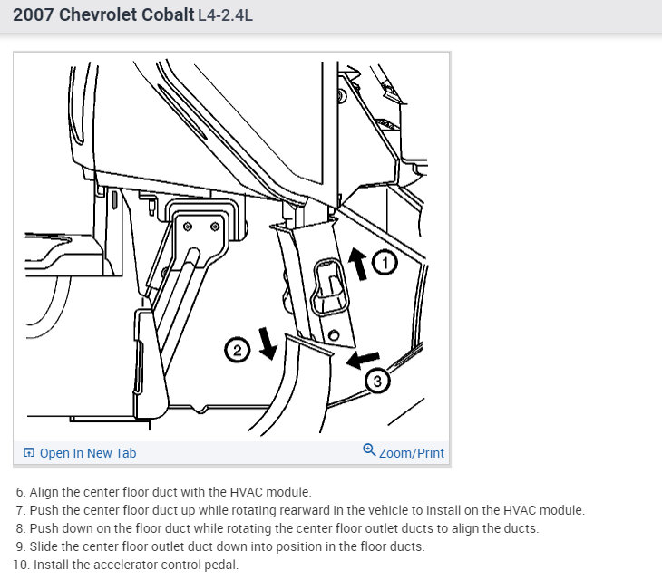

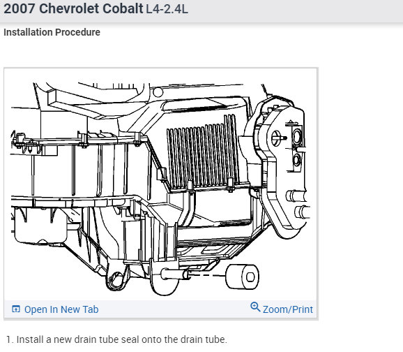

I have taken the whole dash off to replace heater core, but I am unable to get to the old one off. Please help.
Nov 29, 2022 at 6:11 AM
SQM
Experienced Mechanic
6,383 POSTS

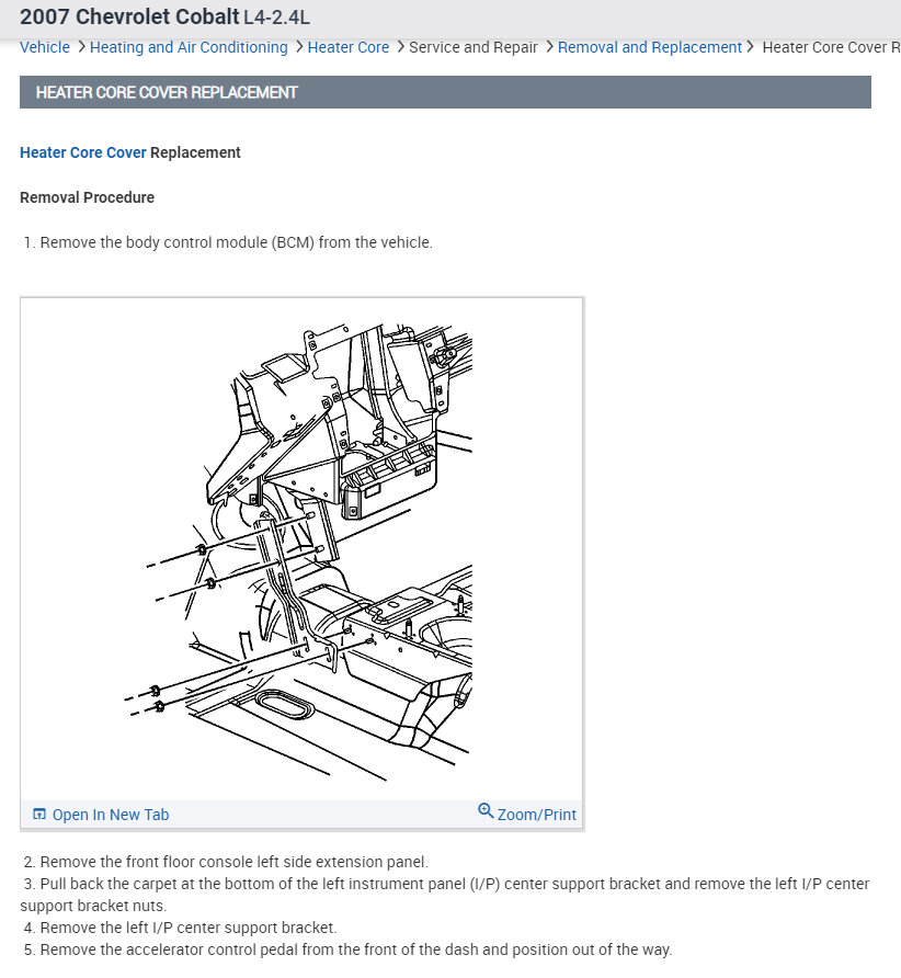

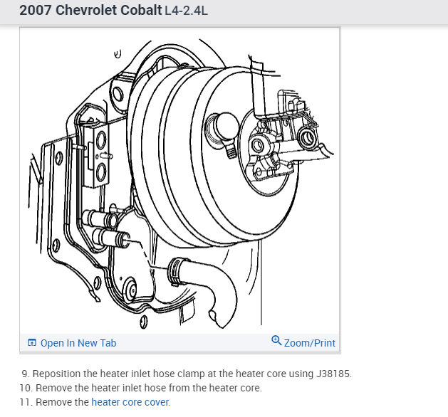

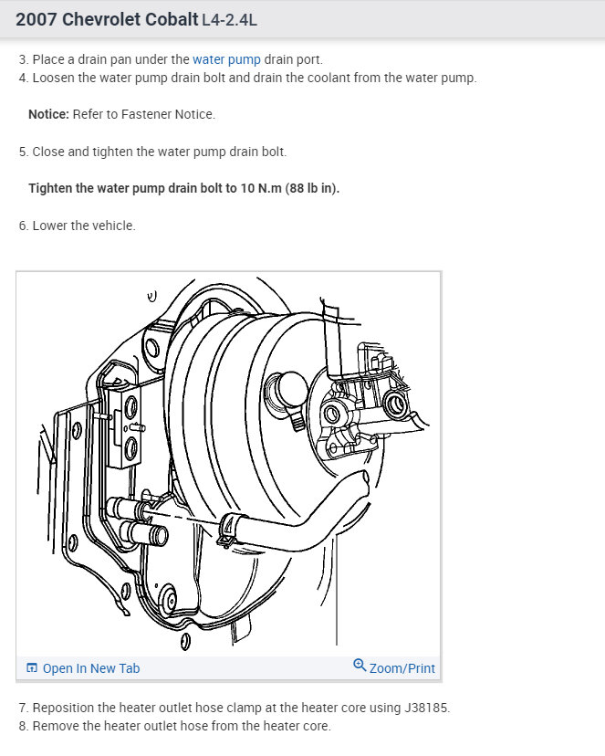

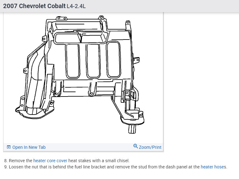

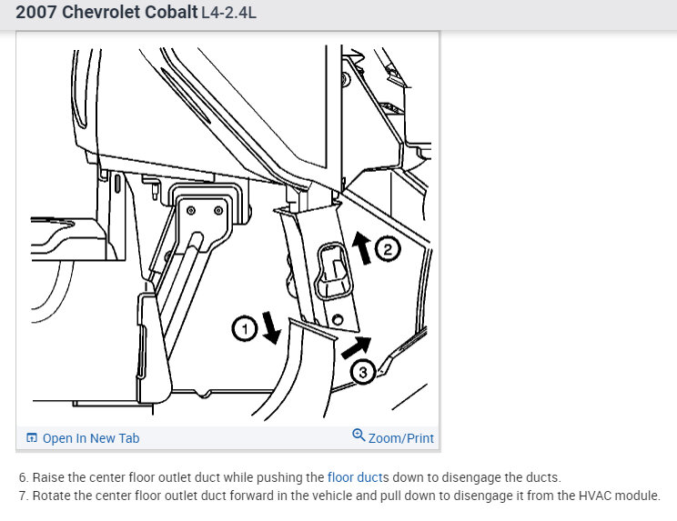

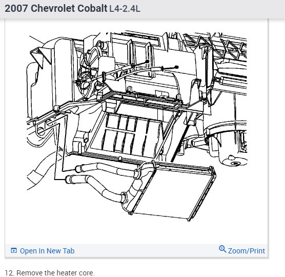

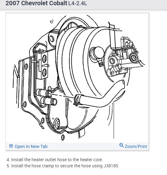

There is no special trick to get the heater core out on this vehicle. You got the hard part done of removing the dash.
Take a look at the heater core replacement procedure below. See if you might have missed something.
Let me know of any questions.
https://www.2carpros.com/articles/replace-heater-core

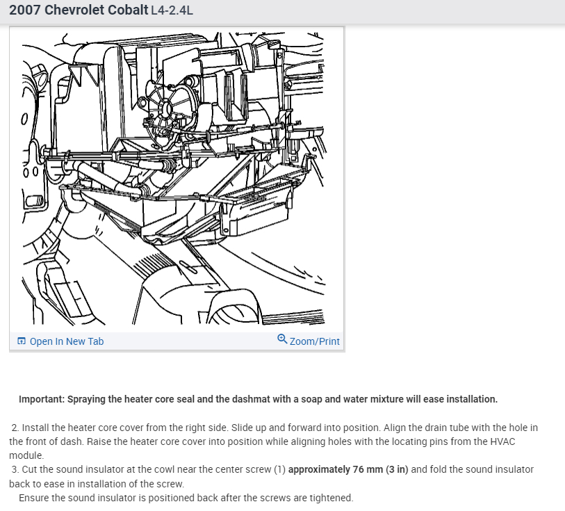

I am struggling to get a black plastic casing out of the way of the old heater core to get access to it.
Nov 30, 2022 at 3:50 AM
SQM
6,383 POSTS

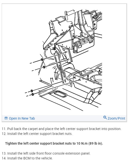

Were you able to get to all the fasteners that is holding it in place? The top ones can be tricky to get to.
Nov 30, 2022 at 9:07 PM
JCMARIE333
MEMBER
3 POSTS
Got it! Thanks. Now just have to put dash back on and together.
Nov 30, 2022 at 9:34 PM
SQM
6,383 POSTS
Awesome! Glad you got it!
