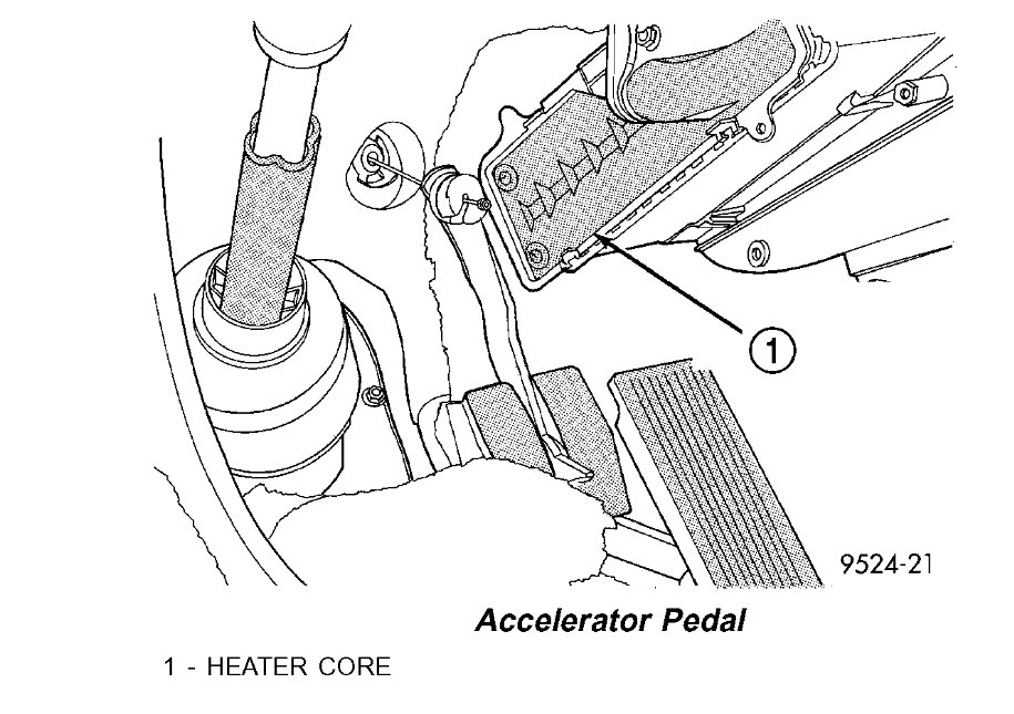

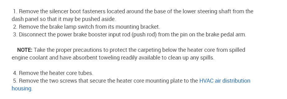

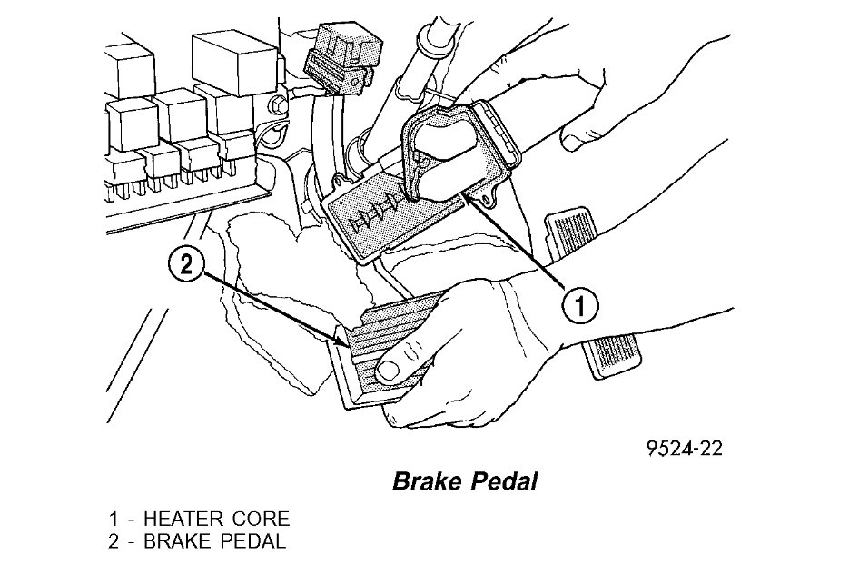

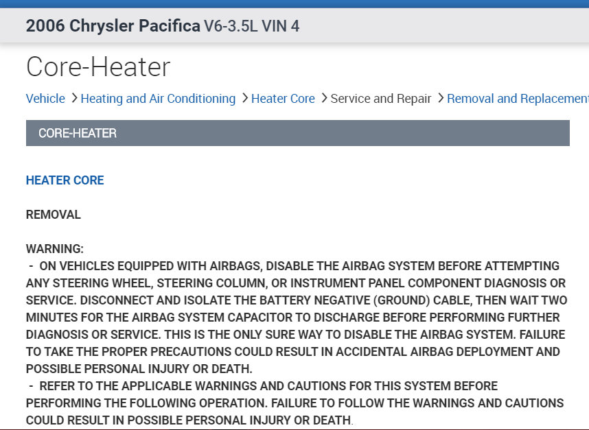

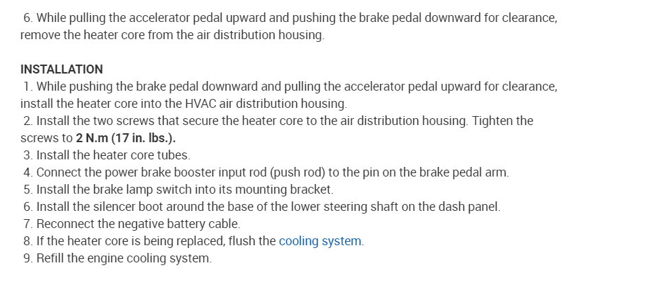

How do I remove the steering column boot, so I can get the heater core out? I took out two bolts, but it seems like it has something holding it in place that I can't see.
Nov 22, 2019 at 11:22 PM
SCGRANTURISMO
  • 4,897 POSTS
As far as replacing heater core's go, your vehicle is pretty straight forward and simple compared to most other vehicles. I have included the instructions from the vehicle manufacturer on how to change your vehicle's heater core. Please go through this guide and get back to us with how everything turns out.
