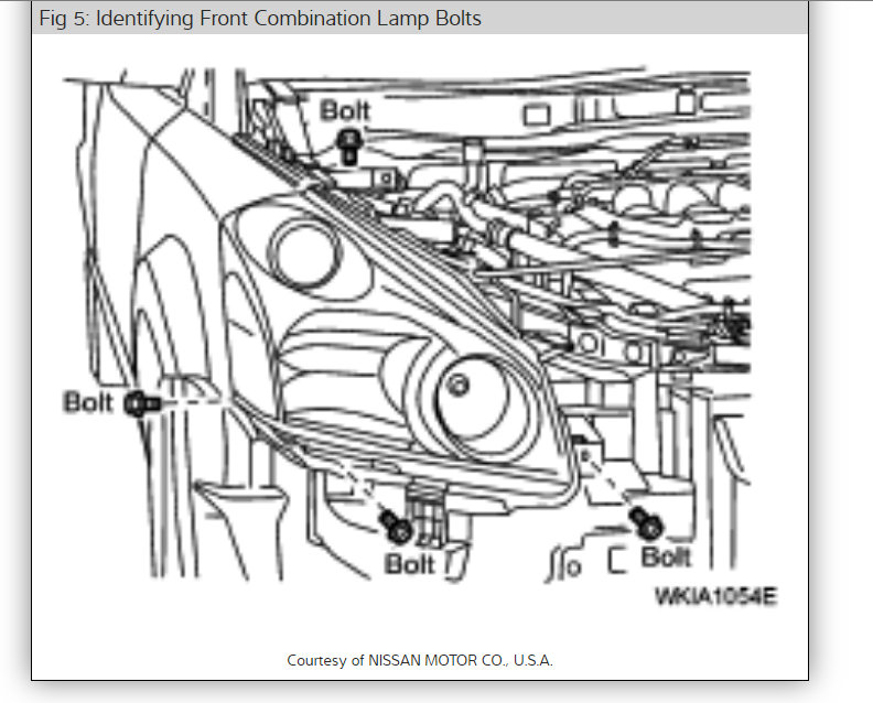

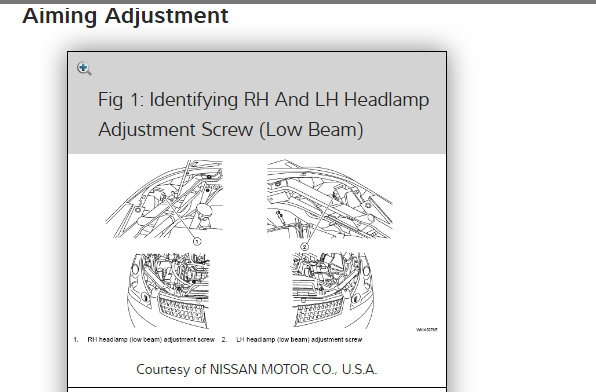

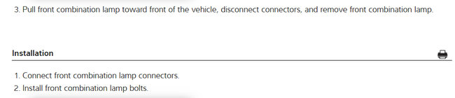

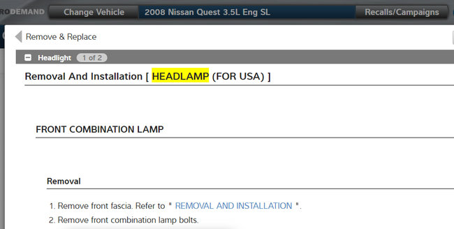

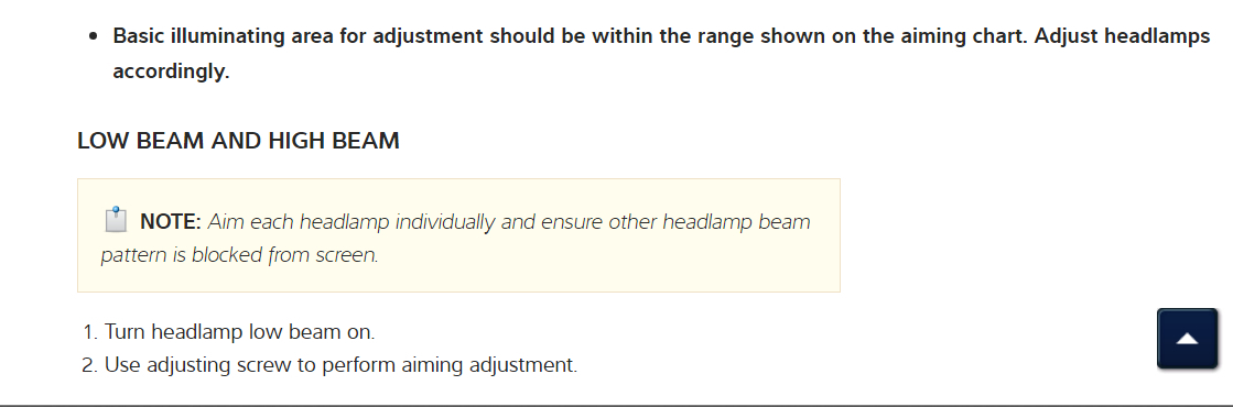

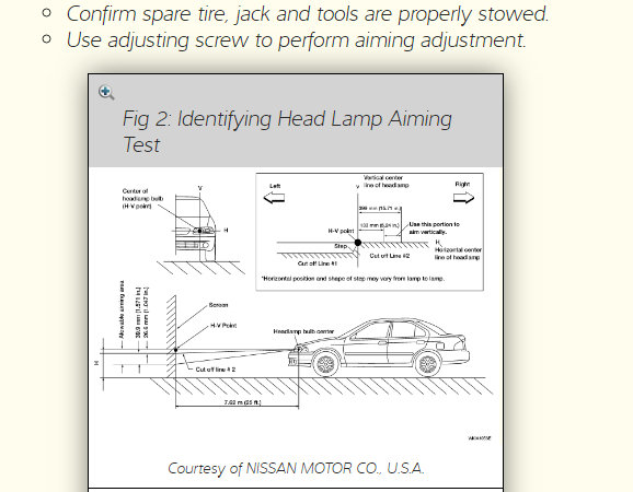

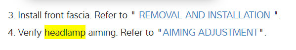

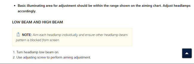

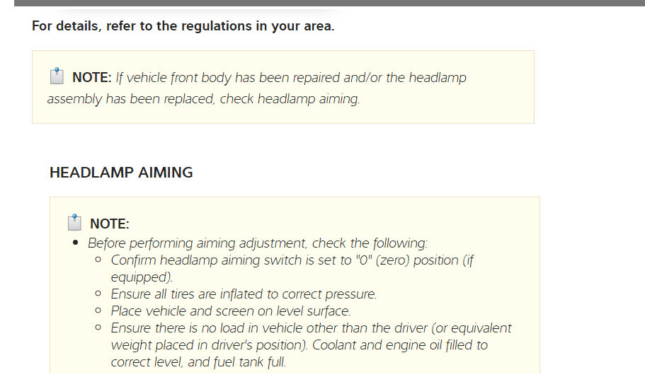

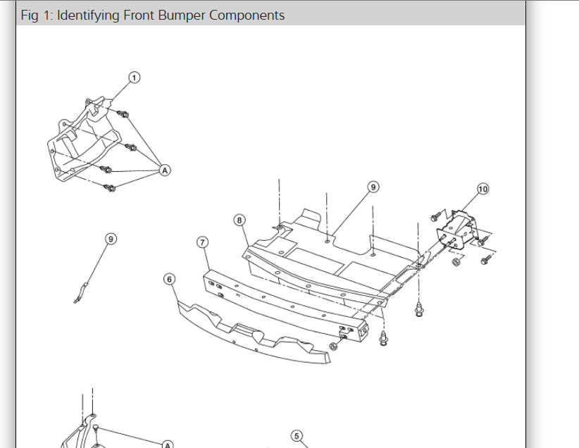

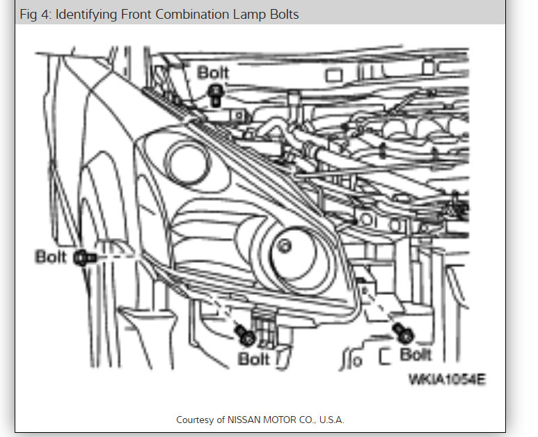

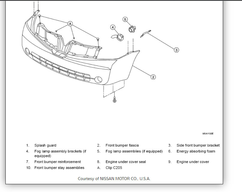

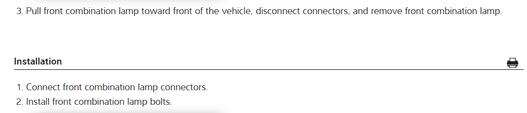

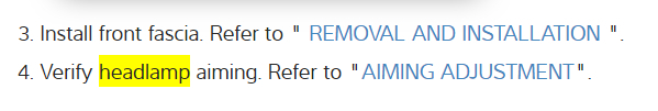

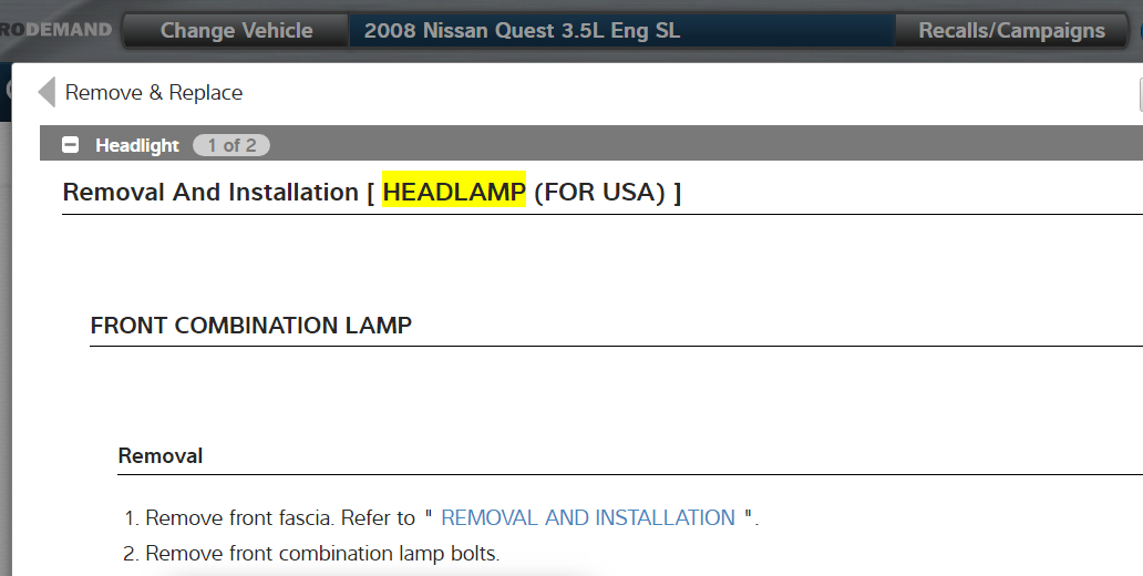

How do you remove the old headlight assembly (very cloudy) and replace with a replacement part?
Aug 16, 2019 at 11:12 AM
SCGRANTURISMO
  • 4,897 POSTS
I have included the information that you requested for your vehicle in the diagrams down below. Please go through this guide and get back to us with what you are able to find out, or how things turn out.
Thanks,
Alex
